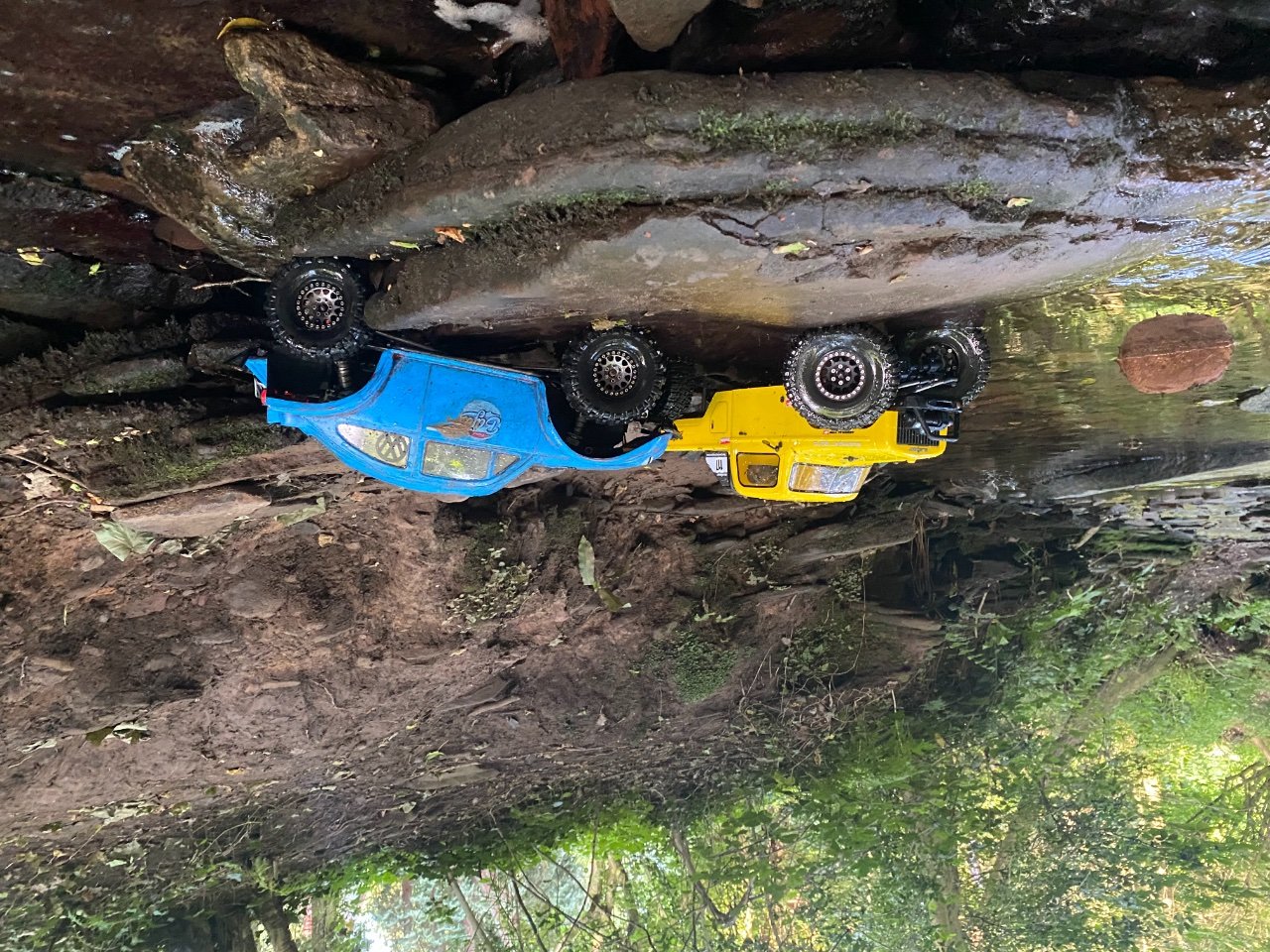

Well I did say it was light😄 my bad, must’ve took pic with phone wrong way round👎
