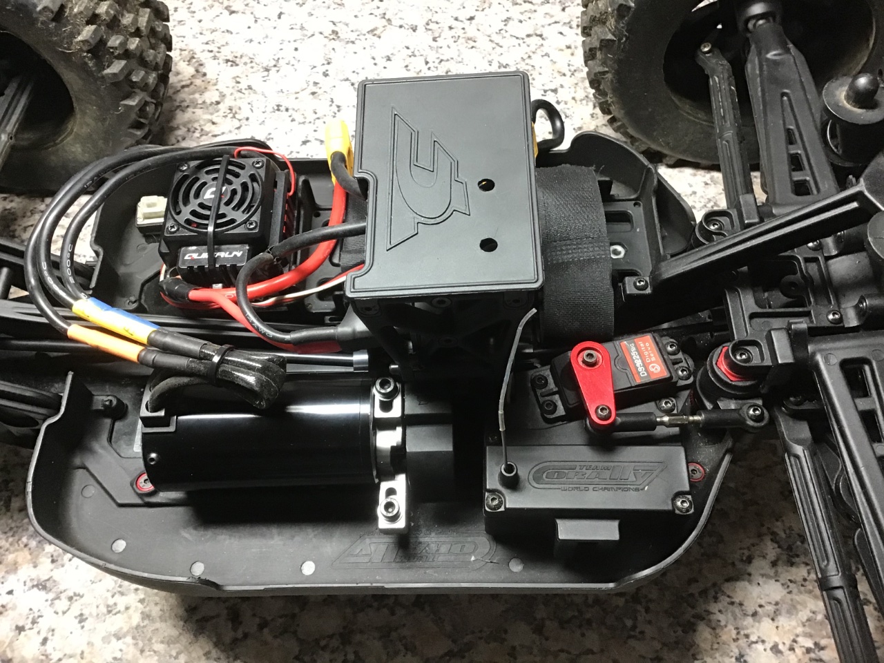

Popular Post tomr Posted May 6, 2021 Popular Post Share Posted May 6, 2021 Electrics back in and ready to rock for Saturday morning 😁 4 Quote Link to comment Share on other sites More sharing options...

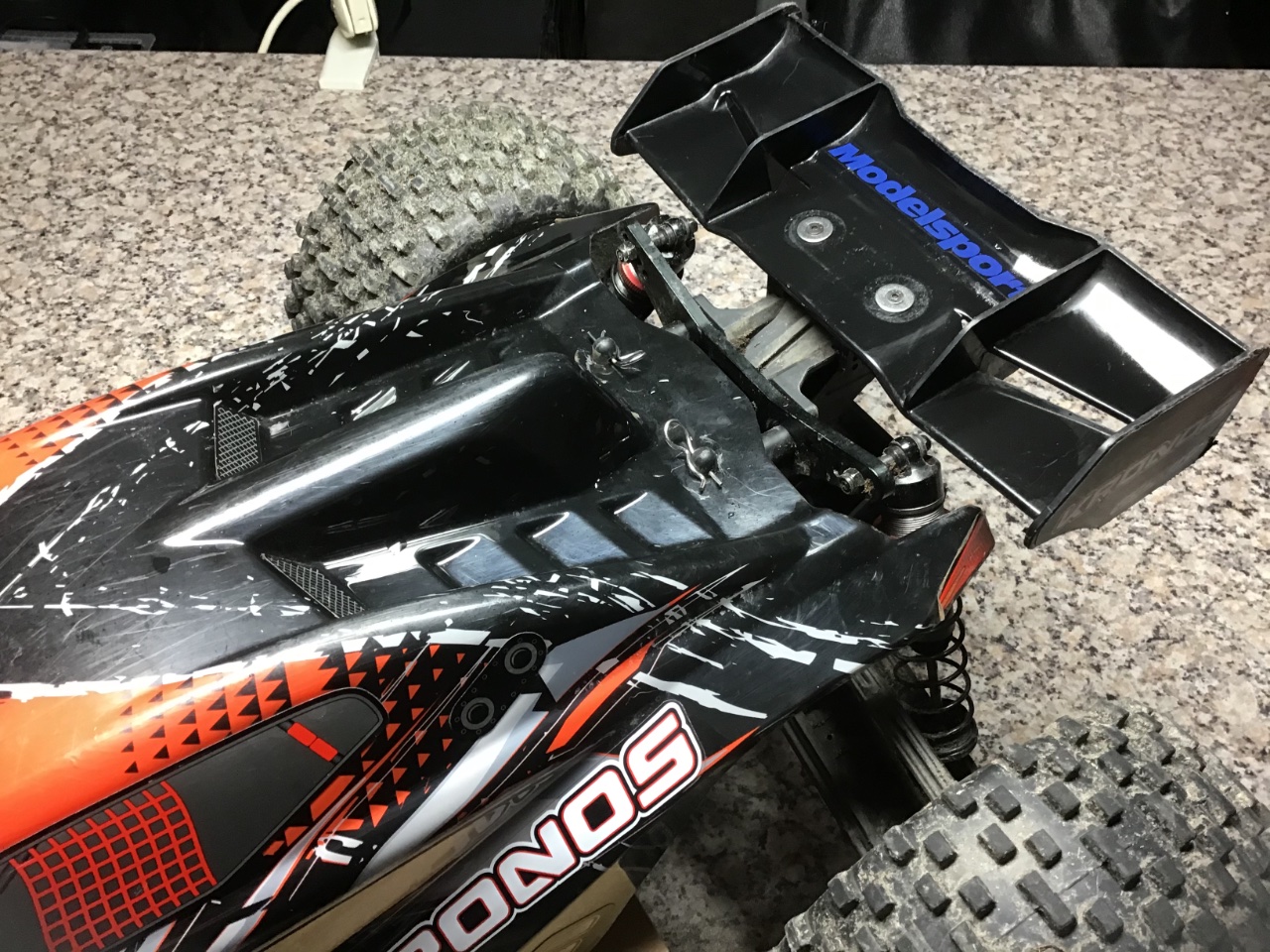

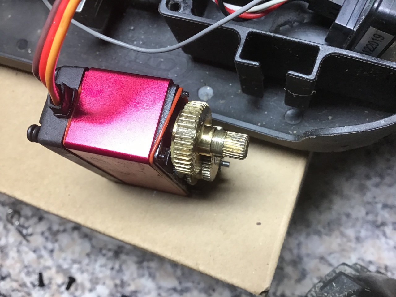

tomr Posted May 8, 2021 Share Posted May 8, 2021 Had a blast with the Kronos 😁 ran it on 6s with 11t pinion, maybe still a tad over geared, crazy top end . Think I’ll stick a 10t in . Wing washers pulled through the bolts, pretty standard for anything with a wing 😬 fitted a couple of steel washers , if it goes again I’ll order the wheelie bar . Also stripped a tooth from two of the steering servo gears which stopped play, possibly my fault running the saver too tight . Managed to rotate the damaged gears 180* so it’s good to go again in the morning 👍 Ordered a couple of JX eco boost 35kg servos 2 Quote Link to comment Share on other sites More sharing options...
Stormbringer Posted May 8, 2021 Share Posted May 8, 2021 CML have these mate aluminium wing washers https://www.cmldistribution.co.uk/results/?q_search=C-00180-157 1 Quote Link to comment Share on other sites More sharing options...
tomr Posted May 8, 2021 Share Posted May 8, 2021 26 minutes ago, Stormbringer said: CML have these mate aluminium wing washers https://www.cmldistribution.co.uk/results/?q_search=C-00180-157 I’ll have a set of them 👍 1 Quote Link to comment Share on other sites More sharing options...

tomr Posted May 8, 2021 Share Posted May 8, 2021 @Stormbringer I was going to wait and see if the wing comes off again but it’s a knocking bet it will, seeing how I’ve ordered those nice alloy wing washers I think I’ll order that bar. Have you bent or had any probs with the wheelie bar Storms? It looks a pretty solid design from the pics Quote Link to comment Share on other sites More sharing options...
Stormbringer Posted May 8, 2021 Share Posted May 8, 2021 I havnt ran em since i put it on lol but they feel solid mate but i did cut the composite wing mounts off The bits marked in red are what i removed but im not sure i actually had to do that lol 1 Quote Link to comment Share on other sites More sharing options...
