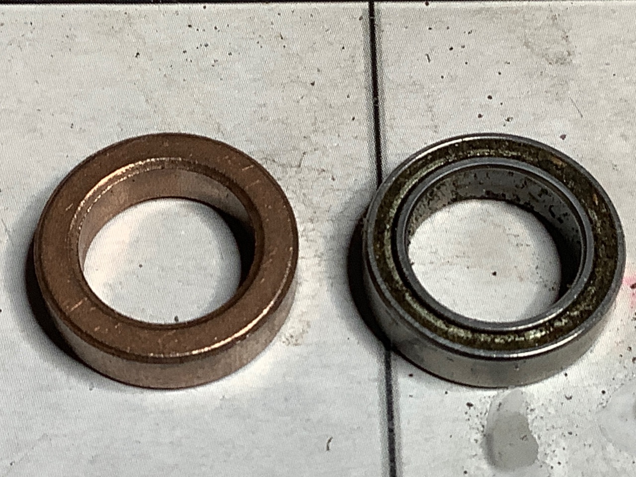

The transmission on my Element Enduro has started to sound a bit noisy so I decided to investigate. After ruling out the rear axle and the front diff, I had a look inside the gearbox.
I really couldn’t see anything wrong except a bit of corrosion on the outer bearings which carry the…..( as I’m writing this I realise I don’t know the correct terms for what I’m describing 🤦‍♂️🤣)…. bits that the drive shafts bolt to. (?)
It’s a fair bet that these two bearings are the culprits.
I’m pretty sure I have some correct size bearings to replace them, somewhere, but while I was looking, I found a bag of bronze bushings that had come with a kit ages ago. I’d swapped them for “proper” bearings at the time.
It crosses my mind that bushes don’t rust and it’s not as if crawlers need to move fast.
Whilst they do offer more resistance than a bearing in good condition, it’s probably less drag than bearings which are binding badly enough to create a loud screeching noise.
So, what do you folks think?  Bush or bearing?
(btw, I’m not proposing to swap all bearings for bushes, just the ones that are most likely to be exposed to water and grime).

I think these are rubber shielded.
I won’t replace any of the inner bearings which won’t get wet and muddy, I’d expect them to last years.
So that’s 3-1 to the bushes so far.

A quick run down on 6 months of a well enjoyed, and well soaked crawlers bearings. The abridged version? ….better than expected! Seem to spin freely enough, no imminent failure but you can feel they have a slight grinding feel. I will fit a replacement set regardless from RC bearings.
Sealed stainless bearings are so cheap that you might just as well chop over to them.
Sealed bearings do have quite a bit of drag but running them on something slow will be unnoticeable.
Igus bushes would be something interesting to try as they're maintenence free, cheap and available in a squillion sizes.
