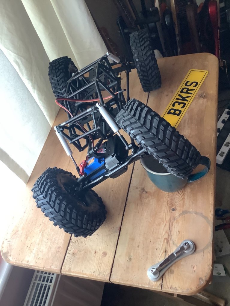

A little more progress, the front motor was fouling on the bottom corners of the chassis on compression, I briefly considered  chopping the chassis, but instead sourced longer links, same as the rear, 107mm at the bottom  and  80mm at the top, (I have been donated a pair of 107mm higher clearance links, for the rear but have yet to go and pick them up.....) along with a combination of long and short ends got the motors pretty level.....one of the body side panels cracked at the crease, so Ill have to remake them, probably a bit thicker, Im  considering extending them right up to the front of the chassis too, just to be a bit different.....Im also considering putting a proper body on it too, who knows?!
The skid has captive nuts and when I was faffing with link lengths one of the screws had locked solid into a nut,  no idea why,  I had to dremel through the screw head, and ended up having to cut the skid to get the nut out, deep joy! So now there is a Delrin skid plate in the mail....
ESC’s are in, front double taped under the “bonnet” (hood) the rear double under the rear battery tray .....keeps the wiring tidy.....not decided where the rx will go yet, but Im hoping to keep the “cab”  clear so I can put a basic  interior and driver in there....its a bit long!...
Ive messed with rod ends since the photos were taken and the front motor is now pretty level...

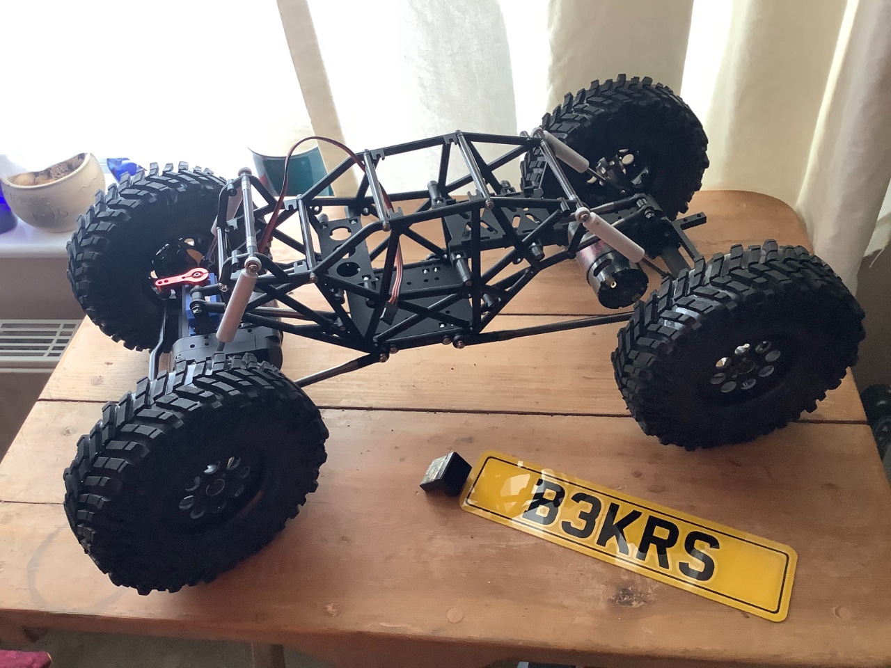

Postie just dropped the delrin skid plate through the letterbox, so Ive fitted it....inexpected bonus, it moves the lower links from the edge of the chassis, onboard so I get loads more steering lock = winner!
Before ( the plate is upside down for ease of access to the captive nuts if necessary, see previous post!)
After......result!

Steering is now limited by the links and  shocks as the wheels foul on them on full lock, not sure whether to live with it or source wheel spacers and put extra strain on bearings/ kingpins....
I guess that depends upon how little steering you have. But as you are running MOA you can always Dig yourself out of or into trouble!! So as long as you have reasonable steering you'd be fine for now... Beyond that then yes you'd have to put a wider hub on ( Better than wheel spacers if workable) .

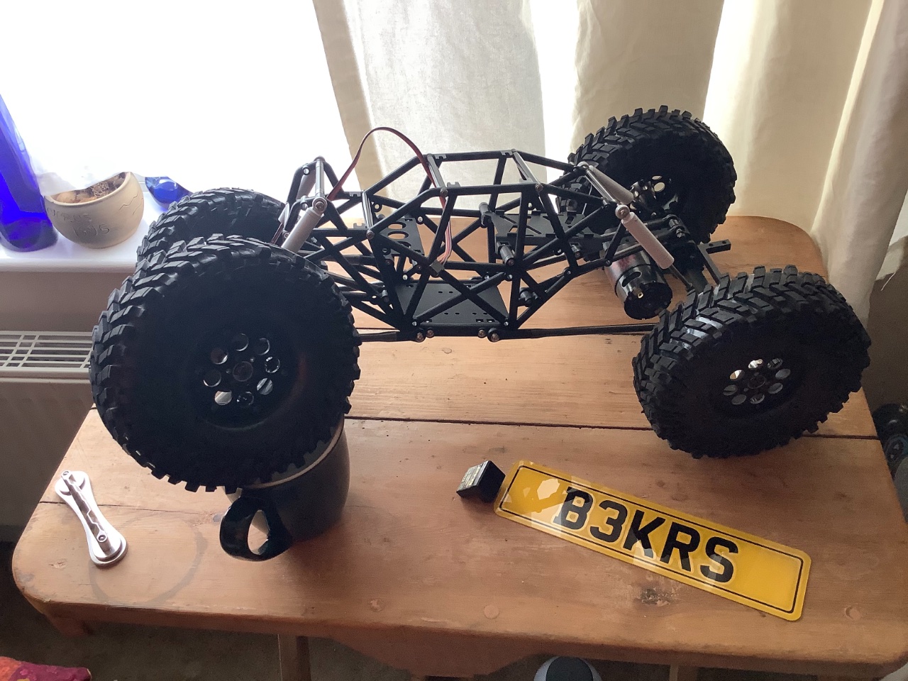

A bit more progress, I bought another chassis cage ( they are dirt cheap) and painted it, then swapped everything over, stripped the axles, replaced and greased all the bearings, rebuilt with loctite.

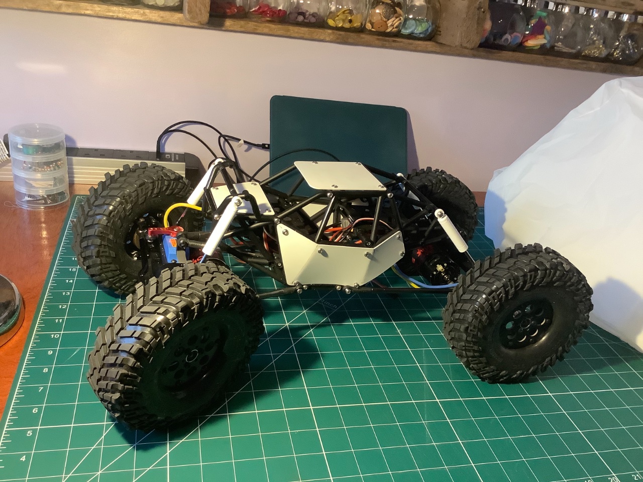

Its all wired now, the wiring needs a bit of tidying, plugged a battery in and each ESC bleeped, but I still have to calibrate them....Im not happy with the body panels I made, so Ill faff around some more, or possibly pop a Kamtec Beetle body on it.....need to source suitable sized Lipo to fit and its pretty much done.
With the widest wheel hubs fitted the tyres dont rub on the links
Less waffle...photos!
