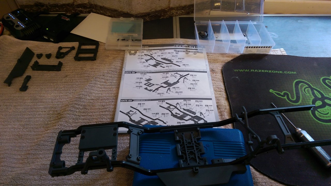

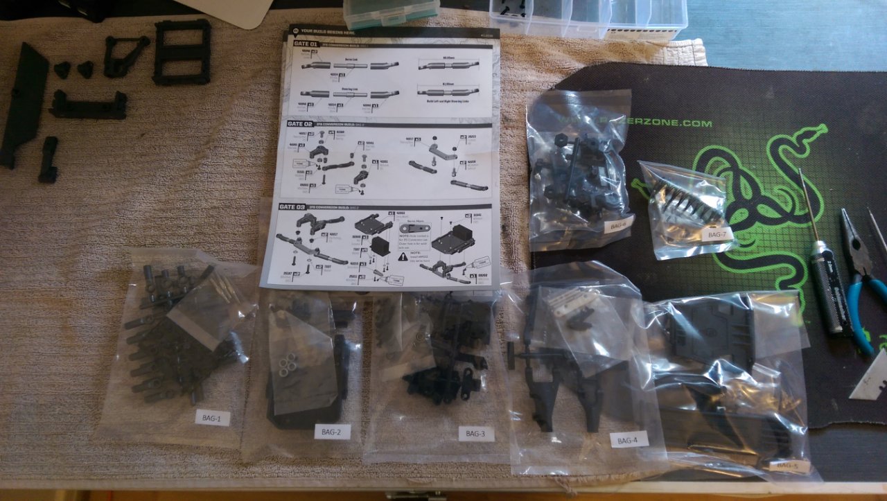

Started the build, going to have sore arms, the hard plastics propper hard.
Instructions seem clear enough, cracking on.
Thats all that can be done for now until the IFS kit is ready. Havent installed the pan hard as that and the front servo plate gets replaced with the IFS kit.

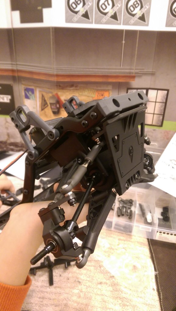

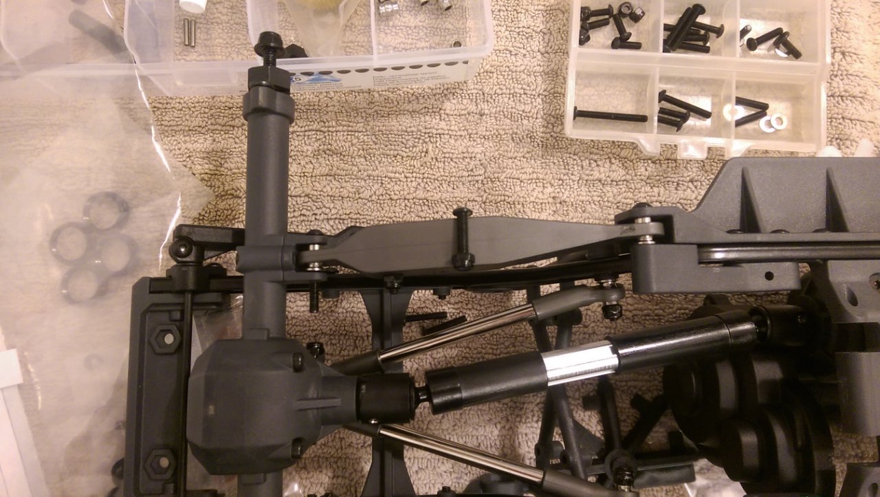

IFS kit started, so far Gate 1 has been pretty aweful, the link rods are round, with no place to grip onto with pliers like most have a square midsection.
Screwing these on was a right pain, already scratched the chrome on them.

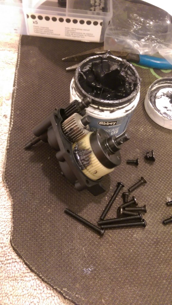

Still on the IFS, they don't use shielded bearings on the diff cup outputs and i cant understand the reasoning, so packed it with marine grease to keep most the junk out till i get some rubber or steel shielded bearings.
Front end done, time for the transmission.
Seems pretty solid, running the stock overdrive for the time being.
Transmission done, time for cuppa and decide what motor to use as the 35t has gone back into the rock buggy.

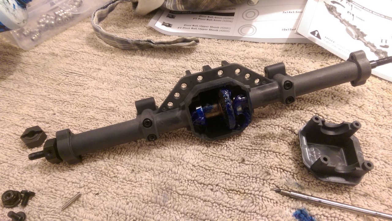

Rear diff, sealed bearings here, so probably will put the front sealed bearings in the IFS. The diffcovers are a super tight fit and once shut are even harder to open without a prybar.

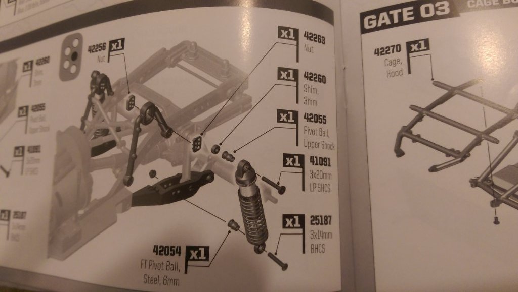

This is where the fustrations start. 14mm screw for the trailing arm to suspension end then a nut... only issue...
14mm leaves about 1 1/2 lines of thread for the nut, this cant be right.

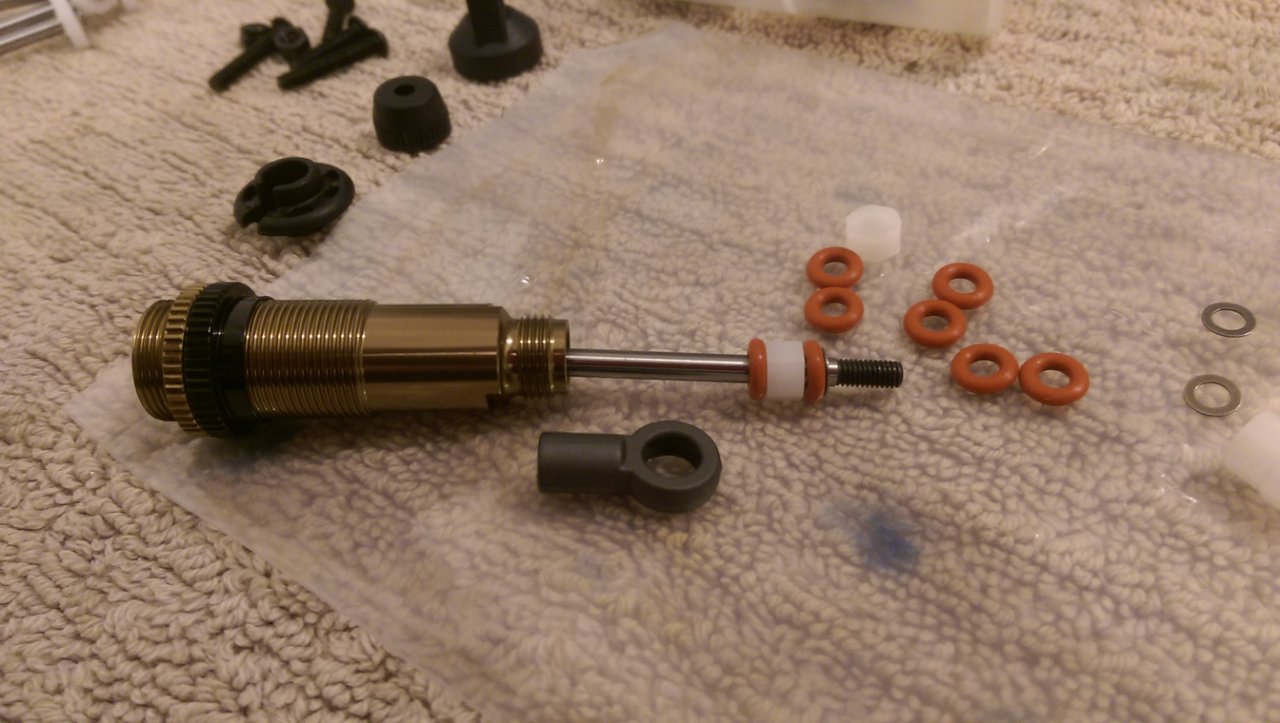

Shocks built, easy and clean to build.

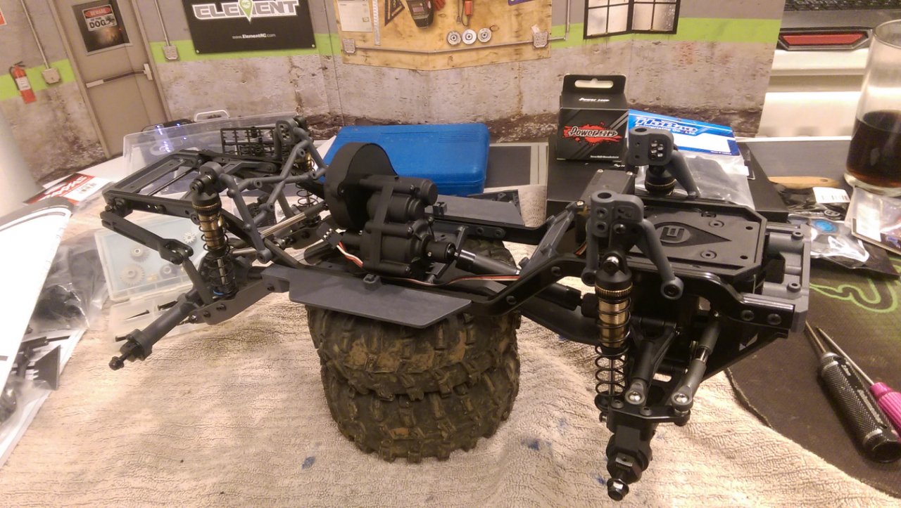

Chassis done, onto the frame.
Frame done, got the rear body pin mounting upside down on the cage, just note theres a slight turn down to the body post holes, if these face up you cant fit in the body pins. other than that was enjoyable.

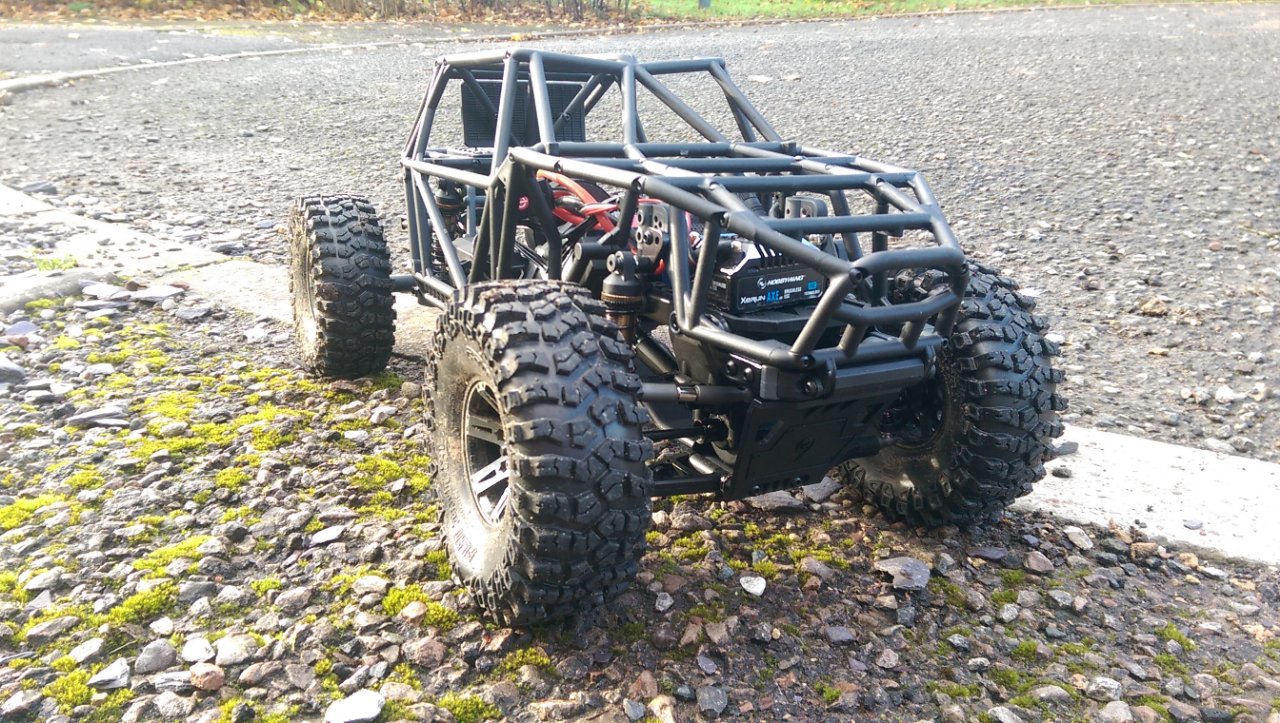

The front CV's makes it lurch under full lock  :crying: the steering however outside of full lock feels really nice, and the way the truck rolls and sits i think is great.

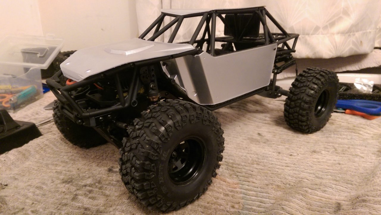

Next up panels, paint and polish, still not decided on the motor, going to give the axe system a go for a little bit before deciding.

Maybe its IFS kit or the heavyweight rims, it doesn't seem very top heavy and performed better than the trx4 (with same heavy weight rims) on some parts of the trail. Will do a bigger review once the builds finished.
One big sad is the tires rubbing all over the front shock springs. Its much worse when turning on the slightly wider canyon tires, less so on the flat irons, any recommendations for deep dish alloy 1.9 and or / 2.2 beadlocks, thank you.

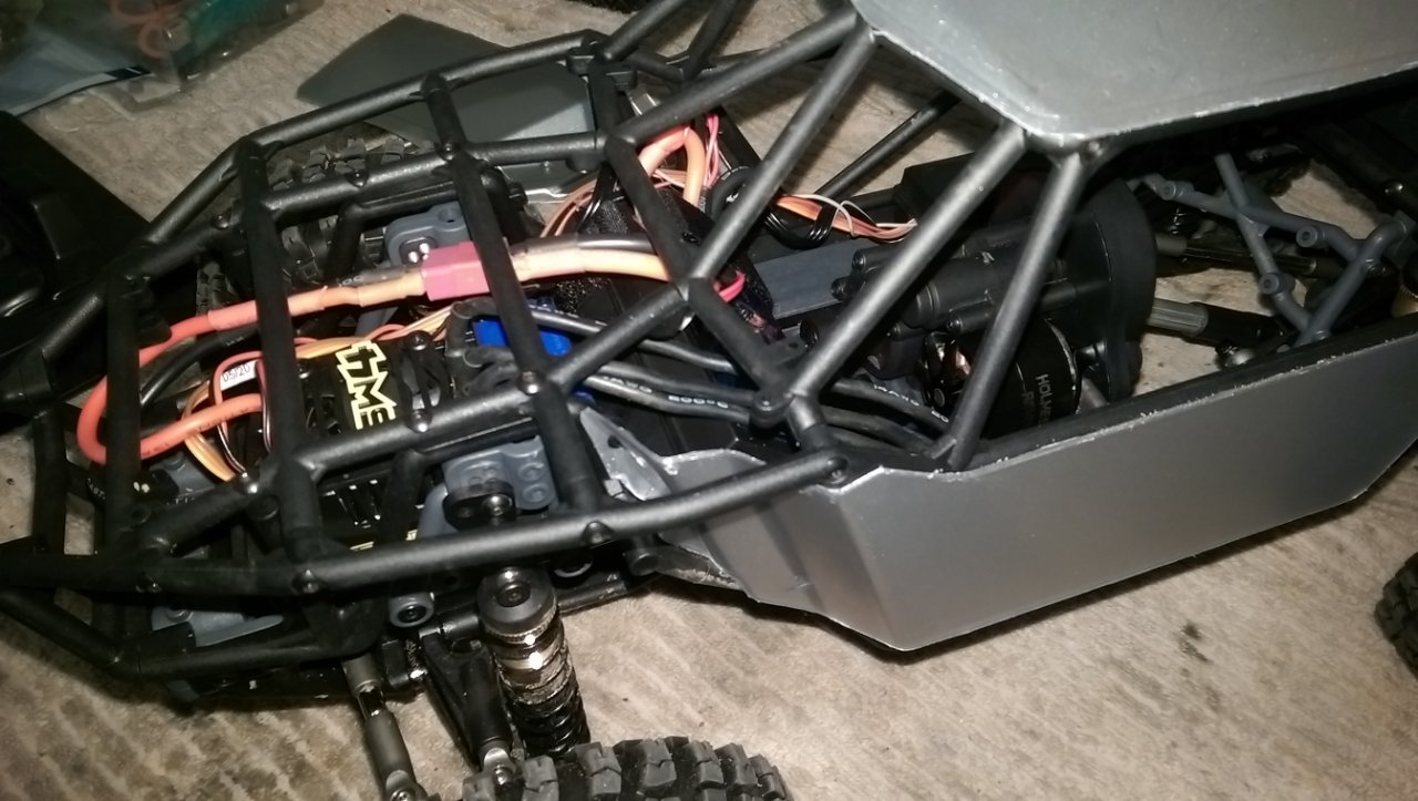

2.2 Gmade R1 wheels and tires with 13mm wideners fit with minimal frame rubbing, also give much better ground clearance for the IFS diff and no rubbing on the shocks,  still rather 1.9s as the trucks now too wide imo.

Decided to see how the Revolver goes as the Axe is back home in the Highrock. Higher KV and 14t pinion so should go a bit faster.
New rims that widen the stance, No rubbing on these.

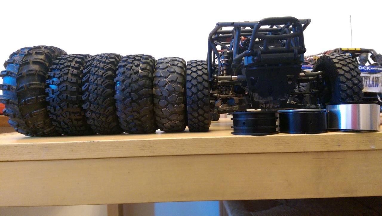

Tires are placeholder being swapped over for some 120mm x 45mm Baja tires later, last set of Baja truck tires didnt work out way to small (109mm x 35mm (30mm))
Smol tires, also showing the deep dish rims (far right) and the width diffrence to stock for those intrested.
