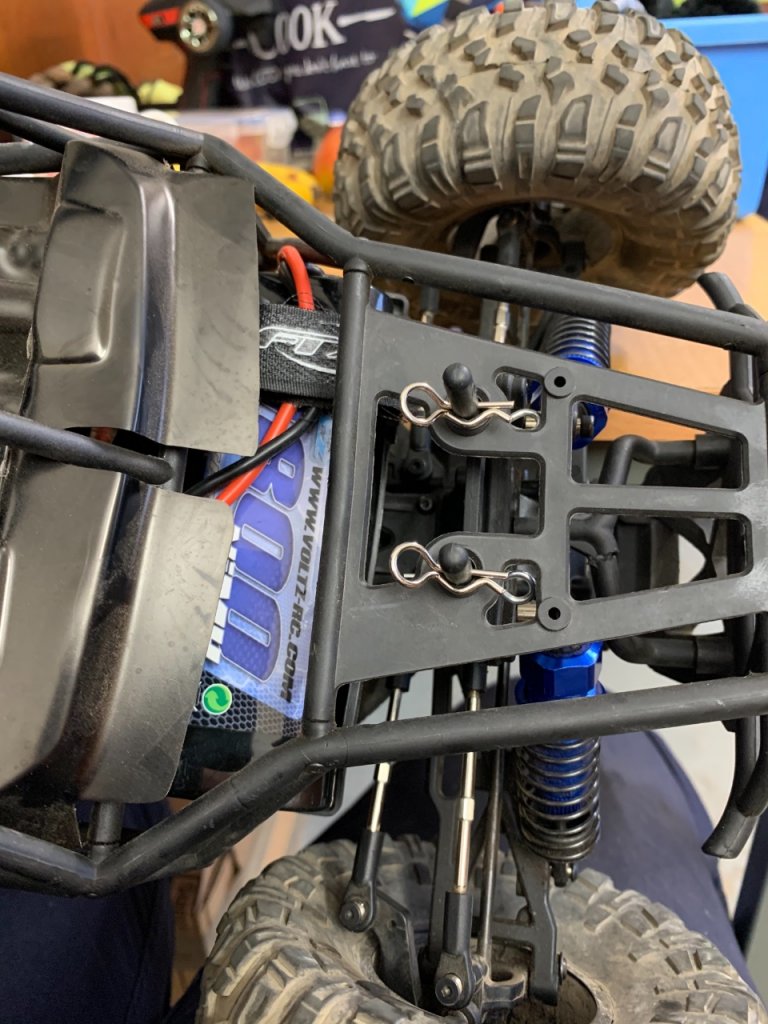

33 minutes ago, Redback said:
So for slack steering the E clips always pop off the rubbish servo saver making it really weak, i glued my servo saver after giving up on loosing eclips and havent had a servo fail.
This is the eclip im on about and it looks to be missing here. You can also try a servo saver arm but i found this was also to weak to move my large tires.
Not surprised the rear cv snapped with brushless power, sorry to see it happen but i feel its going to be a weak point.
Bbare in mind your putting tons more torque into these than they are designed to take, front not so much an issue as its pulling, but the rear pushing takes more loads.
Yeah there's no clip on mine. I don't think it came with one. I'd say that's why my steering has always been particularly rubbish. Think I'll try gluing it.

Yes theres no clip and it was 2nd hand so probably got lost on its first run. This is why the steering is garbage garenteed.
