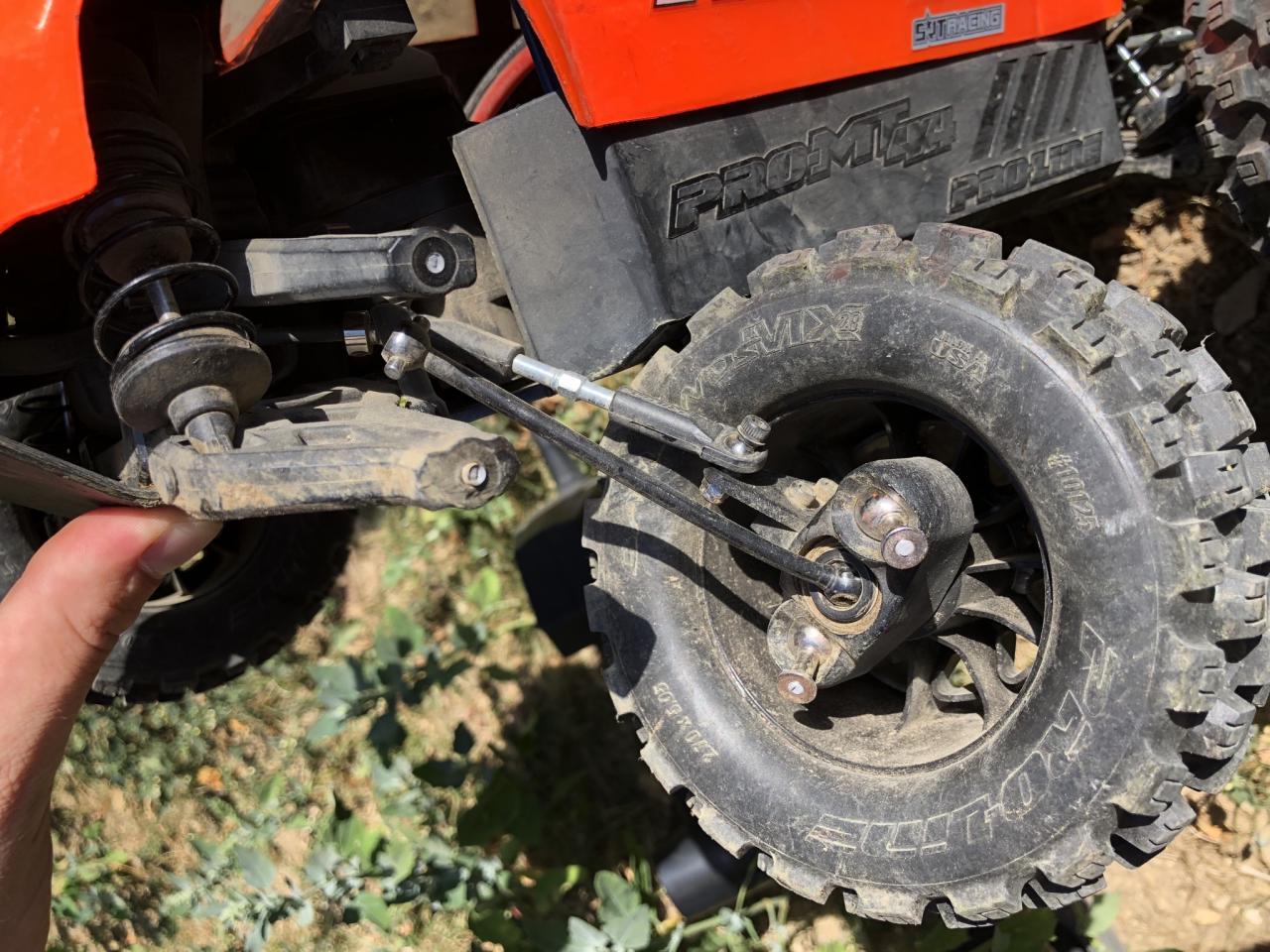

Managed to free up the steering by sanding the pillow balls down in a drill, and I replaced the standard steering plate and inadequate bearings imho with a turnbuckle with ball ends so I can tighten it up as much as I want without it binding and wayyyyy less slop! So I can run it now..
Oh, btw @tanveer, some of the binding is caused by the suspension being fully decompressed. The ball ends on the hubs connecting it to the steering assembly with a turnbuckle are at an extreme angle, so if the car isn't settled and the wheels off the ground for example, when you try and test the steering, it binds a little, but when the car is settled (or you lift up the arms while you test it you'll feel its a bit more free, that was my experience anyway)  its the other things like the steering plate or the tight fit of the PBS on the hubs.

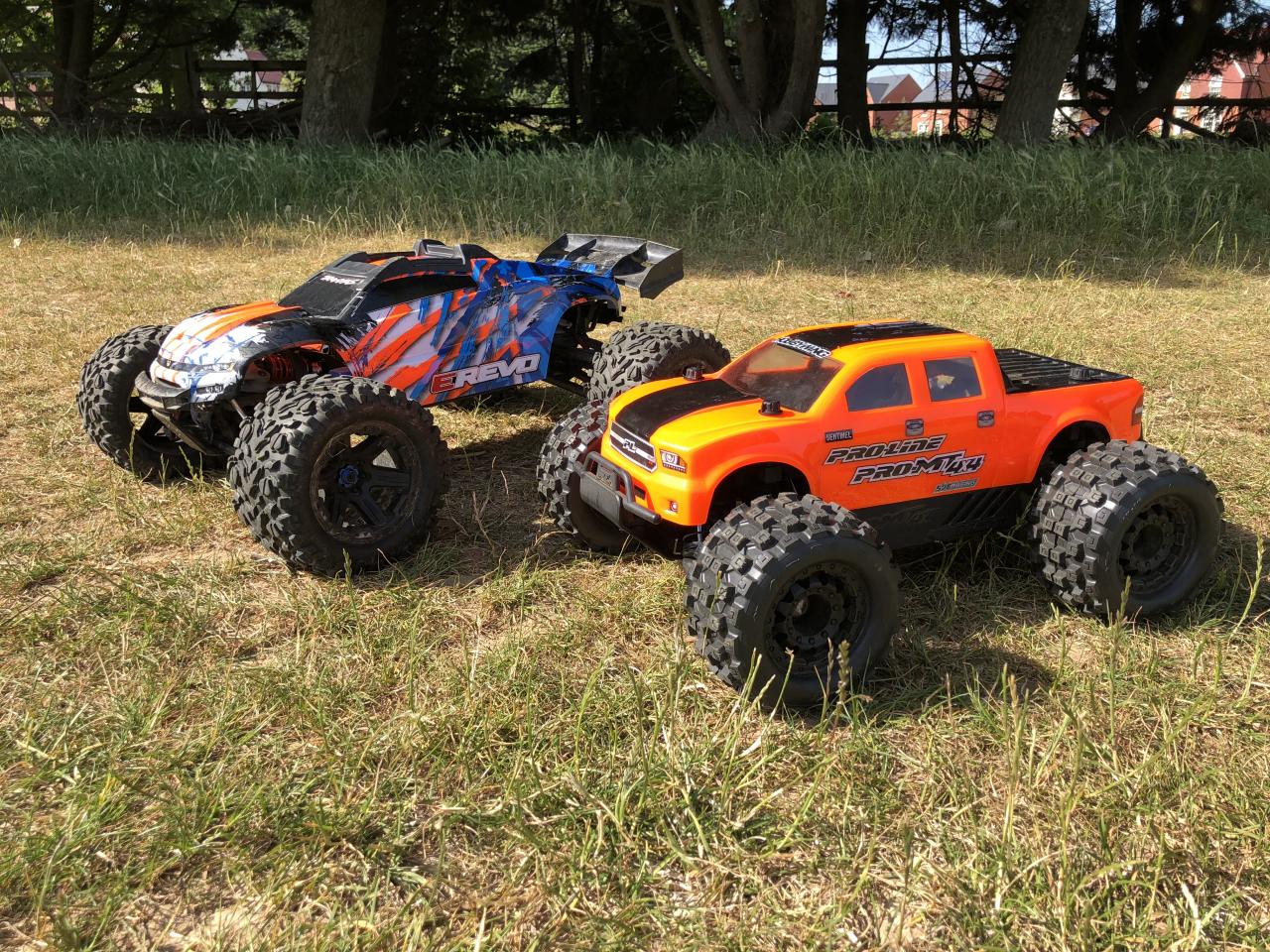

Gave my Pro MT recently purchased off AJ it’s first run yesterday, great little truck ?
Im going to get a 2200kv combo for it as it got a little warm with the 3200kv I had in it, wouldn’t mind trying 4S at some point just for the fun of it. Driving it back to back with my E Revo 2.0 I’ve gotta say I enjoyed the Pro MT more, really wasn’t expecting that ??

I tried it out and your right, once the car has the battery installed and it sits a little lower the steering is much better. Iv reduced the spring pre load on shocks and hopefully its sorted.

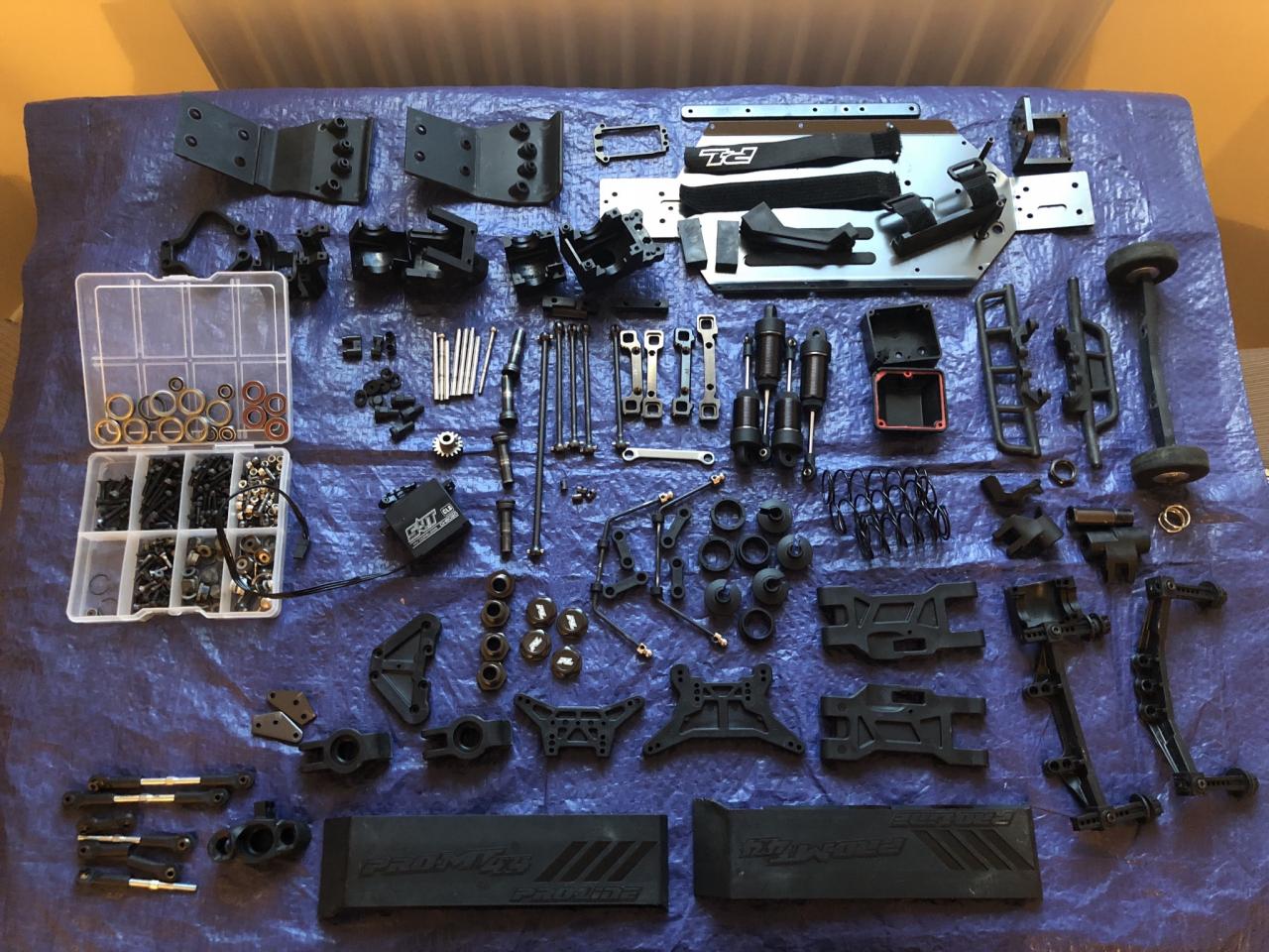

So while I wait for parts to arrive I figured I’d use the time to give it a full tear down..
Its obviously a lot cleaner, but was pleased to find no damage or wear in anything other than the hinge pin holders and pivot balls I already knew were damaged.
Something to look out for though is the centre diff bearings, as they aren’t rubber shielded one of mine wasn’t in a very good way, replacements on the way though ??
