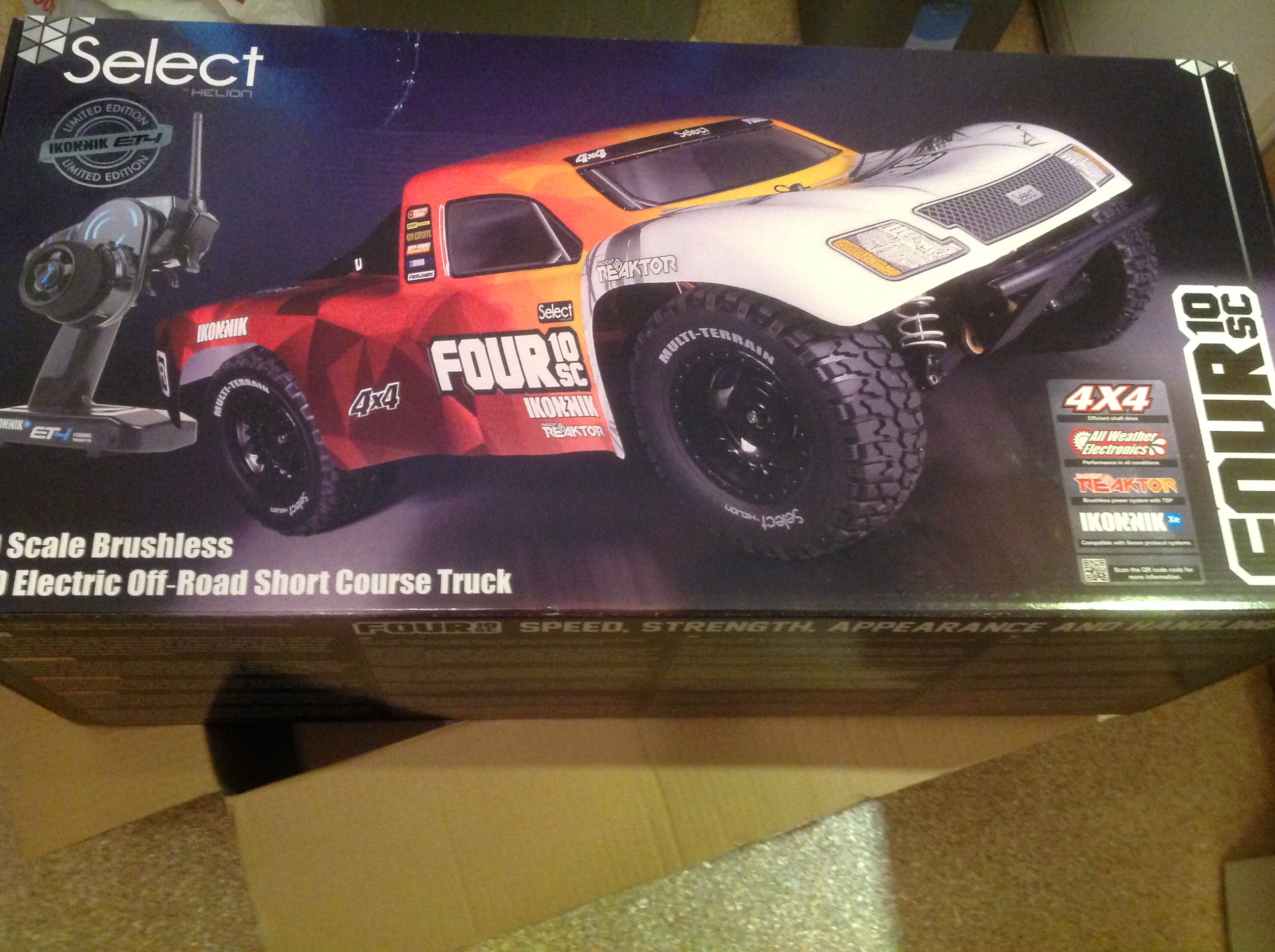

Popular Post Noj Posted February 2, 2016 Popular Post Share Posted February 2, 2016 Fair to say that some, early production Helion offerings were a little questionable and they do still use Phillips head hardware on their 1/10th range, until now....The Select Range, kicking off with the Four10 SC. Essentially, a Slash style SC, but LCG out of the box for MUCH less money. Ally towers, shocks, bulkhead supports, propshaft, hubs, RS bearings, metal diff gears (internal and external), tie bars as standard, comes with a free hairnet too, for those dusty, mown grass bashes. Shell feels to be good quality, the lexan isn't thin... Stock radio is untried (was dropped by a clumsy fella before even being switched on), however, although perhaps a bit clunky looking, has 10 model memory and comes with a different sized rubber grip. Now, the four pole combo is, out of the box, rather rapid. Looks very Quicrun and the hobbywing program card will allow alteration to the first five parameters on the esc, connecting via the fan port in the same manner. Raced on 2s,with stock gearing, the truck itself is light, the can punts it around very very swiftly. The shocks were softened off for the circuit it was raced on, turned in very well on the stock servo and still soaked up the bumps well. Flew down the back straight, looked excellent under braking as the nose tucked down.... One minor issue was the rod ends popping off the steering: the first time was following a collision with a large, track side cone (to be expected perhaps), however, both sides popped off at random times during each race (robbing us of a place, if not two).... Turning the steering by hand, at full travel, there is a levering motion on the rod ends which may well be the issue...a slight knock and off they pop. The truck was running different offset wheels which may be a contributory factor.... Anyway, initial impressions are excellent, and currently available for £249.99 I feel it represents better vfm than say a Slash or Blitz out of the box. Parts are reasonable, possibilty of RPM making arms, as they have for other cars in the range. Have a look at the pics and see what you think. Stock wheels and tyres: 4 1 Quote Link to comment Share on other sites More sharing options...

Noj Posted February 2, 2016 Author Share Posted February 2, 2016 (edited) The rod ends were a surprise, they take some force to re-attach. Considering hollow balls if the problem persists. Not the most stylish, granted....at the price point, I'll forgive it. Proper thought has gone into this model, needs more runtime to see how durable it actually is..... Oh yes, forgot to mention the combo runs a motor temp sensor....random! Edited February 2, 2016 by Noj Updated info Quote Link to comment Share on other sites More sharing options...

Noj Posted February 4, 2016 Author Share Posted February 4, 2016 Good man Tom Re the rod ends, they pop off the central steering points, not the hubs. Bit of research and Schumacher do these (scroll to the bottom of the page) captured rod ends.... http://www.racing-cars.com/sp/category/New_Cars_and_Parts/subcategory/CAT_K2/templateid/12/searchbox7/Suspension.html I am getting Nige to check the endpoints though.....just in case 1 Quote Link to comment Share on other sites More sharing options...
ostewart Posted February 4, 2016 Share Posted February 4, 2016 Traxxas do some captured rod ends that'll fit. If you want to stick to cups, HPI Blitz ESE rod ends are a good choice, they use a harder composite plastic which doesn't pop off easily at all. Quote Link to comment Share on other sites More sharing options...
tomr Posted February 4, 2016 Share Posted February 4, 2016 1 hour ago, Noj said: Good man Tom Re the rod ends, they pop off the central steering points, not the hubs. Bit of research and Schumacher do these (scroll to the bottom of the page) captured rod ends.... http://www.racing-cars.com/sp/category/New_Cars_and_Parts/subcategory/CAT_K2/templateid/12/searchbox7/Suspension.html I am getting Nige to check the endpoints though.....just in case Thanks bud they'll do nicely Quote Link to comment Share on other sites More sharing options...
Noj Posted February 5, 2016 Author Share Posted February 5, 2016 Schumacher captive rod ends landed today, really lovely parts, smooth to operate, nicely engineered. Nige will be stocking these within the Helion parts listings, a set will be fitted to the Four10 prior to the race meet at the end of the month and I'll report back Quote Link to comment Share on other sites More sharing options...

Noj Posted February 5, 2016 Author Share Posted February 5, 2016 I can believe it, having seen the 2s performance. Schumacher short rod ends fitted, perfect fit, much more articulation, sorted. Quote Link to comment Share on other sites More sharing options...
