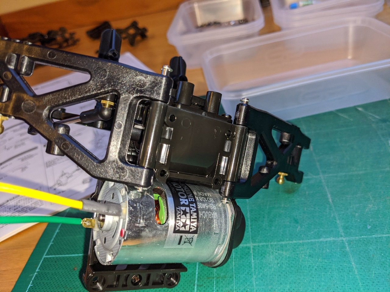

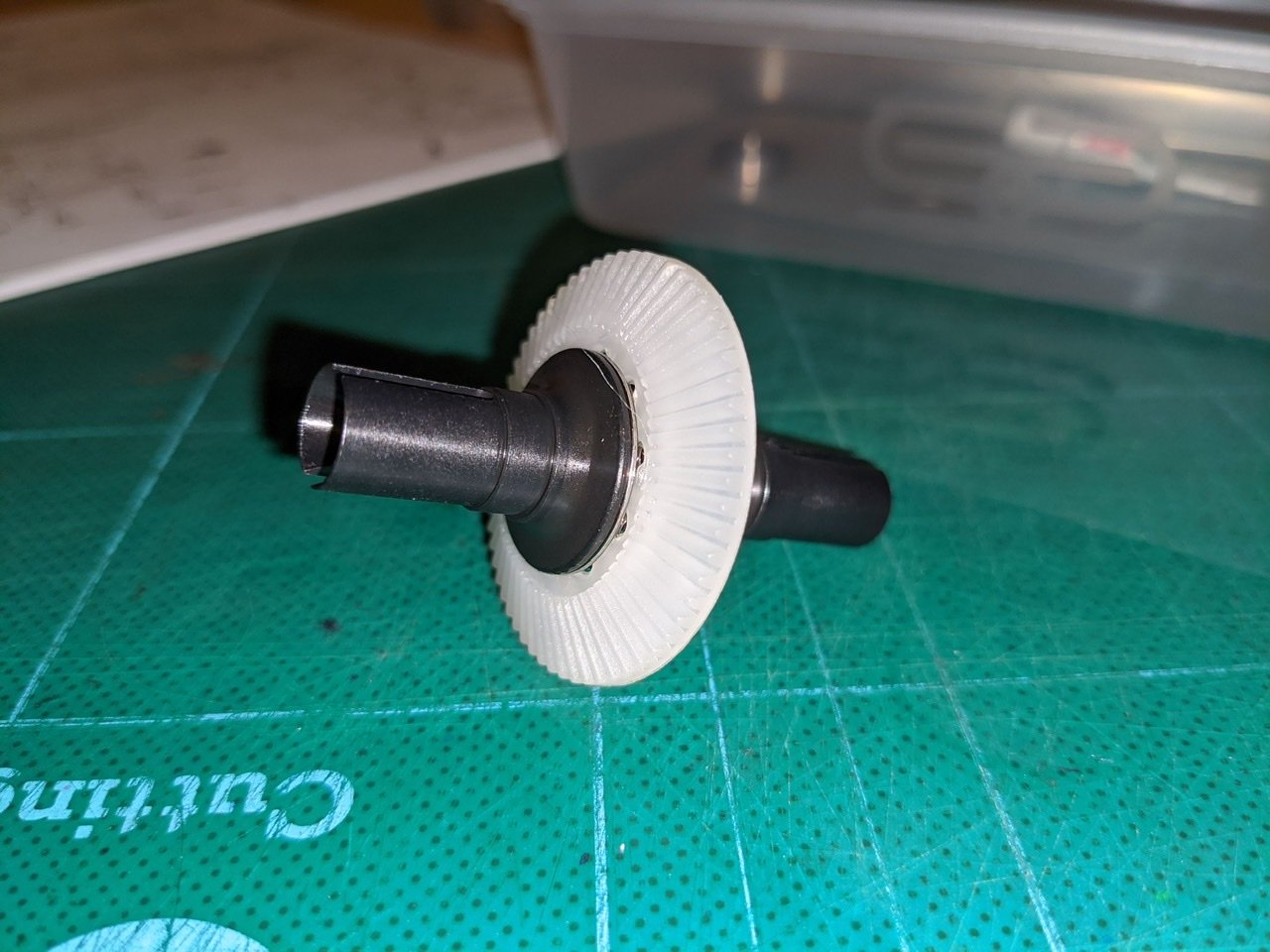

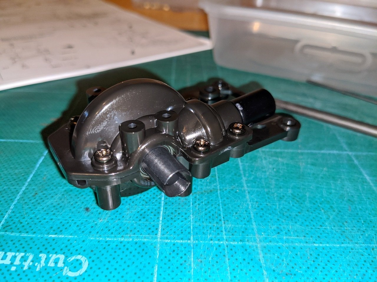

oodboo Posted June 4, 2020 Share Posted June 4, 2020 (edited) Got myslef a DF03 Dark Impact the other day and I’ve started putting it together. Thought I’d share some info from the build as there doesn’t seem to be much about the DF03 on here. That is the first time I’ve put together a Tamiya ball diff. Was a new experience and I’m not sure I’ve done a good job of it. I think I may have over tightened to screw that holds it together but it’s together now. If it breaks it’s a problem for another day. A read somewhere about running it in a bit with a drill, so I done that as well. Just put one end in the drill, held on to the middle and spun it. Tightened it up again, repeated this a few times as the balls weren’t seated correctly when I first put it together. Hopefully I’ll make a better job of the other one. I’ve got the motor on now but I’ve only taken one photo so far. I’ll get some more before I move detailed photos before I go any further. Edited June 6, 2020 by oodboo Corrected title 1 Quote Link to comment Share on other sites More sharing options...

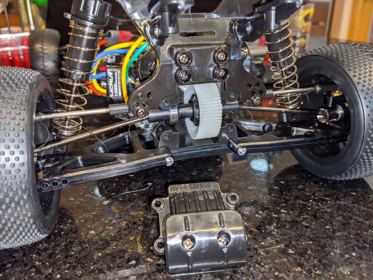

oodboo Posted June 4, 2020 Author Share Posted June 4, 2020 I like the way the covers can be removed easily to inspect or replace the gears. 1 Quote Link to comment Share on other sites More sharing options...

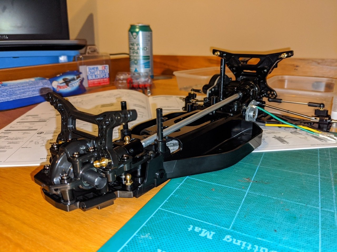

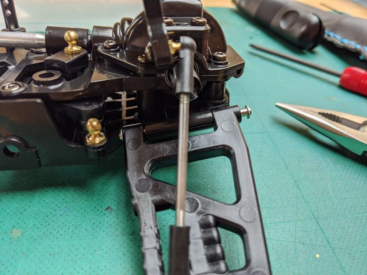

oodboo Posted June 5, 2020 Author Share Posted June 5, 2020 Made some more progress last night. I was surprised how much play there is in the pins for the rear arms. Feels like they could be almost 2mm shorter. Those little e-clips are a PITA, never been a fan of them and these seem to be in a vulnerable position. I’ll see if they’re problematic before worrying about an alternate. 1 Quote Link to comment Share on other sites More sharing options...

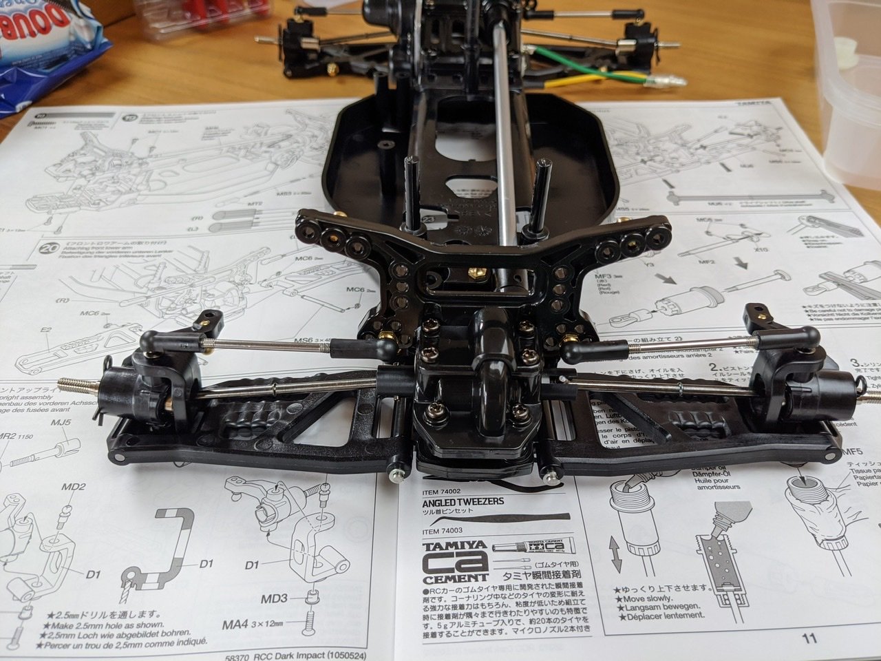

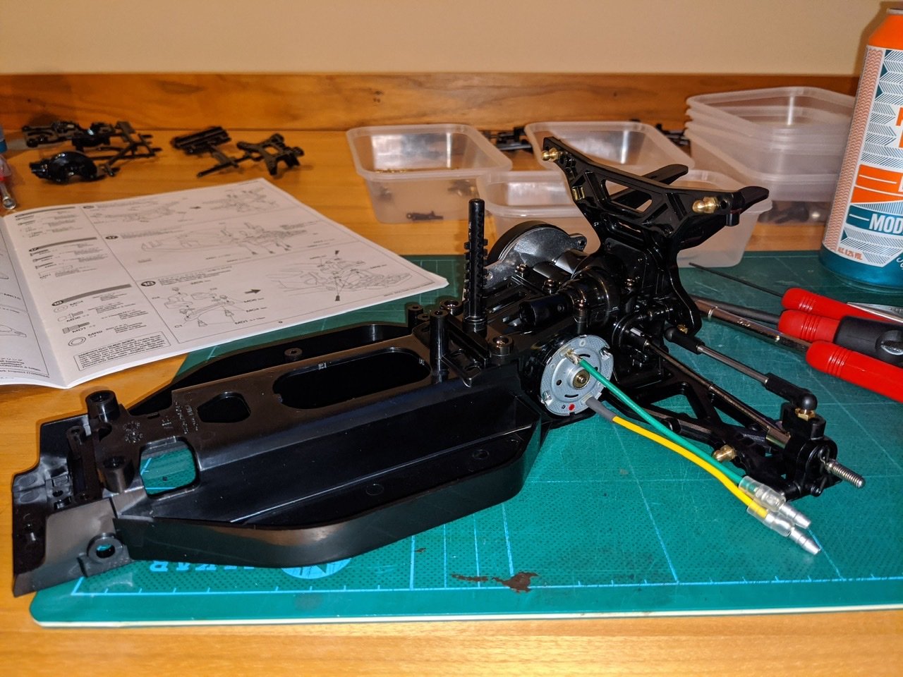

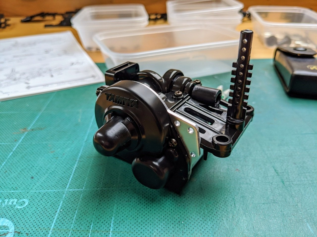

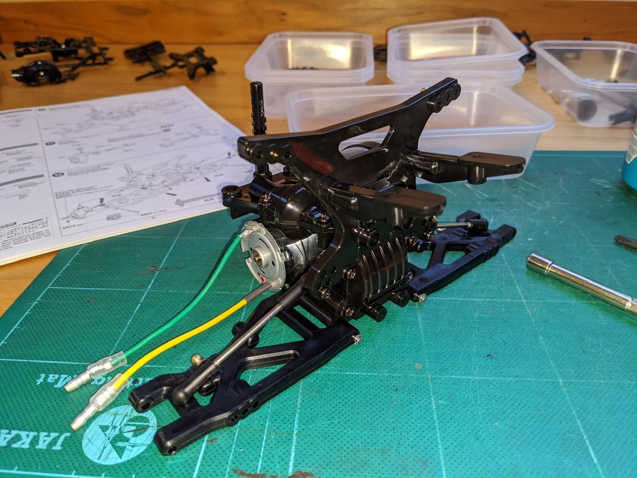

oodboo Posted June 5, 2020 Author Share Posted June 5, 2020 (edited) Rear end goes on the chassis then it’s on with the front diff. This went together a lot better than the first one. Would be good if you got a spare to practice on lol. I pushed the balls into place before assembling the diff this time and everything went a lot smoother. The diff then goes in the front gearbox which attaches to the chassis and some steering parts go in as well. I feel like I’m missing a few things here compared to how long I spent building this last night but the point is, it’s coming together. Edited June 5, 2020 by oodboo Re-order content 1 Quote Link to comment Share on other sites More sharing options...

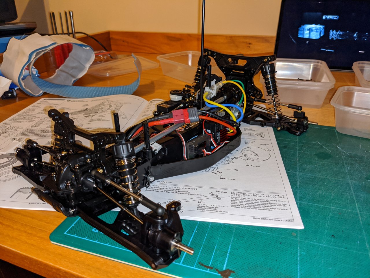

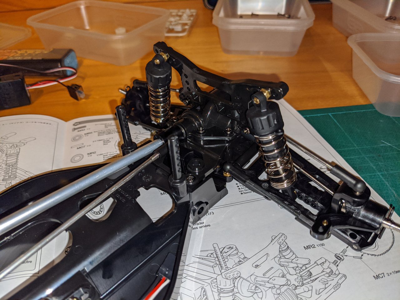

oodboo Posted June 5, 2020 Author Share Posted June 5, 2020 Front arms are on now. Again, there seems to be a lot of unneeded length on the hinge pins. Again, I’ll wait to see if it causes any problems before looking for a fix. Not point fixing something that isn’t broke right. Front turny bits went on without a hitch and then I got the rear shocks built and fitted. First tamiya kit I’ve built that comes with hard shock oil, everything else has come with the yellow soft stuff. All the parts are now laid out ready to build the front shocks but I got called away. 1 Quote Link to comment Share on other sites More sharing options...

oodboo Posted June 5, 2020 Author Share Posted June 5, 2020 Got the front shocks built and fitted then instead the servo and steering gubbins. 1 Quote Link to comment Share on other sites More sharing options...

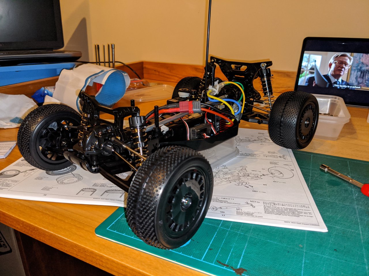

oodboo Posted June 5, 2020 Author Share Posted June 5, 2020 Not much left do do but fit the front and rear bumpers, wheels and tires and get all the electrics in. 1 Quote Link to comment Share on other sites More sharing options...
oodboo Posted June 5, 2020 Author Share Posted June 5, 2020 Only thing left to do is there shell so it needs a quick run in the house to make sure everything works as it should. Quote Link to comment Share on other sites More sharing options...
oodboo Posted June 6, 2020 Author Share Posted June 6, 2020 Ok, so it's broken already. I managed to strip the threads out the first nut I put in. The tiny little m2 but that holds the rear diff together. Fortunately the rear diff is very easy to access, unfortunately I don't think I have any spares. At least it gives me some time to get the body done while I sort the diff. 1 Quote Link to comment Share on other sites More sharing options...

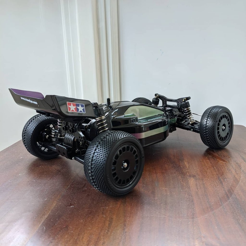

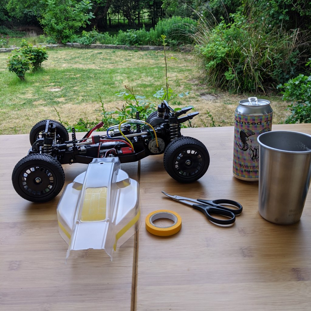

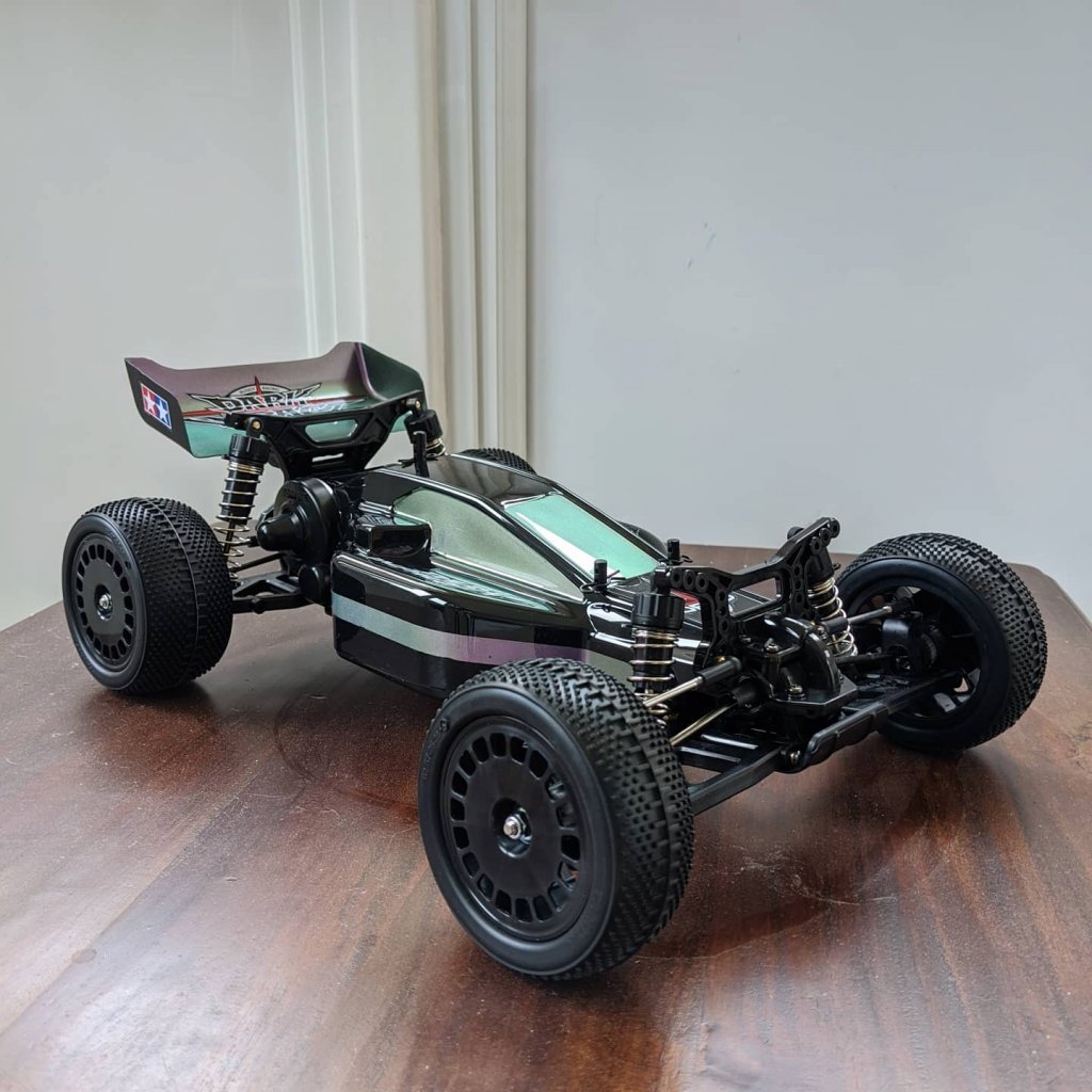

oodboo Posted June 10, 2020 Author Share Posted June 10, 2020 I hate masking, when they don't supply window masks can you use the window stickers as masks? Anyway, got the body painted last night 1 Quote Link to comment Share on other sites More sharing options...
Popular Post oodboo Posted June 10, 2020 Author Popular Post Share Posted June 10, 2020 Added a few stickers this morning. All done but waiting for a screw to fix the rear diff and better weather to run it. 5 Quote Link to comment Share on other sites More sharing options...

oodboo Posted June 13, 2020 Author Share Posted June 13, 2020 Still struggling to get the diff set up correctly. Too tight feels wrong, too lose and you loose drive to those wheels. In stock set up it’s getting slaughtered by my son’s TT02B. Hope I can get this set up correctly as I like the buggy and I’d rather not shelf it and buy a TT02B. 1 Quote Link to comment Share on other sites More sharing options...
No brains Posted June 13, 2020 Share Posted June 13, 2020 2 hours ago, oodboo said: Still struggling to get the diff set up correctly. Too tight feels wrong, too lose and you loose drive to those wheels. In stock set up it’s getting slaughtered by my son’s TT02B. Hope I can get this set up correctly as I like the buggy and I’d rather not shelf it and buy a TT02B. It is a nice car and putting it on the shelf is not what you want , but ball diffs I hate them they are most of the time a pain to adjust and do not like brushless power, If I can not put a gear diff in a car I am not buying it, I have put a kyosho gear diff in my zahhak with some mods because of the ball diff, I have looked at the df-03 to but there are nog gear diffs for it so it is not for me, but you have a great looking car😃 Quote Link to comment Share on other sites More sharing options...

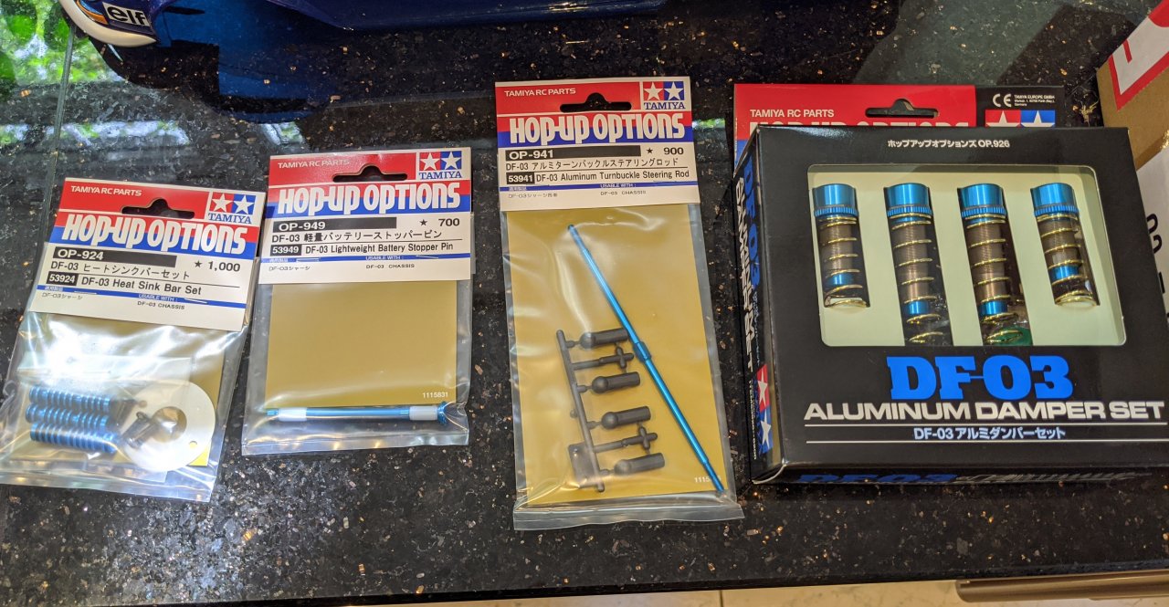

oodboo Posted July 25, 2020 Author Share Posted July 25, 2020 These just arrived so might not give up on it just yet. Some other parts are on the way as well, I can't remember what though. 1 Quote Link to comment Share on other sites More sharing options...
oodboo Posted July 25, 2020 Author Share Posted July 25, 2020 Can't see most parts but I do like those shocks. 1 Quote Link to comment Share on other sites More sharing options...
