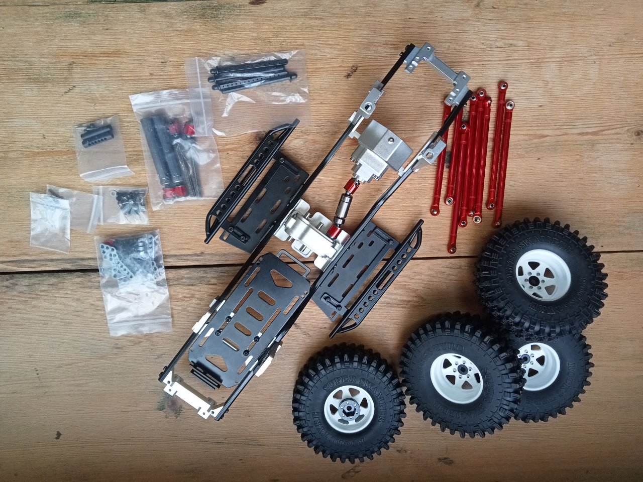

The bits so far. Have monkied about putting the rock sliders on, moved the battery tray forward, just playing about till I get the axles and can really get started.
Seems ok to my novice eyes. It'll keep me busy (not quiet) for a while anyway.

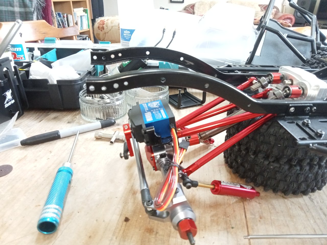

Well she's fighting all the way but am loving the challenge of this kit.
No idea if I'll end up with a functional truck.
Seem to be issues everywhere with clearance and angles but nothing rearrangement, an angle grinder, and leverage hasn't fixed yet.
Currently 'modifying' the front motor mount to give the axle mounted servo some more space.
