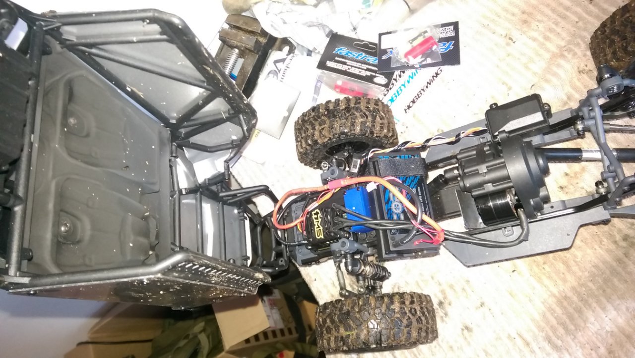

I like this transmission it has plenty of room for addons. Made a little motor protector to keepmuck & twigs out of the outrunner motor casing.
IMAG1291.thumb.jpg.fe9f27192e477020617e210ca1eeb604.jpg IMAG1290.thumb.jpg.6637f39b6540027cd1de70a023986ba8.jpg
Took her out for a test with the sidewinder4 , holmes hobbies revolver 2700kv and 17t pinion. Was good but not fast enough for my likeing similar issue  with the axe 1800kv.
Moved up to a 5000kv castle sensored on 10t pinion will see how that fairs. Its got tons of speed and very smooth startup.
The esc is overkill but its the only one i have for this motor, it takes up the entire top servo plate, with 5mm room left over.

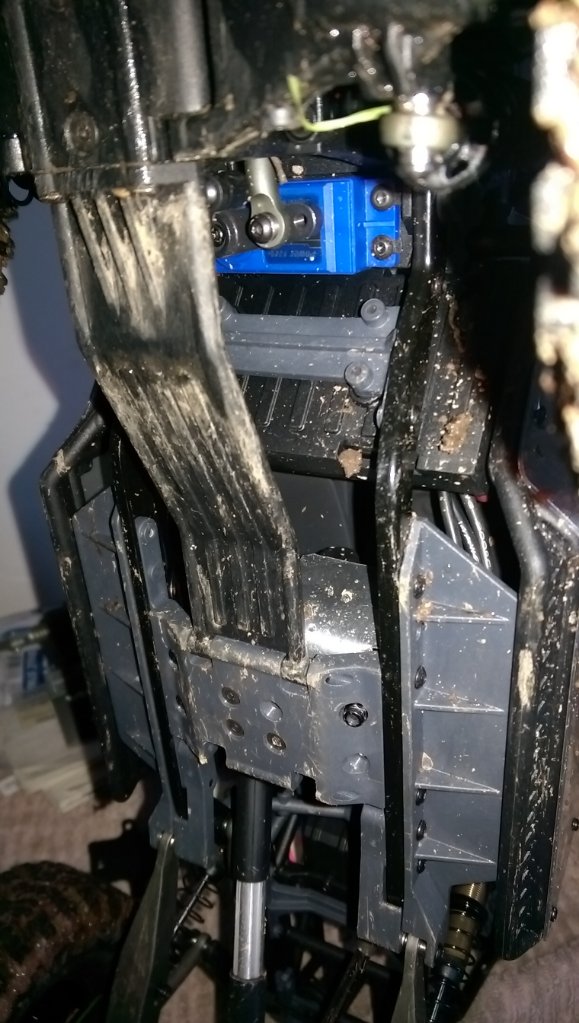

For those interested there is just enough room to mount a scale winch infront of the esc on the top plate of the IFS kit, closing the cage was troublesome however they will fit.

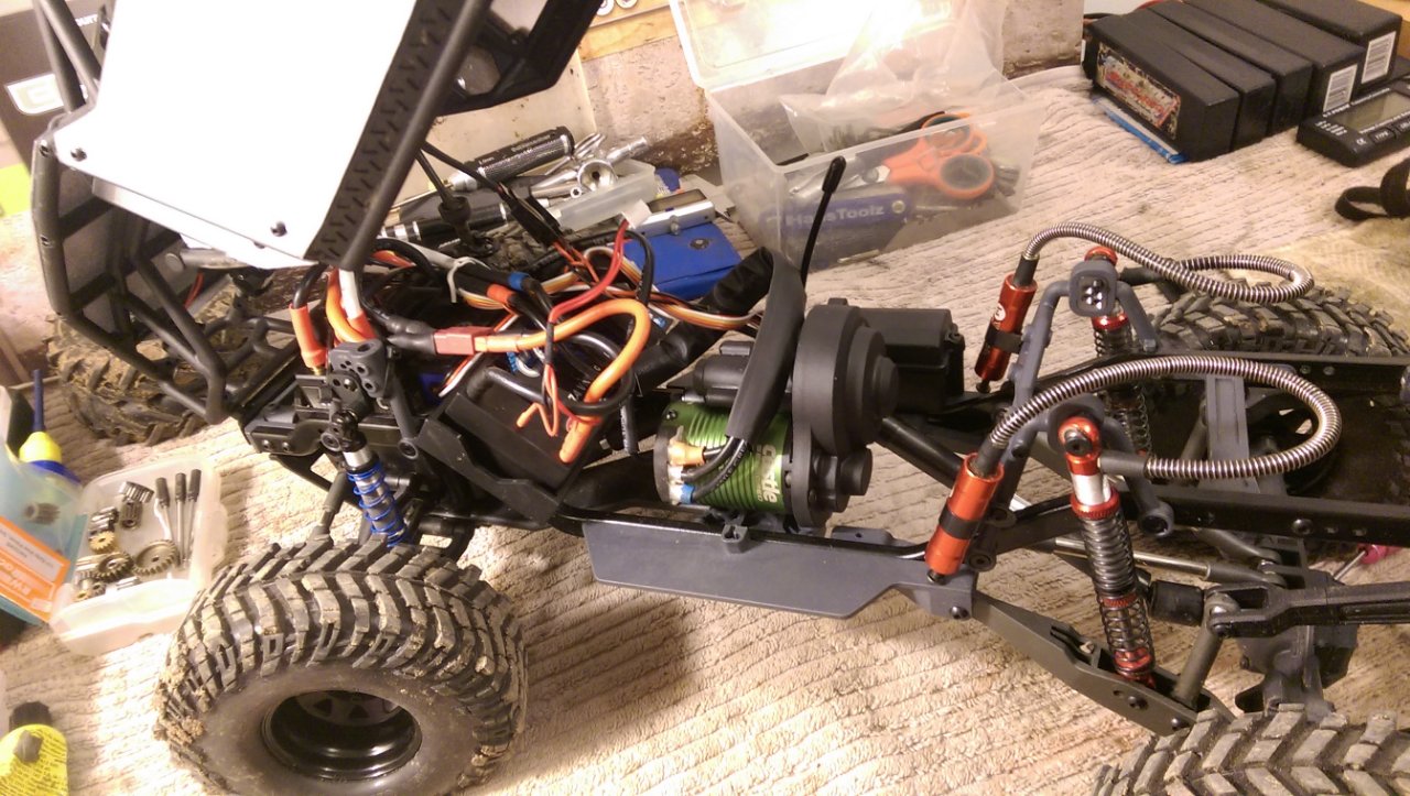

Was happy with the stock shocks but need a bit more ground clearance with the IFS so swapped out for some longer dual rate shocks i had been using on my other crawler.
I think they look alright, might look better with bigger bore ones, however functionality over looks these perform really good.
IMAG1303.thumb.jpg.3497f7fb3861ea0cae1365f06b881c48.jpgs
Tiny bit of rubbing when on extreme compression. These rims are deep and offset the wider tires by quite a bit, so my assumption at the start that the open cage body would make it easy to fit big tires was wrong.

Major issue with steering even at 7.4v on a 21kg servo the steering locks up. Will be getting a much stronger servo maybe double it to 48kg. Im 50/50 on the IFS kit it looks neat but performance is weird.
