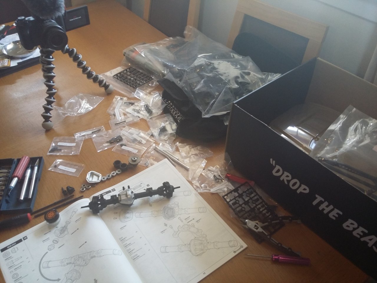

Hello all,
Just took delivery (FINALLY) of my new kit- the Komodo Double Cab :D
Plan is to build this up, over this week. Eventually spraying the bodyshell dark, metallic red, as per the GS01 Komodo boxart.

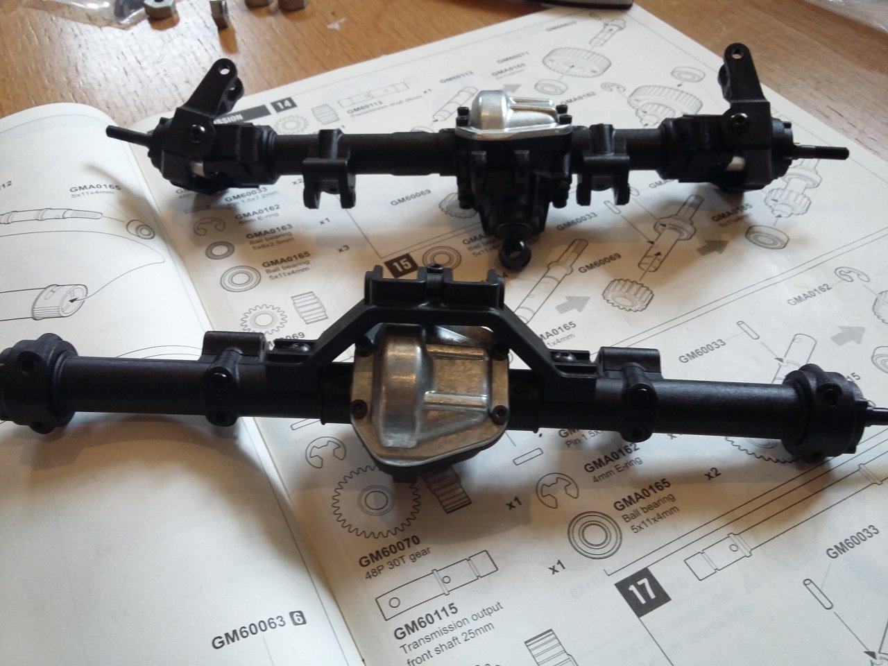

A little bit of progress made; just finished assembling the front axle.
Words that cross my mind, when assembling this truck, are "Substantial" and "hefty".
Yeah, I'm not the neatest RC builder!
If I had any "complaints" so far, it would be that snapping-off parts from the parts trees ALWAYS leaves a burr! More so than even the old Tamiya TL-01 kit. Not a problem, just annoying.
Apart from that, I'm enjoying what I've done, so far. :good:

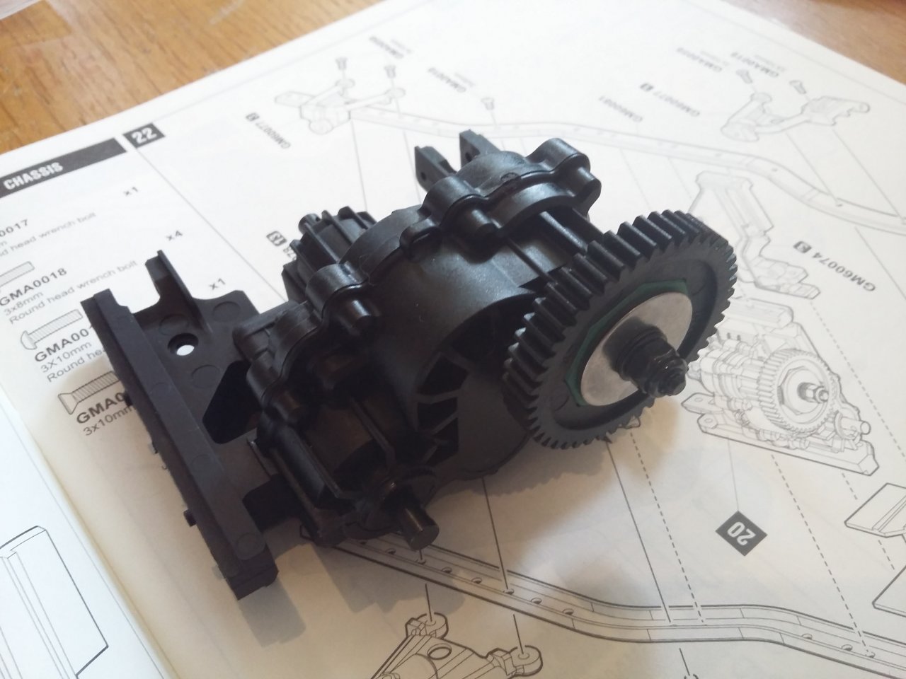

Built the transmission, today.
In stark contrast to the rear axle, the gearbox is buttery smooth! It's a thing of beauty!
It's easily one of the slickest RC gearboxes I've ever come across; it feels almost as if there were no cogs inside, just bearings.
Very impressed. :D

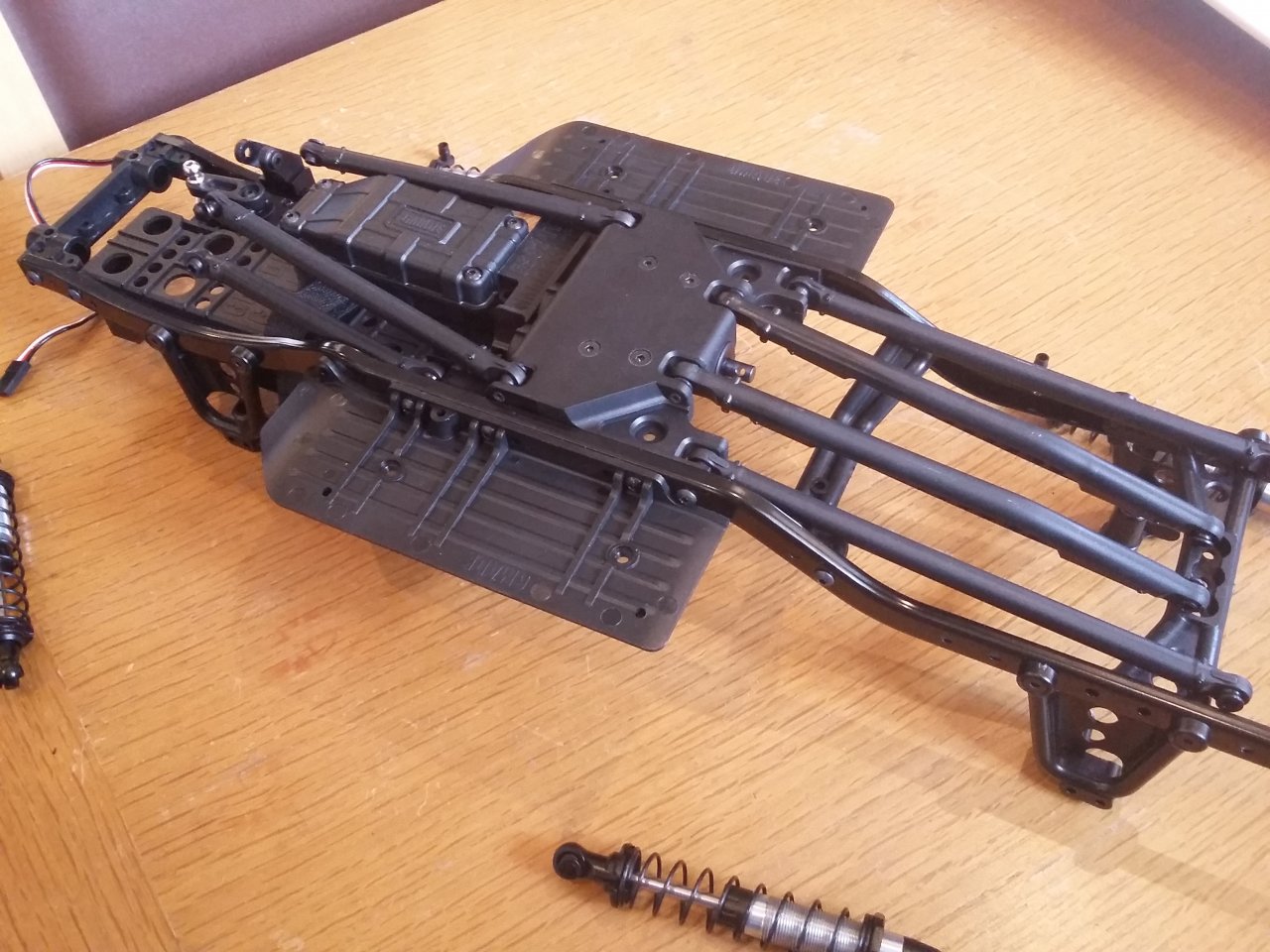

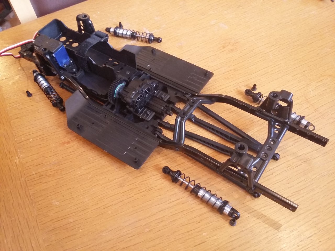

Worked on the chassis, today.
It fought me a little bit, because the gearbox mount is just floating at the moment (links screw into it). When I started to screw the suspension mounts etc tighter, however, it all pulled into line.
While building it, it struck me how well thought-out this chassis is. Probably, all high-grade crawler RCs are, by this point. It's just I've never built one!

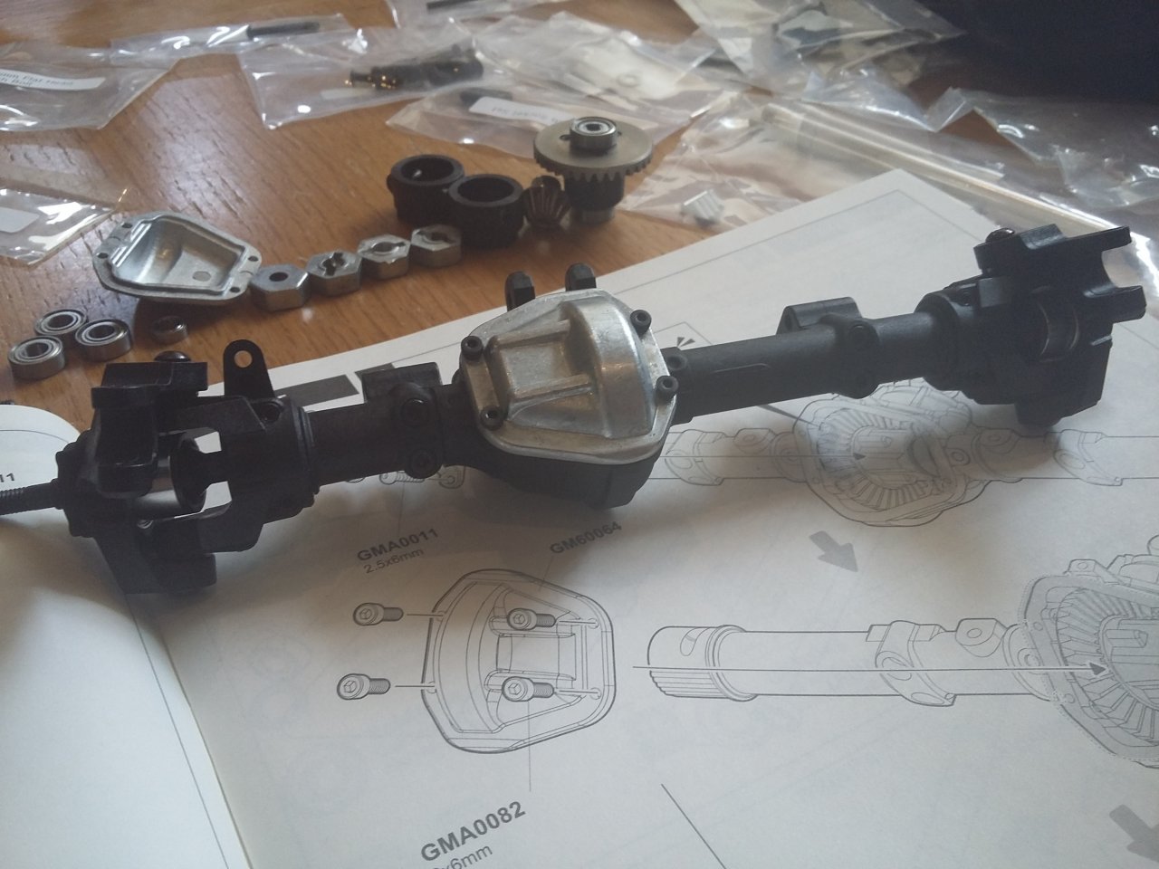

Mostly. I've found an issue with the input universal joint that I'm using on the rear axle. This might also be the cause of the slightly rougher action of the rear axle.
Anyway, the universal joint seems to have come out of manufacturing imperfect (some rough patches, bits sticking out a little, non-straight edges), and is binding the driveshaft. It was completely locked-up and unusable, but I've spent a while filing, sanding and drilling the imperfections away. It's nearly there.
Apart from that, the kit has been lovely to build. I assume my issue is a one-off. I've found no other evidence of this, online. Neither with Komodo, nor Bom.
Sounds like a one off. Both my axles and transmission are smooth.
