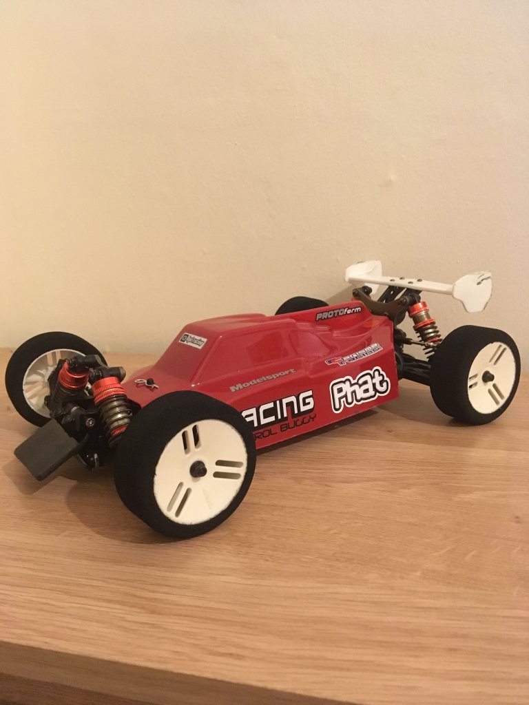

Yes it will, 2838 motors are used in them most of the time I'veseen 2850 emb truggy motors in them also, 12mm hex you can use 1/10 touring/drift wheels, essentially runs the same as the emb-1 buggy this is my lwb buggy it is the same size as the lc12b1.

I modded mine to relocate the motor into the front section.
Can just about squeeze a 2850 in but i run one of the 2838 Tenshocks.
Doing this meant i could fit 2 lipos in (ive tested it on 6s and its withstood a few speedruns so far) 👍
Edited by pieman5

Looks great, from what I've heard the out drivers are rather soft. Do you reckon that will be an issue?
It seems to handle the power ok.
I have broken one outdrive on it, but that was during a really bad high speed crash. That and a slightly bent shock tower was the only damage.
Nice and strong lil buggy in my opinion :)
I know the out drives can wear quite badly over time on the emb's and that's on 2s so they must have improved them on the lc12b1's which is needed.
Running on 6s will test the whole drive chain and if it is holding up then it shows how good they are, it must be flying on them, what kind of speeds are you getting.
Fastest so far is just over 94mph, but ive done 92mph with it on 4s so clearly some tuning/testing is needed.
