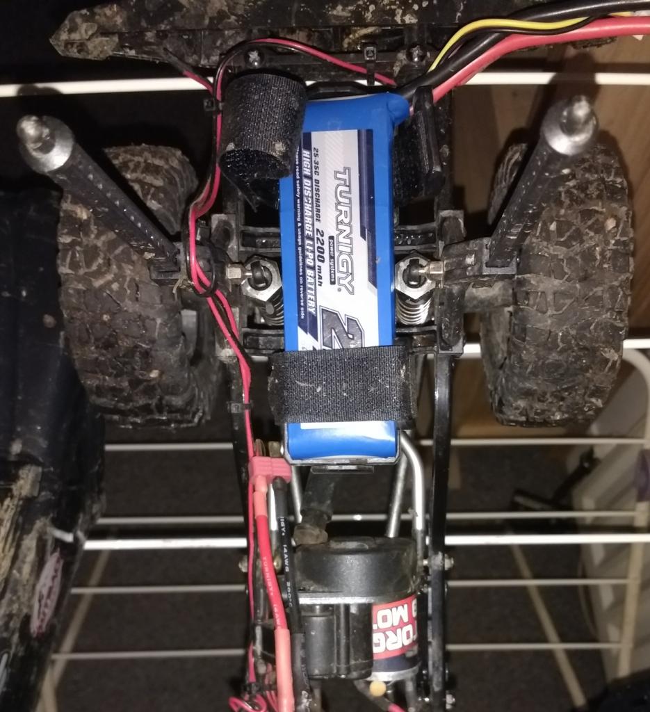

I have changed over to Li-Po batteries and got these from Ebay
http://www.ebay.co.uk/itm/271733898294?_trksid=p2057872.m2749.l2649&ssPageName=STRK%3AMEBIDX%3AIT
Mine were 27 quid for two with free postage. Luckily I already had a Li-Po charger.
Fit perfectly between the shock mounts and seem to last for over an hour.

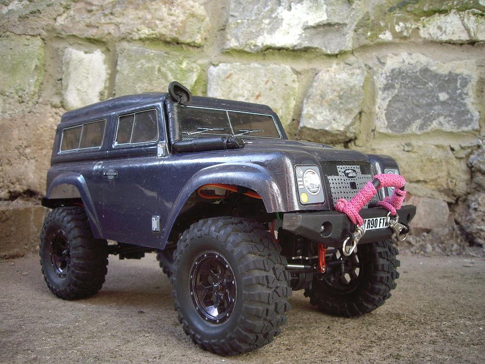

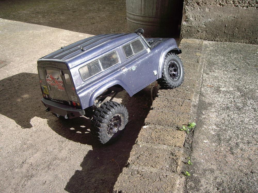

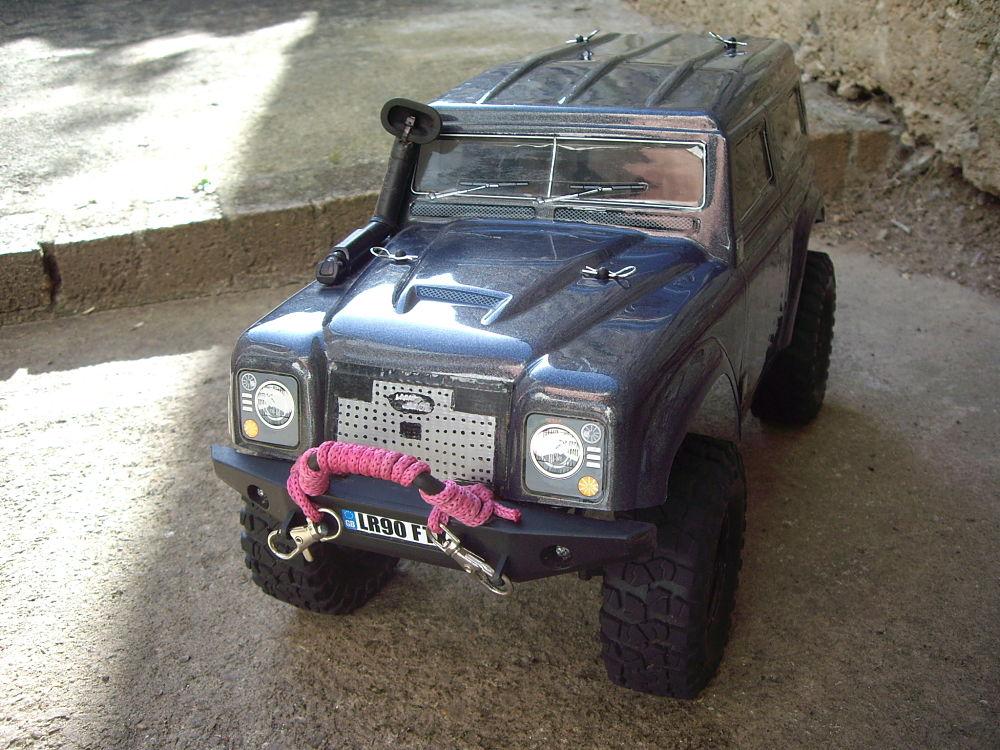

Here is my FTX Outback Ranger. I have done various bits to it: the standard axle wideners, moved the battery to a new mounting system (diy from take away box), put on a snorkel, tow rope, new grill and split screen windscreen to make it look more like a scale series (IIA?) Land Rover (would have to be a series with custom fenders and bonnet), coloured the wheels and removed/added some stickers. Also Turnigy servo and an alloy servo horn. 60 weight shock oil (not filled right to the top).
Further down the line I would like to upgrade to a 540 motor (in the hope that it won't run so hot and hence that the motor would last longer? - I have burnt out one of the stock motors already). Also, I want to get the alloy knuckles as the plastic ones bend sometimes and the steering can stick. I also have on order these: http://www.ebay.co.uk/itm/4x-N10138-3cm-Aluminum-Hex-Drive-Extension-Adapter-For-RC1-10-Off-Road-Car-Black/182450351732?_trksid=p2047675.c100005.m1851&_trkparms=aid%3D222007%26algo%3DSIC.MBE%26ao%3D2%26asc%3D43782%26meid%3D40bd68fb7f224b39897bad473b6c8553%26pid%3D100005%26rk%3D4%26rkt%3D6%26sd%3D172524430949
as the axles just aren't wide enough for the wheel size to be stable sideways IMO. Would also kinda like to a do a pan hard set up...
Edited by Gert Nang
