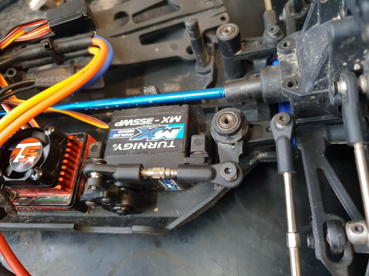

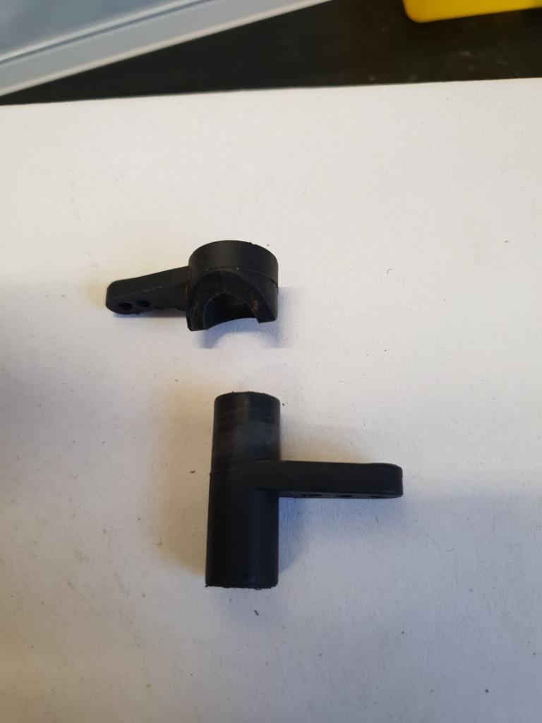

As mentioned before i wanted to get rid of that stupid original servo saver as it is so porly designed, that it should never see the production...
One problem is that the seat for the e-clip doesn't have enough material around it...and that plastic gets chewed pretty quick. Another thing that i don't understand is, why is there no bushing on the top, beside that the hole is way too big for the post. A lot of freeplay on the steering comes from there... and this is my first step in the project of making steering better.
You can see on the pictures what i have done. It eliminated 60-70% of freeplay on the steering...
I took the steering lever from the left (one you get in the bag with the new servo saver) and top part of the old servo saver. That part i drilled with the 10,2mm drill so that it is a tight fit on the other part, grind it a bit and put on upside down. I think it is clear from the pictures. I glued it with 2 component epoxi glue and it is strong as it would be from one piece...
I installed bearings instead of original bushings and that is it (4 in total for both sides). Very simple.
I bought and mounted the direct servo saver and it works with no free play on that part of the steering! The only problem i have is, that i bought a servo saver that is way to soft... but no problem, will order a new one, stiffer. In the meanwhile i will take chances and drive without servo saver...

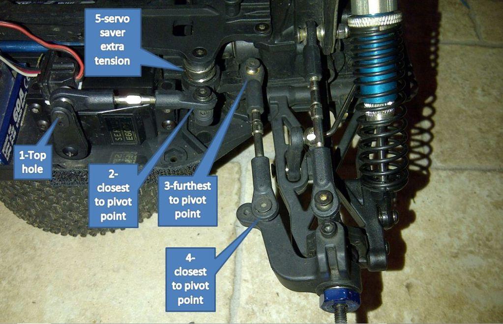

As for the steering, yes there is some slop in there. I found moving the locations of the links help with a lot more steering and a stout servo. The stock chassis allows a huge amount of flex though.
The attached image shows I set the steering up.

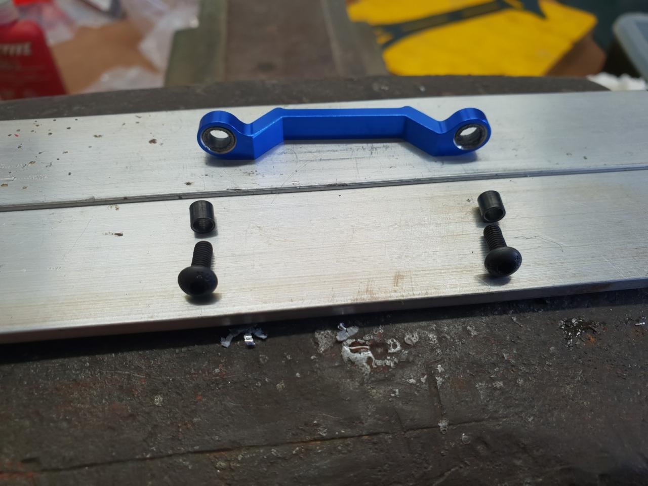

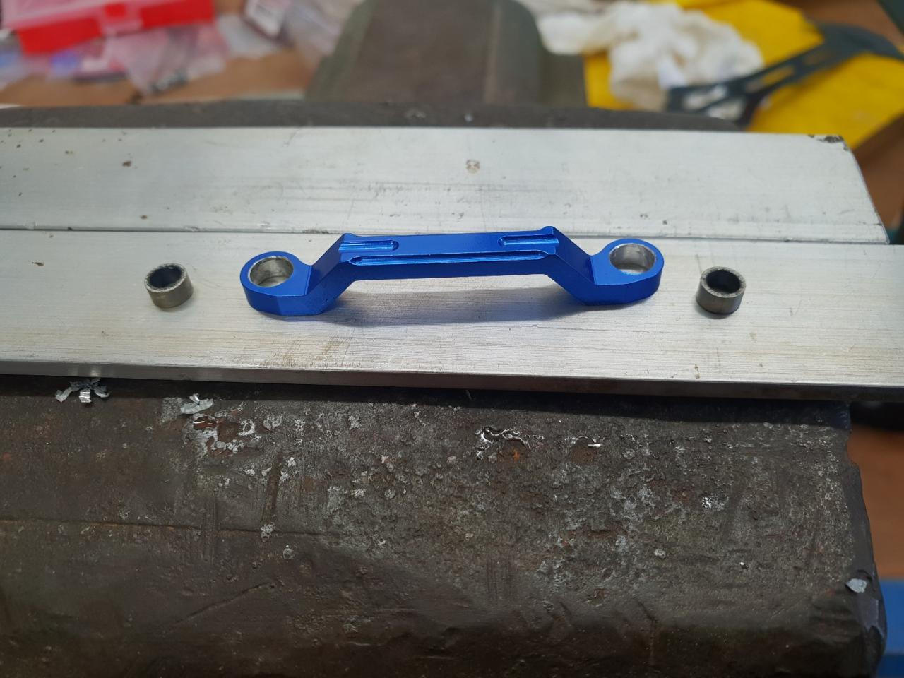

The ackermann design is really poor as there are no bushings, so i did a quick and easy modification. I higly recomend this as now i have zero play in the that part of steering (together with the servo saver modification that i did earlier).
I drilled the holes to 5,5mm and pressed SF-1 0403 bushings in there. Just for better feeling i used some loctite for bearings. The bushings are 5,5mm OD, 4mm ID and 3mm long. They have PTFE coating inside and will last forever. One bushing costs 0,40€...
The original bushing/spacer from the plastic ackermann has a surprisingly good tolerance on the outside diameter and is a perfect fit for it. Now I can fully tighten the screws and everything runs smothly without any sticking and free play.
On the future the plan is to put the bushings also on the outer hinge pins as a lot of play comes from there...
