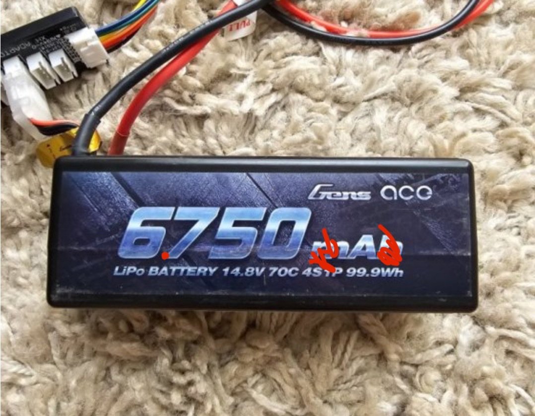

Asus27 Posted April 22 Share Posted April 22 Morning all. Does anyone know how many amps I can select when charging this battery? No other information is on the battery but the charger (rc-d100v2) can go upto 10amps. Got it on balance charge after running flat, set at 5amp see how it goes. Just don't want it blowing up lol Quote Link to comment Share on other sites More sharing options...
wombat Posted April 22 Share Posted April 22 Hi, I would charge that at 6.7 amps, 1 Quote Link to comment Share on other sites More sharing options...
Stormbringer Posted April 22 Share Posted April 22 as above 6.7 amps is 1c Quote Link to comment Share on other sites More sharing options...
Asus27 Posted April 22 Author Share Posted April 22 No idea why that's the answer but thank you. 👊 Quote Link to comment Share on other sites More sharing options...
Stormbringer Posted April 22 Share Posted April 22 1c is the capacity of the battery in amps so a 4000 mah battery charged at 1c = 4A your 6700 mah at 1c is 6.7 A hope that helps Quote Link to comment Share on other sites More sharing options...
Asus27 Posted April 22 Author Share Posted April 22 6 minutes ago, Stormbringer said: 1c is the capacity of the battery in amps so a 4000 mah battery charged at 1c = 4A your 6700 mah at 1c is 6.7 A hope that helps If I'm honest, no lol. Never been good at this stuff. I know it's not pure maths but I'm not very good with numbers, why I'm skint all the time 😂 The charger saves the settings so at least I know the experts say 6.7a is alright. Its current balance charging it, what would it be as a fast charge. The same? Thanks again for the info guys Quote Link to comment Share on other sites More sharing options...

TommyC Posted April 23 Share Posted April 23 No maths involved. Just a decimal point 1 1 Quote Link to comment Share on other sites More sharing options...
Asus27 Posted April 24 Author Share Posted April 24 🤯 Wow. Nice one mate. Quote Link to comment Share on other sites More sharing options...
SimplyChunk Posted April 24 Share Posted April 24 On 22/04/2024 at 11:44, Asus27 said: Be careful. your XT90 isn't fully inserted here 1 Quote Link to comment Share on other sites More sharing options...
Asus27 Posted April 25 Author Share Posted April 25 On 24/04/2024 at 19:30, SimplyChunk said: Be careful. your XT90 isn't fully inserted here No worries dude nice one. It's normally in a case but I'll make sure in future 👍🏻 1 Quote Link to comment Share on other sites More sharing options...
