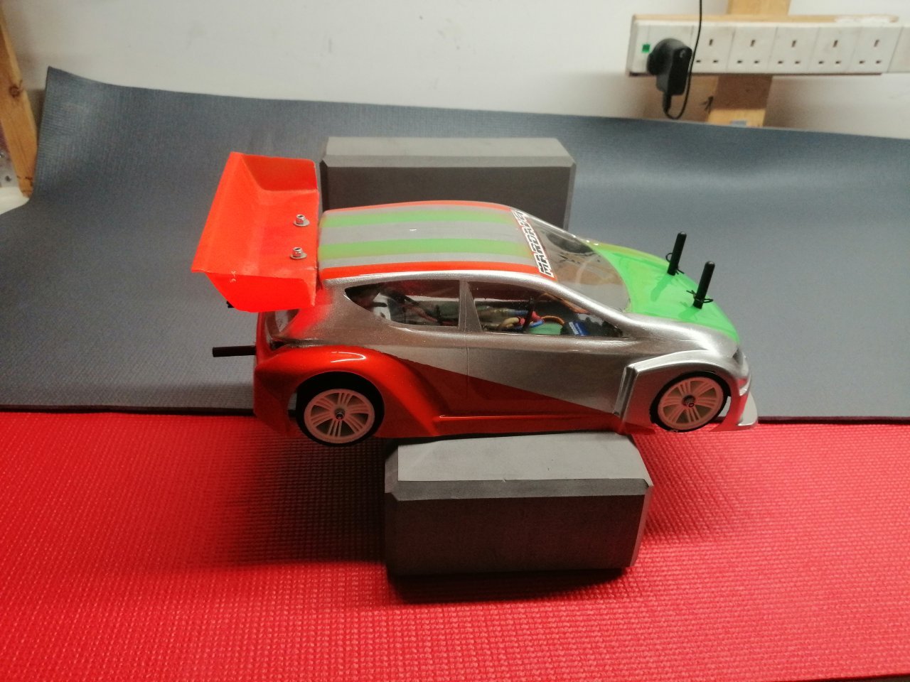

This was painted in both tamiya and core paints and it had no reaction (the orange is tamiya and it's backed with the metallic core RC silver
1 hour ago, Captain Courageous said:
That's a heck of a big bucket on the rear there Fred!
Standard mardave hot hatch wing to keep the back end down 🤣 the raw power from the 4.8v battery needs it 🤣 but it does look smaller in green than orange 🤔
