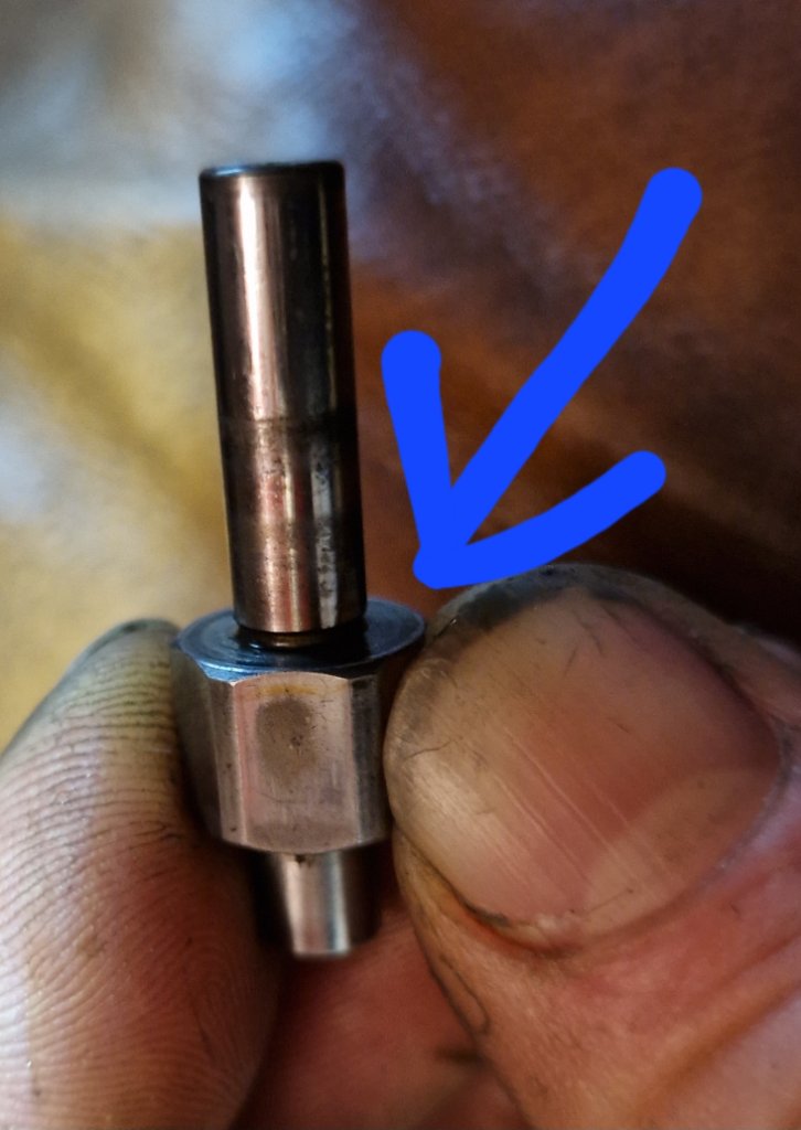

Is the starter shaft supposed to have a o ring on that groove in the image

Buna/nitrile. Let us know if you find a source that has a range of sizes suitable for carb needles.
