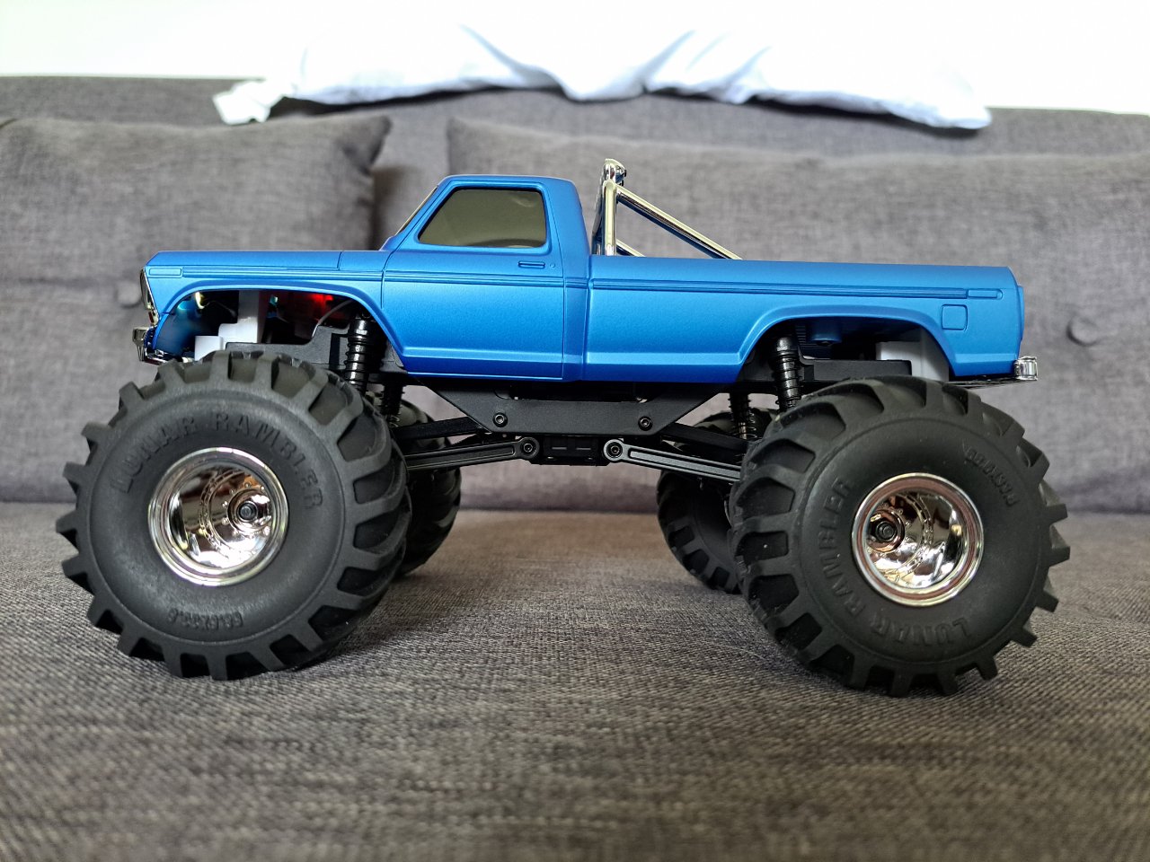

The injora tyres are about 6mm less diameter, but almost half the width! It doesn't change the look as much as I thought it would.
Diffs are now locked, and the shocks are oil filled. Feels like a downgrade going to plastic diffs, tho.

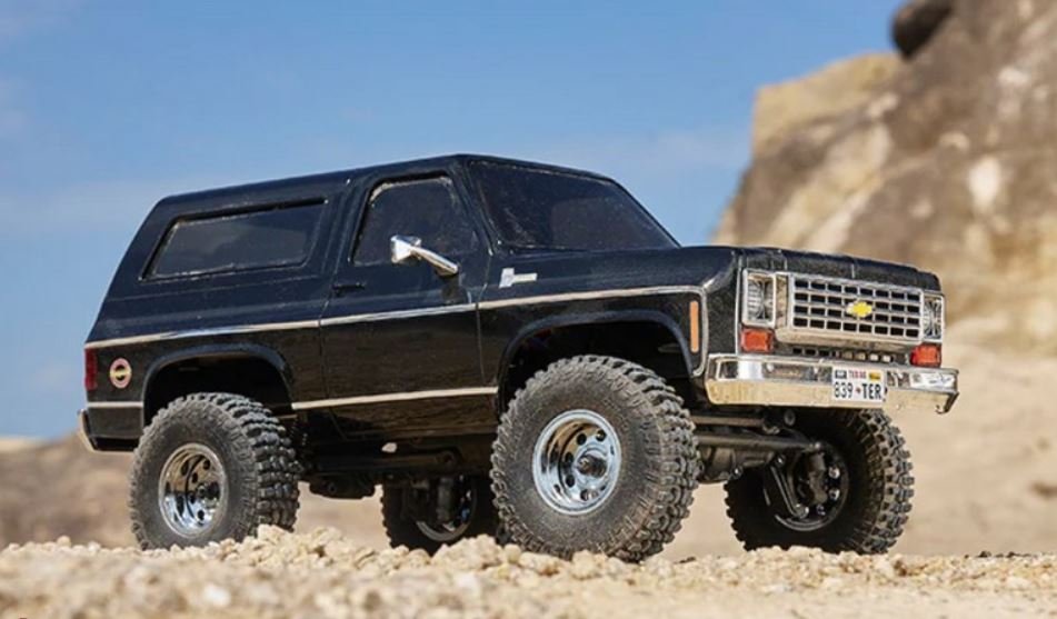

I think you can get metal diff parts from Treal but not gonna be cheap, those tyres look nice on the smasher. My K5 Blazer is delayed next estimated delivery date is June 19th but that may slip again, i am going to order a second mini crawler maybe a hobbyplus trail hunter 1/18th Unimog but also like the FTX outback mini Texan, but that wont be as capable
Decided to put a second small crawler on hold as the K5 should be here in 3-4 weeks, so spent more at Injora, Brass steering link set, Brass rear portal covers, so that's all the Brass I really want to add, also grabbed a set of the new Trekka tyres and set of deep dish ofset wheels
i took the smasher out in the woods this evening. it handled itself pretty well, although it quite likes flipping onto it's roof, and the monster truck tyres don't have a lot of grip. i might have to invest in some extra weight, too.
I need to work out how to video while driving. getting up those mossy rocks was a battle!
