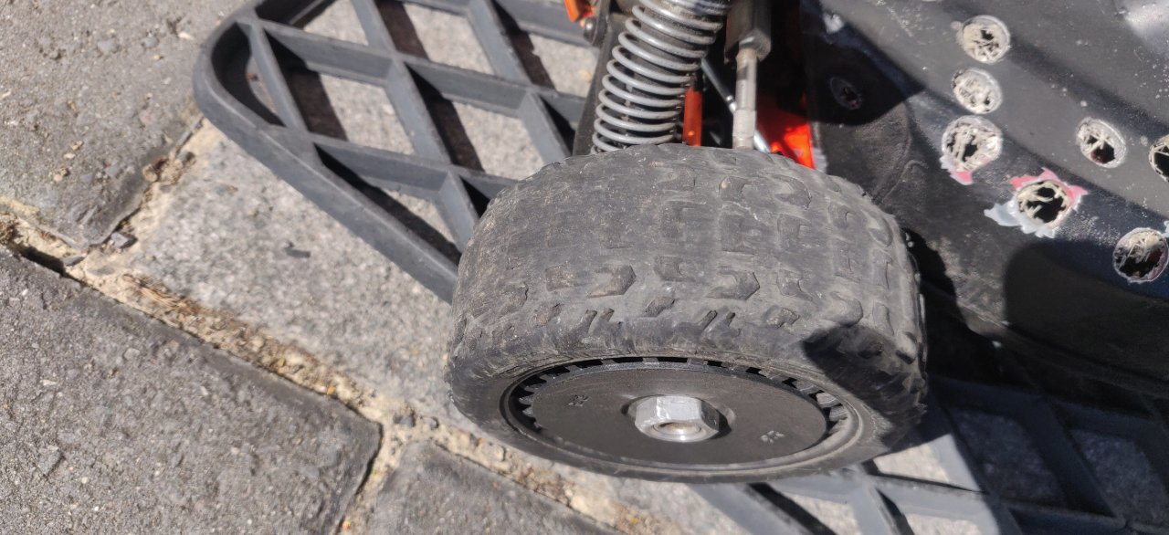

Where were you when I needed this advice? 😂 Nah in all seriousness, I started my journey on 3S and that was a hoot initially...
4S is definitely the sweet spot unless you're going to be running belted tyres and faffing about for each type of terrain, then 6S is your friend.
RIP Arrma Katars, you served me well for one 6S session 😉 okay may be I'm being a little dramatic there's still some life in these...I dare not use them again until I meet some grass.
Luckily I bought these from a friend for way under retail, had these been purchased at retail...
Edit: these are a great set of wheels.
IMG_20210417_144924.thumb.jpg.9c810472ec9007cce68adca5fd94bd59.jpgIMG_20210417_141650.thumb.jpg.0b66588d79e509a806ea391a849c00a7.jpg
