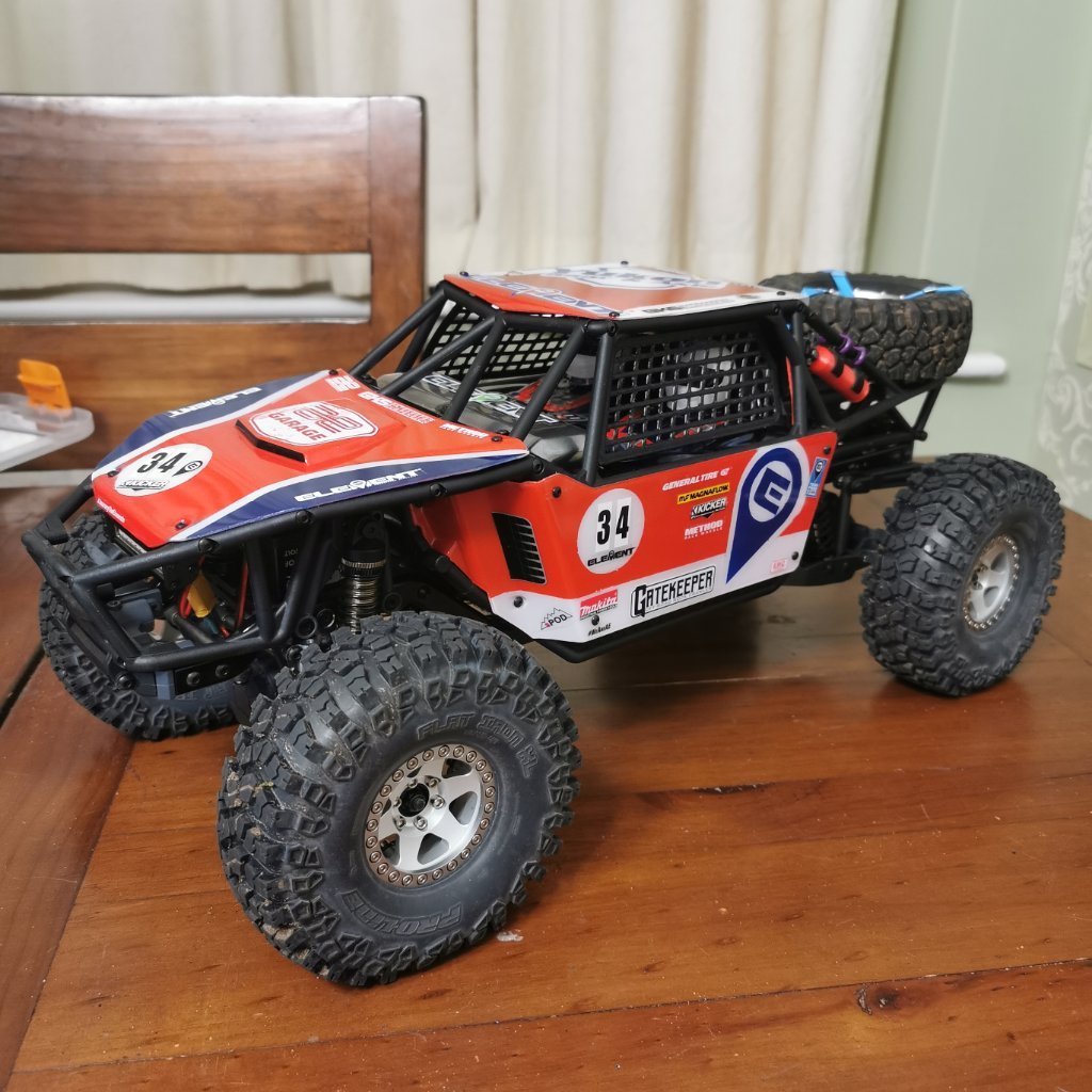

Also put the Gatekeeper on some quite small 2.2s, because I had the rims spare, I actually quite like the look, not sure how good these cheap tyres will grip, perhaps need to find some a similar size that are better rubber.

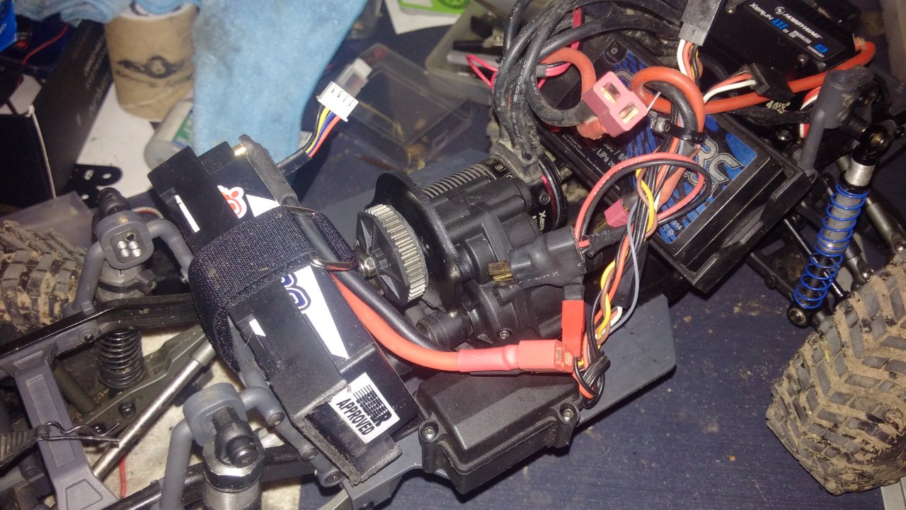

As the gatekeeper doesnt have a slipper and small dp spiral cut diff pinions and spurs the weak point is the diffs, I modified the transmission slightly with a 40t axial spur and some slipper gaskets on the stock enduro spur plates, shaved the back one down a bit as it was binding on the pinion.
Is now rapidly quick on 2s and slipper slips nicely when expected, hold the truck down it will slip anyother time it bites.
Also cut down the spare battery tray to hold a 2nd 3s lipo battery just to power the insanely strong servo needed to shift the ifs kit with deep dish wheels.

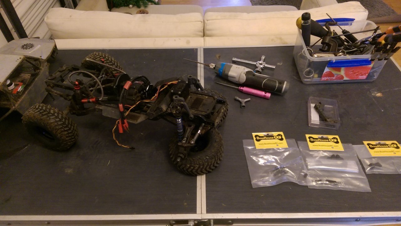

"Ele" is back on the bench getting some much needed fixes for the wonky IFS.
Great quality products from bowhouse, should make a big diffrence, cant wait to test em out.
