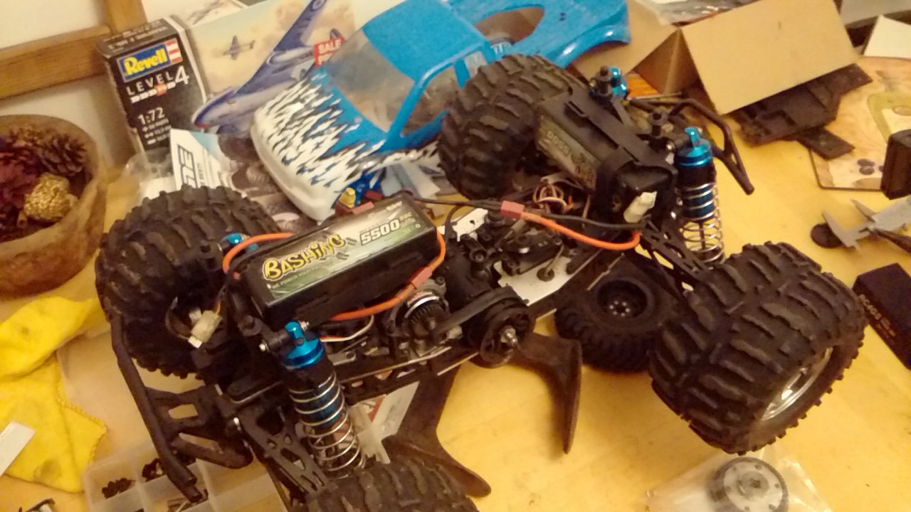

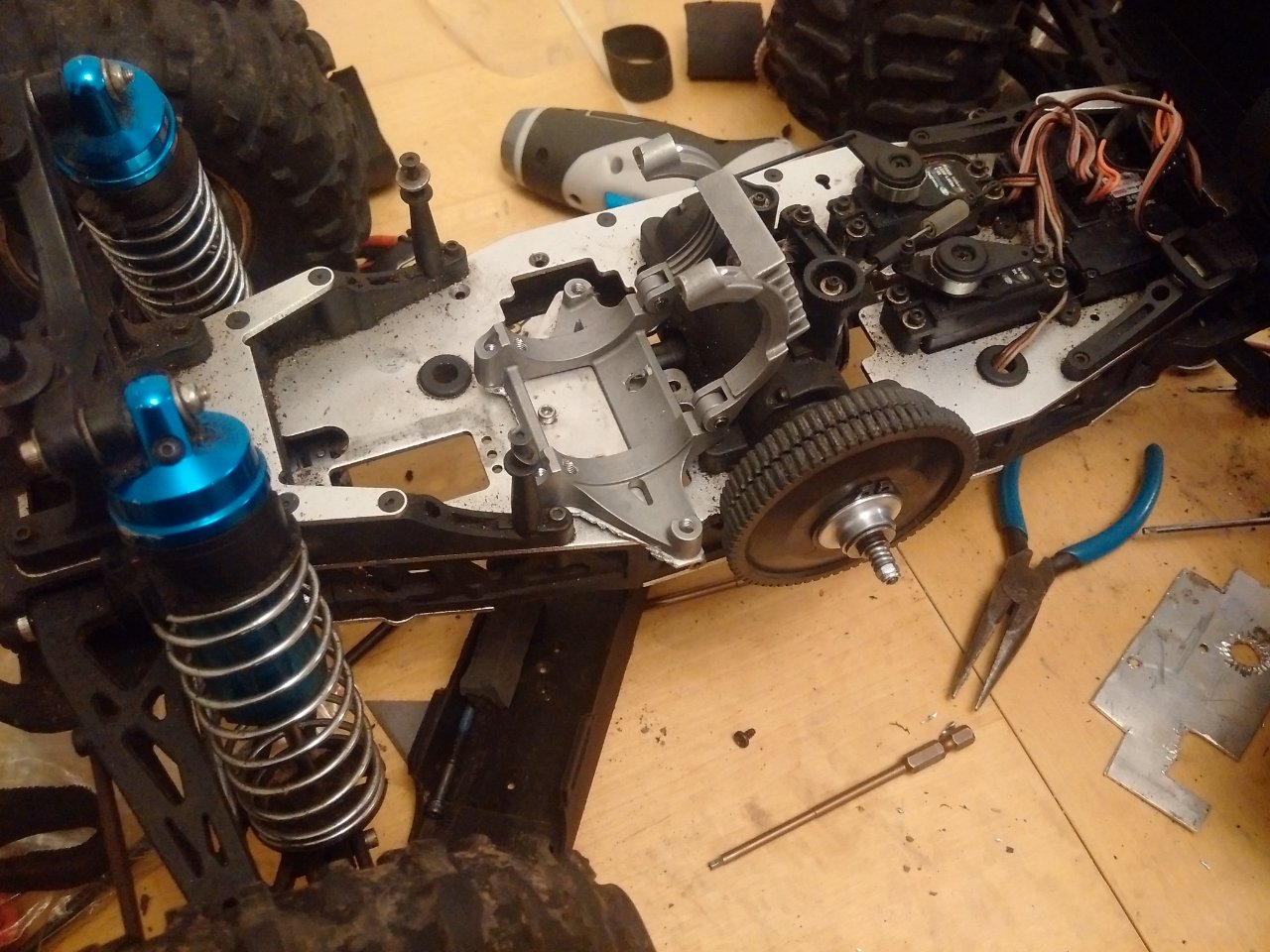

Popular Post Redback Posted May 14, 2021 Author Popular Post Share Posted May 14, 2021 (edited) Hello I'm back and decided to lightly modify it to brushless, nothing fancy right now just testing the water so to speak, dont want to break the truck so being realistic this is just for fun and to allow me to run it around the house, etc... Thanks for looking maybe it will go up for sale if so you can see whats been done to it before you buy. As I refuse to drill this chassis I started by prototyping a mount that fits with no new holes needed. Its also belt driven right now as i had issues getting this bodge mount to mesh with any pinion, thus a very odd solution that seems to work for now, I'm hoping to make a neater mount plate that adjusts along with keeping the belt drive system as its sounds very cool. Battery trays affixed to the motor mount cooling plate right now, esc fits snugly were the fuel tank used to go. Current pinion & spur setup a 14t pinion driving bike innertube tire belt onto a 1.9 wheel. 🤔 Bodgy belt drive testing. Obligatory testing video. Edited May 14, 2021 by Redback 4 Quote Link to comment Share on other sites More sharing options...
Redback Posted May 15, 2021 Author Share Posted May 15, 2021 Belt drive kept failing so easy option for now was a big pinion and move the motor mount that really was the wrong choice. Will look into another solution that gives me some options. Esc fits snugly behind. Cant mount battery sideways due to shocks, on the motor mount again. Sounds horrible due to the heavily worn spur, should bed in and smoothen out pretty quick. Testing 34t pinion. Things going to shift! VID_20210515_003345.mp4 Thanks for reading. 1 Quote Link to comment Share on other sites More sharing options...

Redback Posted May 15, 2021 Author Share Posted May 15, 2021 Thank you very much Tom, sure is a keeper now, as its running the nitro transmission, it has the manual servo reverse and the manual breaks mixed in. So still drives and feels like its nitro, with far more punch and low end control. Its a very heavy truck so amazed with how it shifts. Surpised me for the size of the pinion, motor ran cool and got about 15min run time from 5000mha 3s, Running video. Good fun, loads of power can pop a wheelie at 50%, nitro couldnt wheelie, just loved to roll onto its face. Not going to fiddle with it any more for now, runs like a dream for how its put together, wont be run or bashed much due to rarity of spares. Just nice to have her running again. Motor/Esc can be dropped out easily as its home is usally the hyper 7. 2 Quote Link to comment Share on other sites More sharing options...
