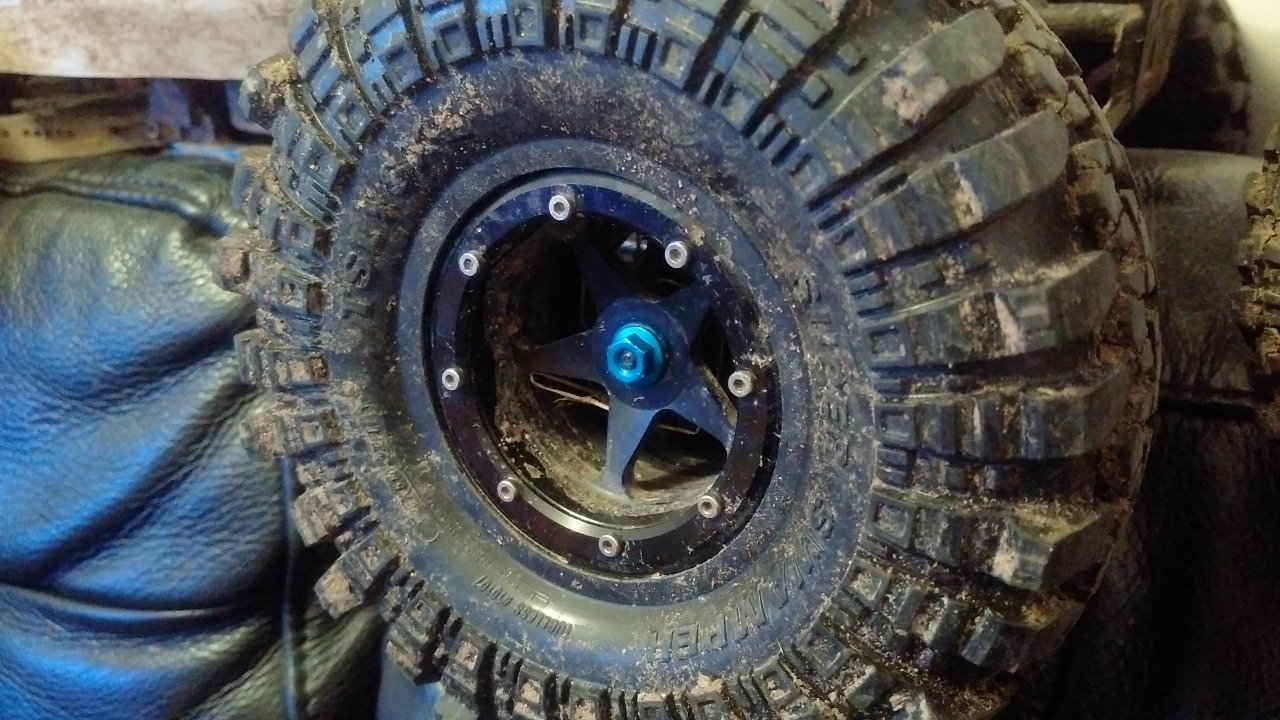

Got my wheels to finally fit, as i use axial wheels i need special axial wheel hexes how annoying. Then the wheels rubbed against the steering arms so filed those down. Finally need very thin wheel nuts as I have 0 thread remaining.
Getting big wheels for the outlaws has been a nightmare, wish i just spent the extra and got a set of ftx outlaw alloys would have been cheaper from the start.

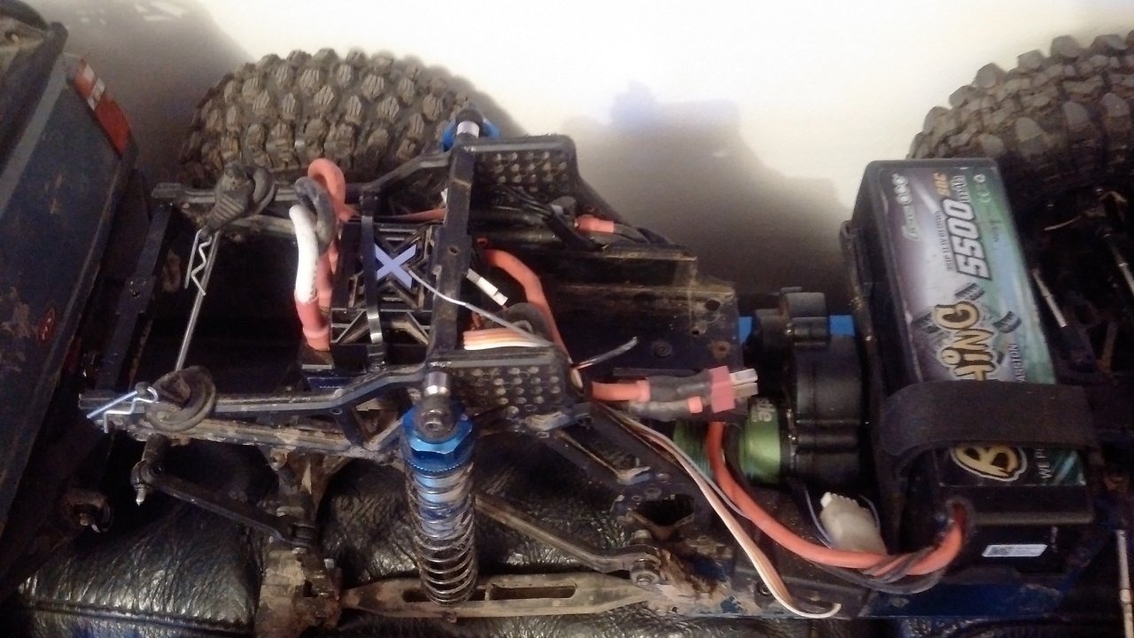

Picked up a set of battery bars, used them to stiffen up the rear, stiff as old boots but still got enough flex that things wont snap.

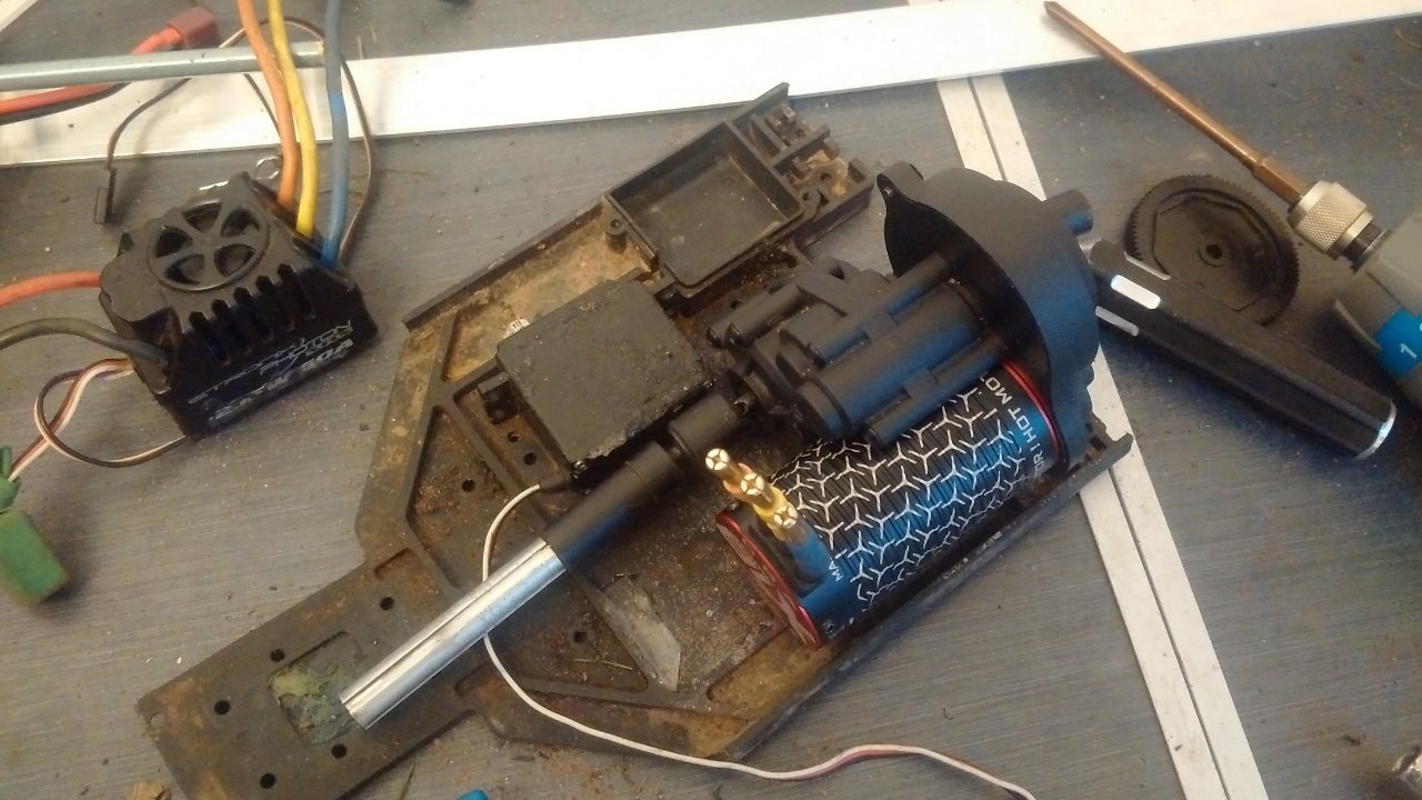

Really wanting some front over drive, i went back to seeing if i could mount the element enduro stealth x transmission in again.
Got it to fit in better this time, cut some metal to fabricate the mounts.
Positioned everything, seems to fit well, drive shafts are pretty inline. Floating motors going to put some force on the motor plate, hopefully the center brace will help keep the motor from bending the motor mount.
Moved and cut the battery bar, limited battery room now, will be intresting issue to solve.
I want to flip the sevo around and move the mounts so it takes up less space, what a space hog.
Will also make fitting the R1 G1 transmission easier without having to work around the servo.
