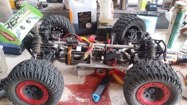

What about a plastic chassis? 10mm thick nylon based chassis? Gotta be better than the stocker? 🤔
22 minutes ago, Tug said:
OK, let's call that a fail.
That's some serious hours in r+D to get plastic to hold up the weight during landings and cartwheels...
I once used 8mm thick riot shield grade polycarbonate to make a 1/6 chassis... Which also used truggy running gear...
Was a blast... But did I jump it... Not really... Only a few mild sends from the wife driving it.... The sheer weight would of destroyed it... I too used tower to tower bracing... As the chassis flexed like mad without it.....
It was slow compared to a 1/8 truggy... But good fun.... I built it for a few hundred... 🤣...
Its funny.... As I see a lot of similarities with the large kraton.... Fun for flatland... Bit risky sending it.... All came back to the weight.... Its the weight that's the killer during bashing imo
One could try a composite/sandwich plate, not unlike the Losi XXL2e. Two metal plates, with a composite plate in between. Would get pretty heavy though.
What could be more viable is simply looking at where exactly it bends (so far, most bends occur yet again at the two thin parts where the shocktowers mount to the plate) like M2C did (their chassis for the 6s isn't just different material, it's also wider at the spots where the Kraton usually bends) - and then do something like Losi with their 3XL.
Losi-LST-3XL-E-4WD-RTR-Monster-Truck-2.j
No need to make the entire chassis 10mm thick, you just need to reinforce the spots where it bends (at the shocktowers). That could be viable.
Yes, but Arrma really shouldn't have released it like this. Most aren't going to send it Talbot/Duperbash/RCDude style, but I've seen bending occur from frontal impacts too, not just ramping.

Can I ask if the chassis brace is hollow, I don't really get why it doesn't help, The Losi Muggy was notorious for flexing, Which it was, I put a length of solid bar front to back and know no flex what so ever.

From what I can gather, the brace isn't strong enough to stop the chassis bending, but it does cause stress on the towers.
