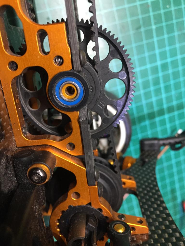

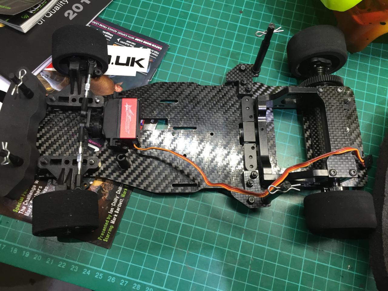

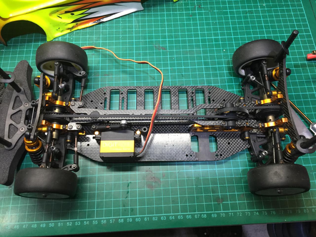

For both these two cars a Zen racing GT12 and an X-ray 2008 rubber edition, I need to modify the gearing for speed runs.  I want to run Mod 1 gears on both, but need to find a way of replacing the existing spur gears with smaller mod 1 spurs... appreciate advice from the collective please!  @.AJ., this was the question I had for you last Sunday mate..
overall chassis shots
How many holes is the spur gear attached by and whats the diameter between the mounting holes? I think its 6 on the T3?
best option would be a blank and using the stock spur and a pillar drill to get the hole in the right place for either car?
Steel spurs Mod 1, appear to be black and 10mm thickness which maybe a little thick, im just not sure what the bore would be? Cant remember if the bearing sits in it ona T3?

@GunsThe spur on the X-ray is attached by three bolts and it's approximately 13mm bolt centre to bolt centre.  No idea on the GT12, I will need to strip it to work it out...
Ive edited my post now, I remember them having 6 holes, mounted by three, just cant think if the centre hole fits onto a hub/bearing?
