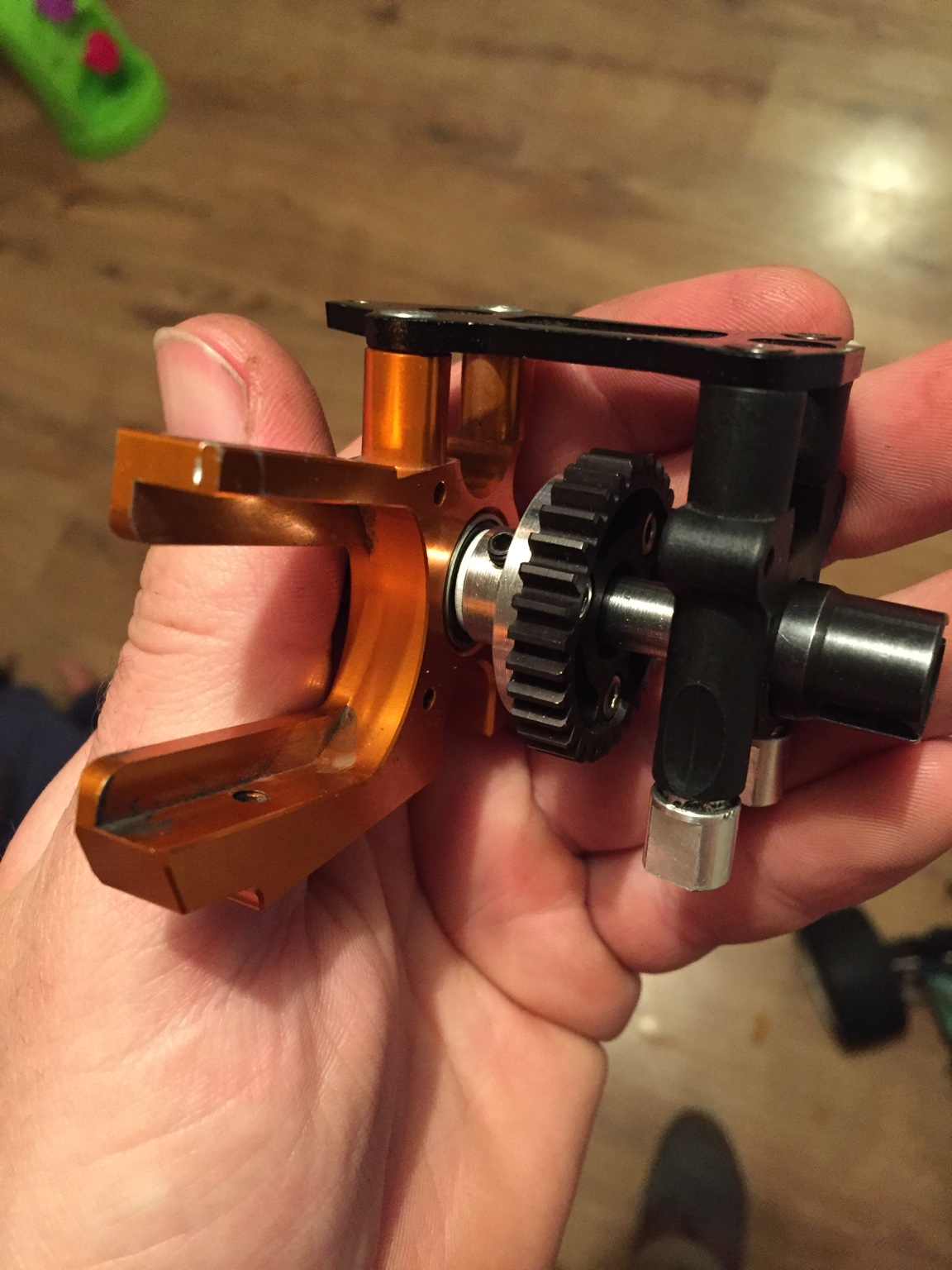

What you could do to open up many gearing options is make a centre spool to replace what is already there, depending on the bearing size on the centre diff you need to buy some shaft off eBay and make one of these
You can buy spur gear adapters off eBay that allow you to use from 32t-44t and they are available with 5mm/6mm/8mm bore
Edited by Wrighty8766
Thanks for that, I did notice that HPI and a few other have an adapter to allow for easy interchange of spur gears, the shaft diameter in the centre diff is 5mm - have just taken that out to inspect and to take measurements. It seems the same size as the 5mm mod 1 pinion gears so I might even get away with using a pinion gear and mesh with another pinion gear when I convert the clutch bell to run electric pinions - is there a name for that centre diff setup?

The next steps for this project is to mount the larger .28 engine in the stock chassis and then run it with a standard 14t clutch bell as I will need to break the engine in slowly to get the best performance before increasing the gearing.
I have a plate of aluminium coming and will be looking to extend the chassis backwards slightly (as the diffs and suspension bolt down onto the chassis) - will keep the front end stock and simply extend the rear slightly to accommodate the transmission. I will be mounting the HPI box sideways rather than vertically as the engine will be mounted to one side, there are OEM mounts on the side of the transmission which i can re-purpose.
One thing to note is that due to the light weight chassis this FTX went off like a rocket when at full throttle, it was faster than the heavier HPI Pulse 4.6 1/8 boggy my father in law had and I know that the FTX is geared to run at around 40mph @ 30k rpm.
