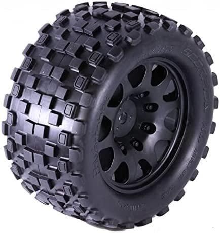

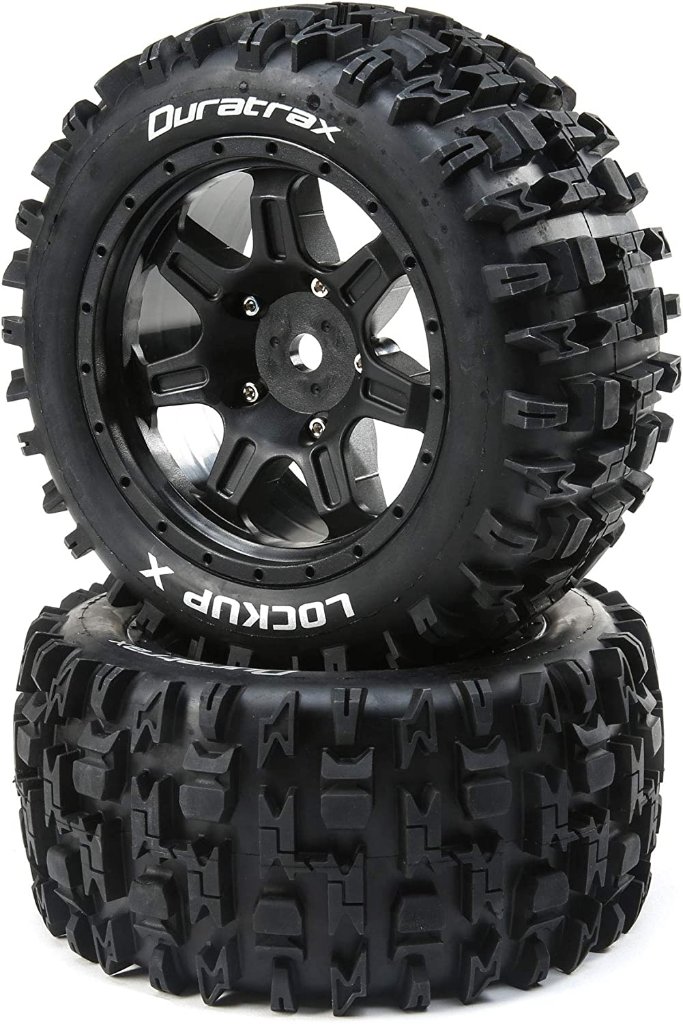

Anyone tried the Duratrax Lockup X belted tires (DTXC5501) or Powerhobby Scorpion XL belted tires? Finally blew one of my sledgehammers and was looking at these 2 since they're decently cheap, belted and lighter than what Pro-Line offers.

Stock X Maxx wheels weigh 610g
Scorpions - 784g
Duratrax - 793g
Proline Badlands (probably the heaviest on the market)    - 814g
Ether go stock or what ever else, because weight difference of others is 20-30g.

I ended up ordering a full set of the Duratrax. $60 a set is pretty good. Just trying to determine what motor I want to throw in now. I want to try the HW 4985 1650kv but I noticed is only rated for 6s max and I don't want to burn it out. I could go for the 5687 but I have a huge stock of pinions and spurs that fit 5mm shafts.

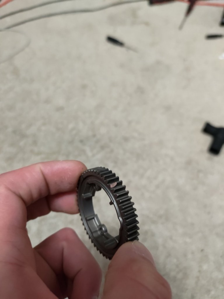

Nothing...at least I don't think so. I've gone through 4 of the 50T wideface spur gears (6448R). I keep seeing a chipped tooth. It's just a small corner of a tooth and doesn't affect anything but I'm starting to wonder if the motor shaft is a bit bent. I was looking at the HW motors because they're way cheaper than getting another 1200XL.

I have read that stock spurs should be one of the first thing to replace since they are made from some glued powder, but so far only teeth iv lost are in back diff ring gear - waiting for replacement atm 🙂

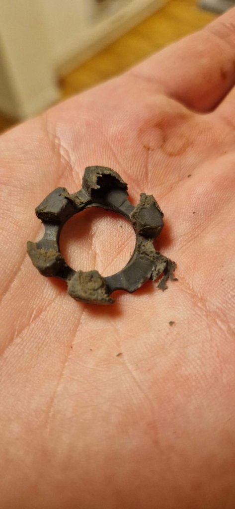

Have you tried removing motor and running it to see if the shaft is actually bent and wobles while spinning? Also - if shaft is fine and you are still loosing teeth from pinion or spur gears my educated guess would be to inspect the cush drive - its designed to save those gears.
