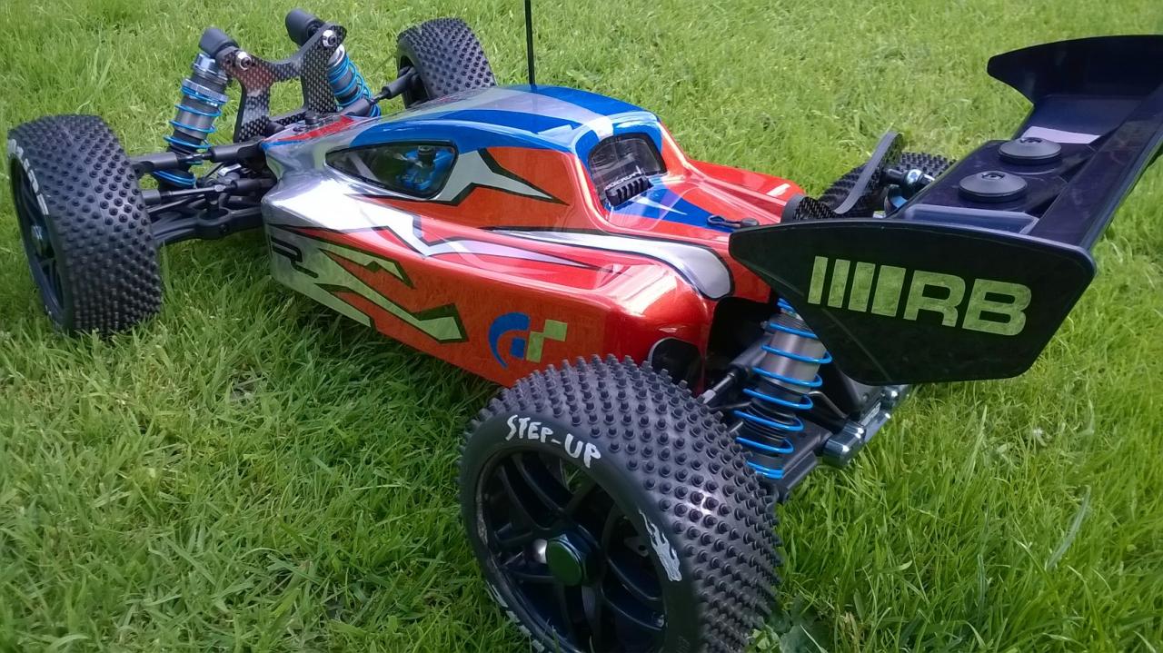

QRC Posted December 5, 2017 Share Posted December 5, 2017 Cut and painted shell, only had the kit for well over a year !! , Quote Link to comment Share on other sites More sharing options...

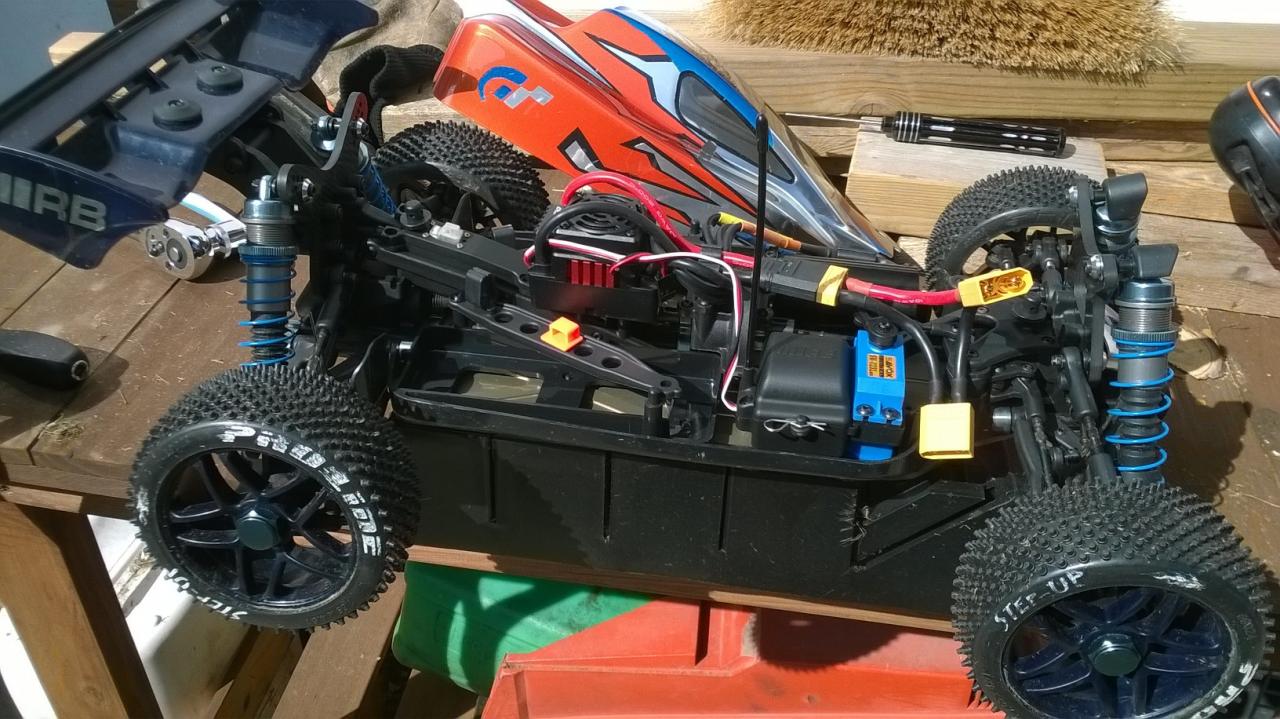

GazCle Posted August 10, 2018 Share Posted August 10, 2018 Finished this last year but forgot to post on here. Drives great cheapo 2650kv gives 41mph on stock gearing 19t pinion HW BL150 esc and that servo has been swapped for a JX Servo PDI-HV5932MG Coreless 30kg servo which is 25.2kg 0.12 sec/60° @6v BEC output. Has anyone found out which other Steel spur's fit the Center diff? HB D812 has been mentioned as sharing some design with this buggy, my plastic spur is fine no problems so far but only running 4s on the 2650kv motor . PS this thread has been very useful cheers all for the info ``o=o¬ RCYAL8R Servo link https://www.banggood.com/JX-Servo-PDI-HV5932MG-30KG-Large-Torque-180-High-Voltage-Digital-Servo-p-1074872.html?p=JW2206639952201406ZT Quote Link to comment Share on other sites More sharing options...
