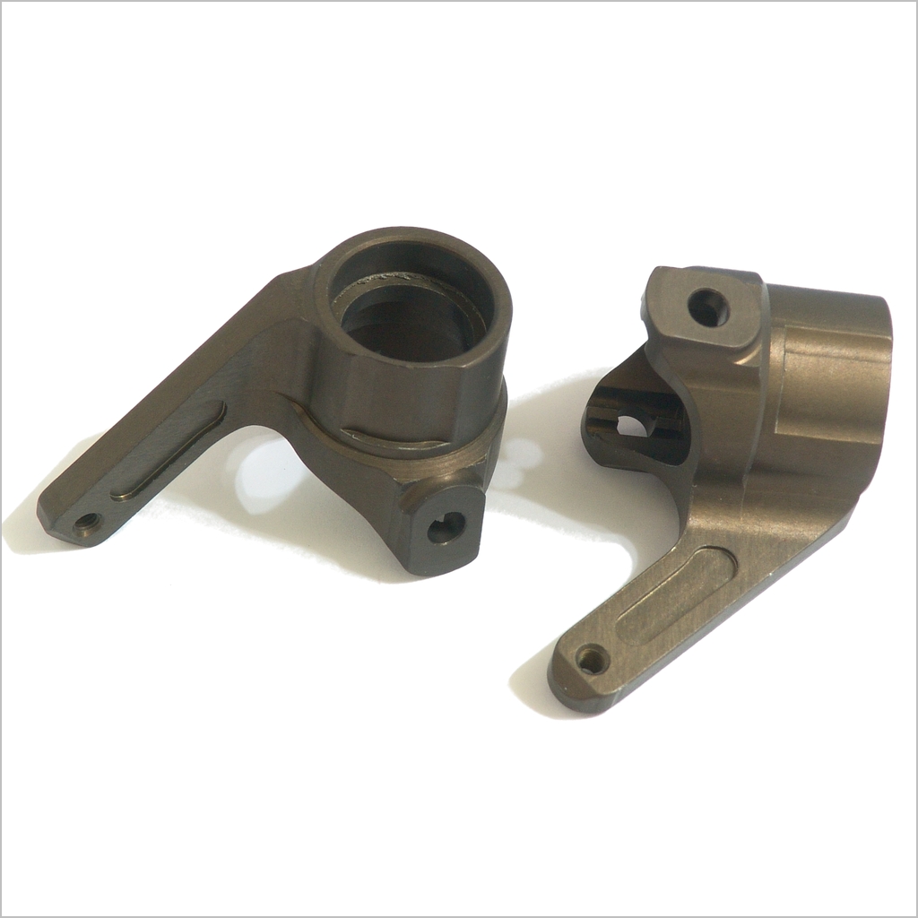

Broke the C hub and the bottom of the steering knuckle is fully stripped now :( Also my new shiny wing mount didn't last long, snapped the wing and the mount. :P
6 hours ago, Nickarla said:
I’ve seen a few threads on other forums where the thread on these steering arms have stripped. Should be happening for how much they cost.
I've not seen many - usually where the screw had started to back out then pulled through once it lost enough contact.  Threadlocked and checked periodically I've managed fine.
If you don't want to risk it again the solution is hong nor X series pro knuckles - they use a captive kingpin
https://www.ebay.com/itm/HongNor-X2-CNC-Steering-Knuckle-Arm-Hard-Coated-X1S-07-RC-WillPower-/311375452167
Image result for hong nor x1s-07
I still put a nut on the end of the screw on the end of the arm though.  Ignore the eBay price, if you want some to try i've almost certainly got some bnip / used ones.  Have a huge stash of HN parts and things never break.
Everything breaks. No matter how much it cost ?. This was probably user error tbh. it's not like they cost me anything because they were on the car when I bought it, but of course I have to replace them now.
Legend, yes they screws have backed out these before, so they were already weakened.
If these fit in the hyper St C hubs and you have some spare then pm sure!
56 minutes ago, Jumper said:
Yes I give it some stick. Mr dumperbash ain't got nothing on me! (because he normally lands the right way up) ?
I'm 99% certain they're a straight swap - I'll check but it may be next weekend at the outset - it's end of term at work so extremely busy.  Drop me a PM too or I will forget....If I get an hour to look through before easter hols I of course will - did you want bnip or used?  I'd need to check £ but new will obv be a little more.

That would be a lot of effort (assuming it even worked well enough with no binding etc) when you can just do the HN mod and know it works 100%. I had them on one of my old H7's and it was good to know it was fit and forget. Just needed to Dremel out a small notch in the c-hub for the nut and I was good to go.  Having said that I still have the hobao CNC knuckles in one of my other H7s and touch wood I've had no problems though I do check the screws every couple of runs.
The exact same problem occurs on my Ruckus and Blitz who both use rpm knuckles, soft plastic so never break compared to standard ones but always stripping out ?
On 02/04/2019 at 22:53, Nickarla said:
Could the knuckle be filed down to allow a small nut in?
I've heard of it being done - must have been extremely fiddly as tbh there's likely to not be much hub material left - so solving one problem to create another weak point.
tbh it doesnt need anything to retain it other than threadlock. The issue with mine is from when it was damage the first time it came out. The knuckle on the other side has been fine.
