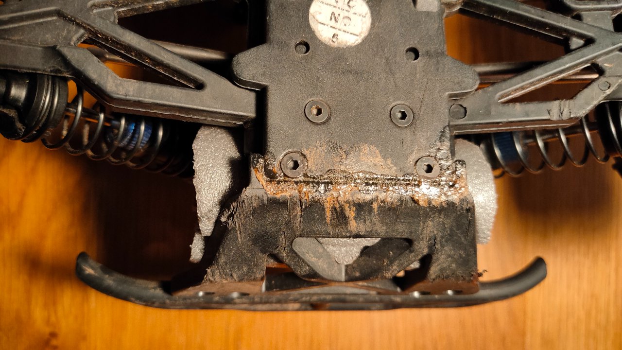

In all honesty, if your boy has managed to break the chassis/bumper, then I think more speed will only make matters worse.  You mentioned money at the end of your post so I think you will see increased running costs if you put more power/punch behind the trigger.
But having said that, I think that Surpass BG combo rocks, I have bought the same from a UK ebay seller and paid twice that price.  Bear in mind that the combo has a Deans connector so your batteries will need a Deans connector too  (think adapters)
Good luck

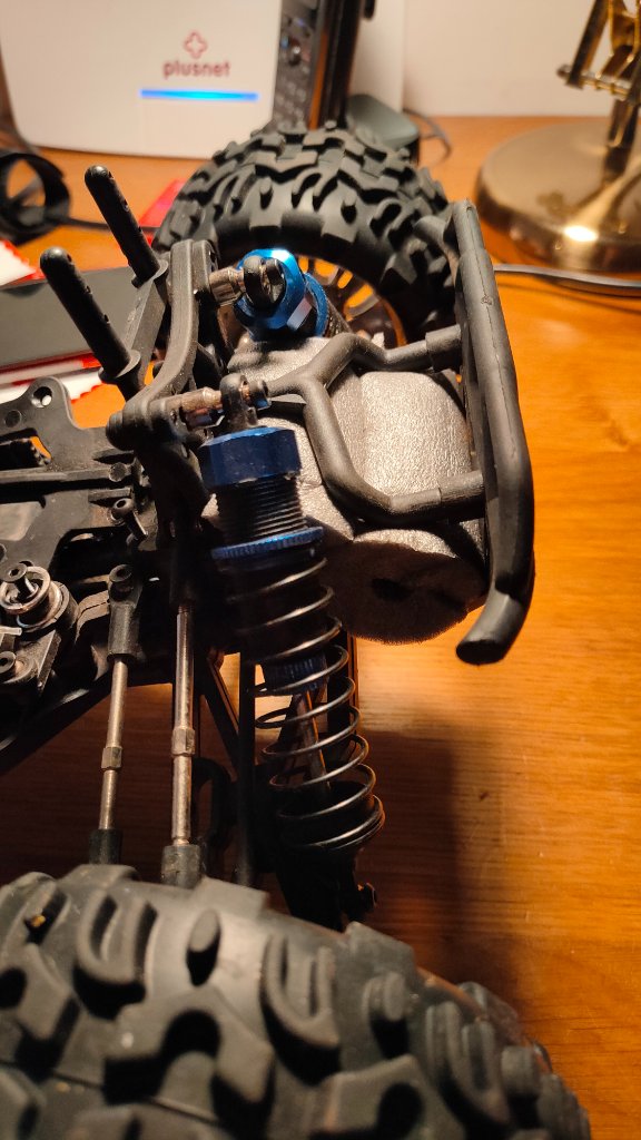

I think that mod is brilliant, is that a carnage 1? I think the 2 is slightly different at the front end or I am looking at the pics wrong. I rebuilt it like below and attached a big piece of grey lagging foam behind it, to help take the impact but it snapped at the same point at the bottom where the screws go onto the chassis so I just slapped a load of glue all around it and tightened up the screws, seems to have worked but saying its not driving anywhere at the moment can't really see if it works.
This also looks interesting
https://www.ebay.co.uk/itm/Brushless-GoolRC-Upgrade-Waterproof-3650-4300KV-Motor-60A-ESC-Combo-Set-X6E5/402289930418?ssPageName=STRK%3AMEBIDX%3AIT&_trksid=p2060353.m1438.l2649
and a few reviews mention that GoolRC motors are good and I wouldn't have to wait and wait for it to arrive.  I think I will also need to upgrade the spur and pinion gears into cast metal ones though.  https://www.modelsport.co.uk/rw-hardened-acetal-ftx-65t-spur-gear-vantage-carnage-banzai-hooligan-bugsta/rc-car-products/432730 and https://www.modelsport.co.uk/rw-6-pinion-17-teeth/rc-car-products/13756
Do many of you change the gearing sizes? Like those blue lower suspension parts in the pics Iain R. Yep I can see I am already falling into the trap of wanting a lot more than I need but if it gets my boys also into building things then why not.

My son has a Brugsta Brushless (practically the same).
So far I upgraded the wheels after the old ones disintegrating after too many puddle runs.
And I put some effort into waterproofing the car.

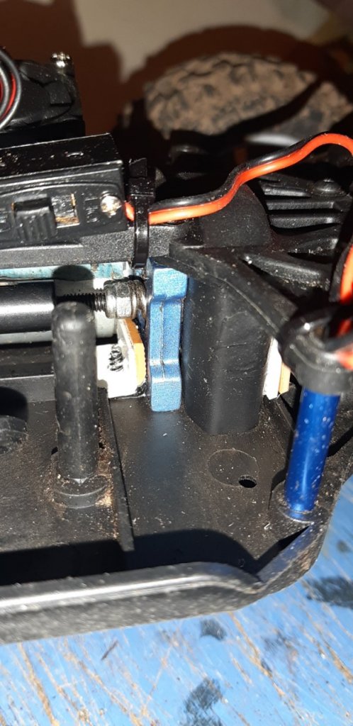

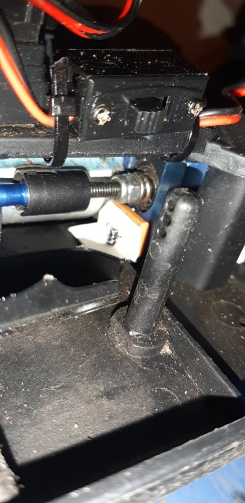

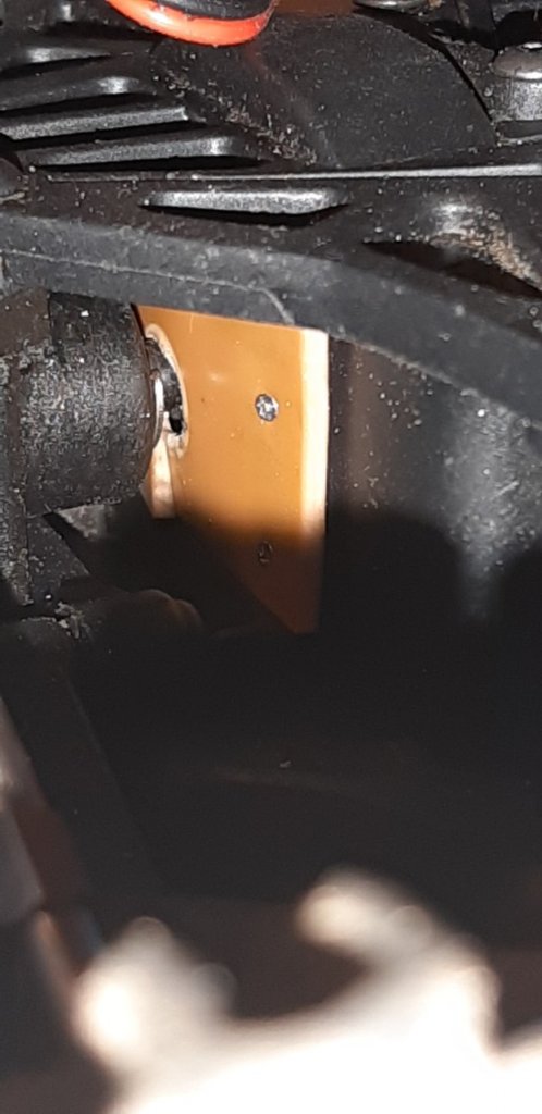

13 minutes ago, Iain .R said:
Hi I know from a few vids on the tube that the carnage an it siblings  have a design fault

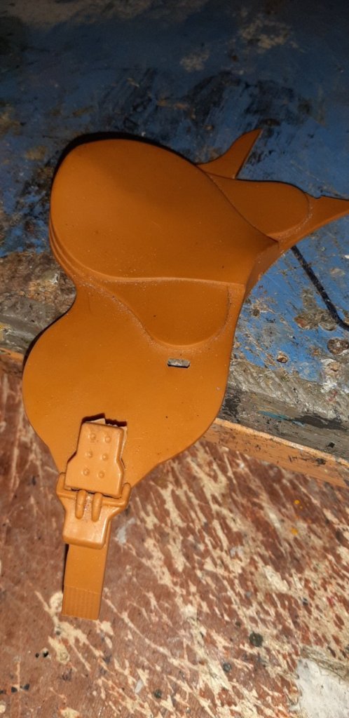

 The spur gear is open to crap/wee stones getting in to the wheels/cogs . So last night I came up with a wee idea of blocking these . One was the spur gear cover
I fixed a small rubber cover  (small bit of rubber from sindy dolls saddle) to the open section cut a hole in the rubber  then cut a line up the centre to the hole then fixed the rubber   to spur gear cover using very small screws   (watch screws)
Then the front part where the motor braket is the hole at  the  bottom  so I got a small L shape plastic then cut a small bit rubber to fit the one side of the L shape then used liquid electrical tape to make a small square blob  once it was almost set pushed it in to the hole in the motorbraket  then fixed it in place with some liquid tape and a screw. So now my super gear is all sealed up and still able to take apart to chage spurs .
That's an excellent idea to a very well known problem.
I used hot glue layer by layer.
I also read about a 3D printed solution for the motor bracket.
Others just use tape.
It would be interesting to design 2 3D models to cover the front and the back and put it on thingiverse.
For the latest models it seems that the gap in the motor bracket has been closed by the factory.
It might be worth to get the new motor bracket as a spare part.

I am waiting on a part to fill the motor bracket  from a member ... but for now this will do .
I was going to hot glue it but as the chassis is made of oily plastic theres not many glues that stick . There are ones I use which is for waste pipes  say under your sink  as they are oily plastic to stop crap sticking to it . The glue melts the plastic more than glue it .  Well I'd say 70 melt  30 glue
But as the car going to be going over bumps and so on didnt think it hold .  Why put in a wee screw ..
If they changed the design might be worth buying it   what about the spur gear cover any change to that . As there is a massive gap compared to the shaft .
I just had look and yes its filled only on one side    but still its blocked off   the ! spur gear cover   ! on the other hand it's still the same .
It's very easy to block up with like a grommet idea.  Or two  peice  half circles closing the gap.
But I'm happy with mine  lol

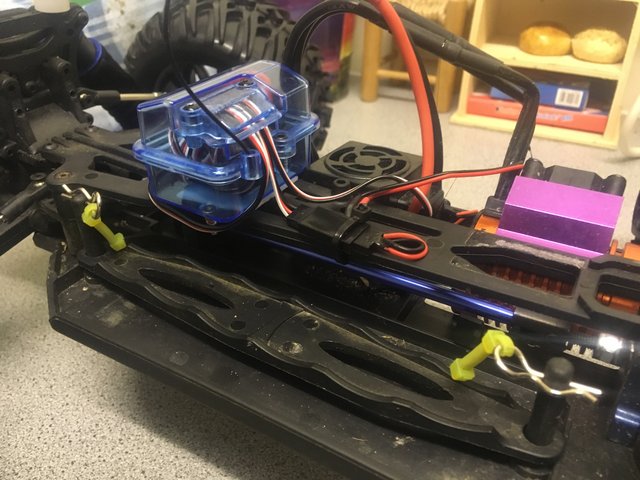

I did some waterproofing on my new Brushless Carnage.
Filled all the holes in the "waterproof" ESC with liquid electrical tape.
And fitted a waterproof receiver box.
Next car ready for puddle bashing...
I like that box. Is that one of these https://www.ebay.co.uk/itm/Waterproof-ESC-Receiver-Case-Box-for-1-10-RC-Car-Short-course-Huanqi-727-Slash-/265014822181 we did get snow into the shell the other day just hoping that we didn't fry the receiver! Oh well the engine is in route anyway from eBay here Friday so will build it up over the weekend with a lot of extra waterproofing after reading all your comments.
Yes. That is the one. I bought a whole lot for all my non-Traxxas cars.
I did some additional work to waterproof it in a similar fashion as Traxxas does:
1. Silicone Grease on the O-Ring. Helps to repel water.
2. Small pieces of closed cell foam above and below where the cables come out. It sqeezes between the cables letting less water come through from upward splashes.
3. And put a bit of silicone grease between the foams where the cables are . That repels the last bit of water.
With such a fix I can go diving. No water will come in.
One more thing for waterproofing:
https://www.ebay.co.uk/itm/Liquid-Insulation-Electrical-Tape-30ml-Tube-Paste-Waterproof-Anti-UV-Fast-Dry/373357518921?hash=item56edd7a049:g:UUUAAOSwHHBfucW6
Liquid electrical tape. It is like liquid rubber but has an electrical insulation effect up to 1000V.
Flows easily between gaps. Use a brush to spread it around.
I filled every hole in the ESC with that and all the exposed electrical plugs.
It is basically the cheap Chinese way to insulate their cheap circuit boards.
