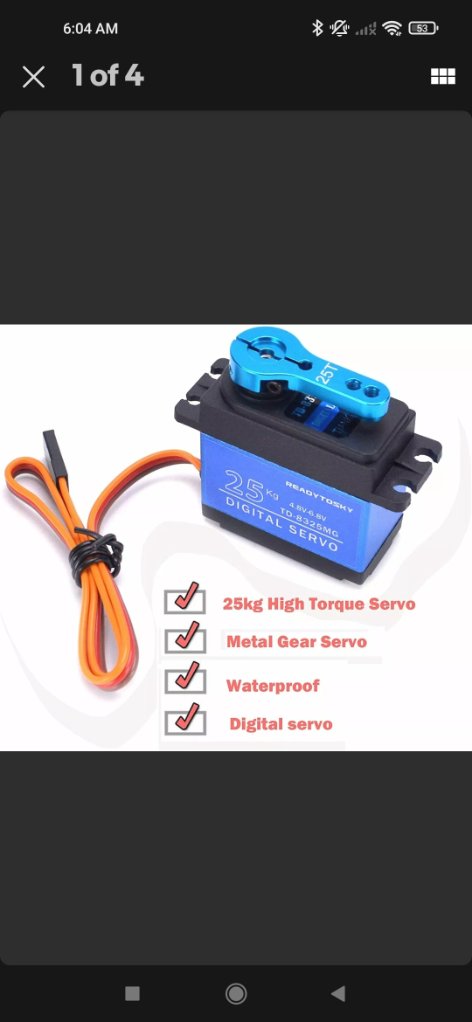

Hi guys would this be ok to use in the brushless carnage? Stock receiver and run on 2s most the time but do occasionally use a 3s
Will be fine - more than enough power in this servo to cope with the carnage.
a few things though; take a look at your servo saver, as the large ‘e’ clip that sits at the top and compresses the spring is always falling off which makes the steering awful, regardless of what servo is powering it.
The other issue I’ve had is when using 3s packs. The carnage is amazing fun with them, it’s just ridiculously fast. The problem is the truck can’t handle the additional strains and it WILL break something, especially if you haven’t upgraded certain parts. Hardened spur and pinion are a must for a start.

Amazing, cheers guys, iv got the hardened steel spur an pinion upgrade, stripped the nylon spur on 3rd run lol. iv seen the servo saver suffers with the eclip so already swapped for a washer. Snapped a battery support so ordered some ali posts.
