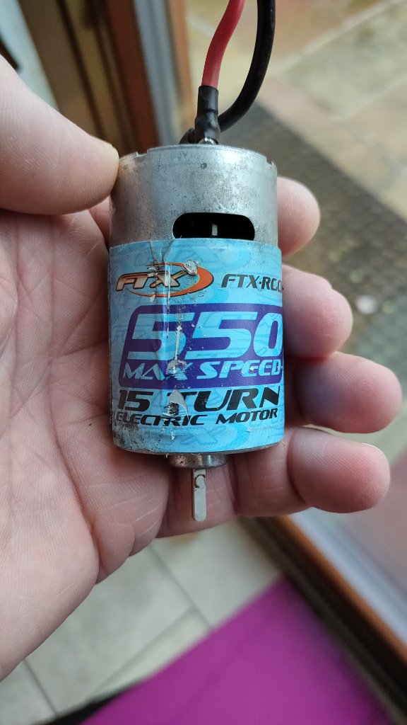

7 hours ago, Iain .R said:
The carnage motor   550   is that how many times the motor turns a minute???   Does any one know how many times the 550 motor turns / speed..  thanks
I think its 550mm long mate
It will have a much lower turn number. If you mean the stock brushed one I think it's only about 15 or 17 turn. It said on a sticker I think under the heatsink
550 is the motor can length, the speed or turns isn't relative to the can length. 15t is the carnage motor. The higher turn the slower the motor per volt but the more torque dense it would be.
Thank you  the part where it says  15 turns is ripped on mine soni just looked at my other one and i can see it  . Cheers
Not very fast turn then    mmm see why you guys change them . Ok  thanks .
Hi I just had a wee look.on u tube an the 15 it's the amount of wire wrapped around inside   goes round 15 times .
The speed of the motor depends on the power source/kv of the motor . .
I just wondered last night how fast does the motor spin    then adding the pinion  the large supr combining the 3 to get your speed.
It was just somthing that popped in to my head and ????????????? Which then bugged me  lol
I was having one of my pain filled nights due to.my illness which stops me sleeping then all sorts of crap pops in to your head just to divert from the pain .
Which once pain easys off  you dont think of the stuff again. .
Anyway  thanks .
[Note to anyone reading this, only 90% sure I’ve got this right, so please feel free to contradict me 👍]
550 is the size, (the length of the can?)
Speed is usually indicated by its T number.
T stands for turns, or the number of times the wire is wrapped around the rotor.
Generally the lower the T the faster the motor will spin, but the less torque it produces.
From memory, standard ftx motor is a 15T, a reasonable compromise between speed and power.
By contrast, my crawler has a 35T motor, really slow, but will pull up the steepest slope from a standing start.
Never as simple as that as you can increase torque or speed by adjusting gearing within reason, and not all motors are made the same. Got to say, not madly impressed with the FTX one but at less than £8, can’t really complain.
I put a 21T sport tuned motor in mine, and it was just as fast as the 15T ftx one but with an extra bit of torque..... but at 3 times the price. 🤔
