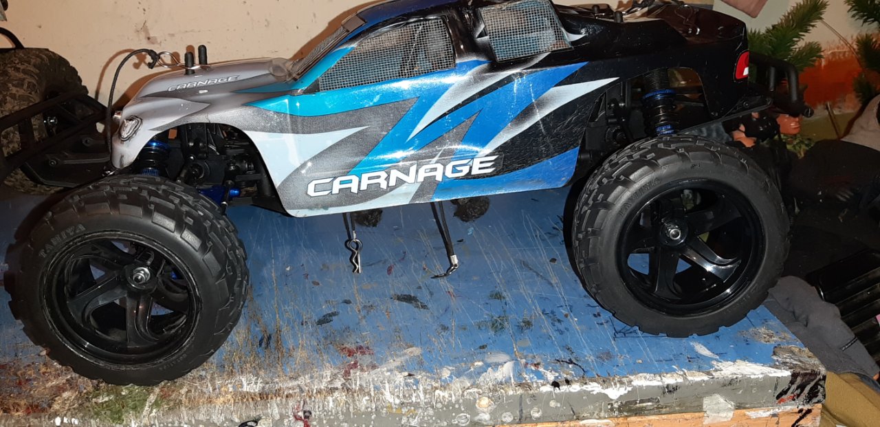

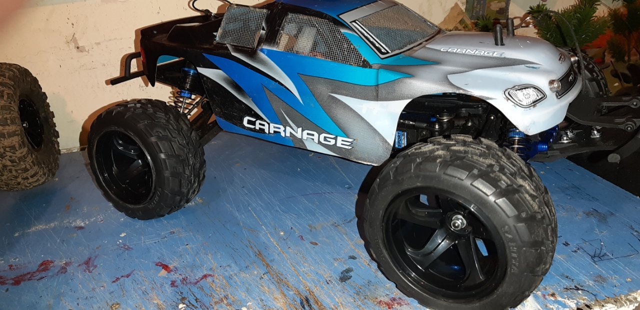

Does anyone know what size the  fome /inserts  are on the carnage .
As I got some spare wheels coming ( thanks man )  I'm going to sort my carnage wheels out  as there seems to been a bit of a gap  between the tyre/rubber   and the fome / insert on 3 of the wheels (I'm sure it 3 wheels why I think there somthing wrong)
So I'm going to de tyre the wheels and put in new fome /inserts  in my carnage wheels .
As the tyres are fine   no point binning them  might aswell fix .    Cheers

The stock insert are somewhat rubbish.
Esp. if you are often going through water.
Mine turned into a undefinable mass and the wheels ended up totally unbalanced...
You can measure the size according to the outer diameter of the rims and the diameter of the wheels.
This is what I did and I am highly satisfied:
Get Armacell pipe lagging with an inner/outer diameter matching the wheels.
Armacell is closed cell foam and it will not soak with water.
And that foam is strong enough to prevent the wheels from ballooning at high speed.
( don't get the wrap around version, the glue will not hold )
Well I sorted out my new wheels and had a go at taken the old carnage tyres off the wheels using the heat   ..! NOPE !!  Not a chance.  Mmm so tomorrow raiding my  mrs nail polish  to see if that will work . .
After washing the wheels an  cleaning them    they are flat   might just end up buying new carnage wheels . .
Aceton will help.
Hi all you carnage owners any of you taken the tyres off the wheels . If yes was there inserts in there  and what size did you replace them with as  I found   you need  2.2 truck inserts . £13 a pair .
Hi all . Back to me wheels I contacted FTX and asked them what was best to remove the tyres off the carnage wheels and they replied   !!! YOU DONT   there not to come off !!     Oo ok   so I explained that the wheels are very soft and when they on the car when the car is on its wheels 2 of them look like there flat tyres on a real car when you have a puncher .
So they asked how old the car is and where was it sold  so I told them dec 18  and of rc geeks .
So they are interested in the wheels as from the sound of it they say the inserts have disintegrated  which they not heard of before .
So how long do these tyres suppost to last . As we all know real tyres anything over 12000.
So if there a time set for RC tyres . As I mean they just test these before they sell them or the makers of the tyres must test them so they can sell them to FTX ..

Of course they come off!
And they don't last long.
1. Stock Bugsta wheels: 2 months bashing, few puddles included, inserts disintegrated, wheels unbalanced.
2. Replaced with Carnage wheels: 2 months bashing, many puddles included, inserts disintegrated, wheels unbalanced, some rubber came off the wheels, looked inside, undefinable mass on one side.
3. Rustler wheels: Lasted 4 months, then same as above.
I ignored the advice that came in the Rustler manual:
Punch 2 holes on opposite side in each wheel.
After each run, spin the wheels to get all the water out.
( Manual didn't say that you need to wash yourself and your clothes after )
But now I don't care, since all cars have new wheels, my special inserts and they are completely sealed.
