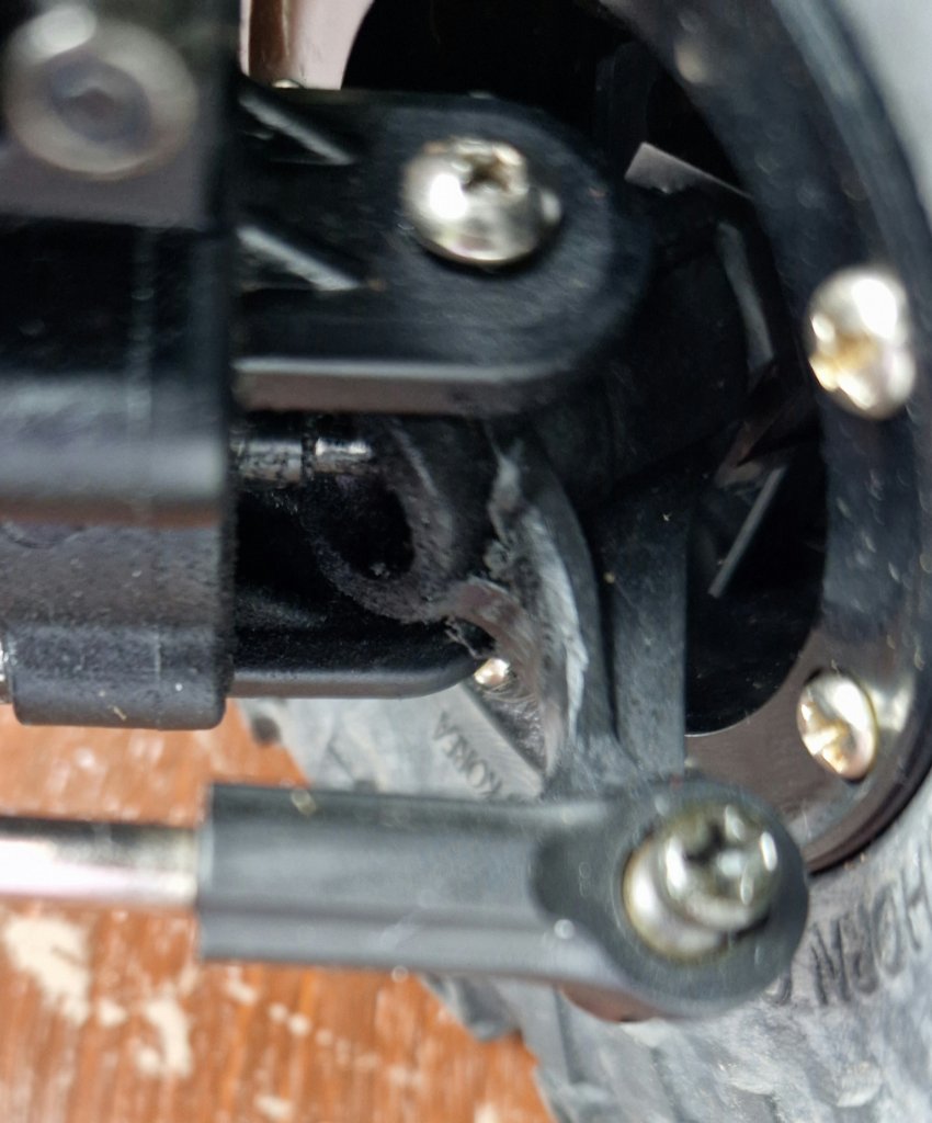

Dremeled down the steering knuckle for more turn

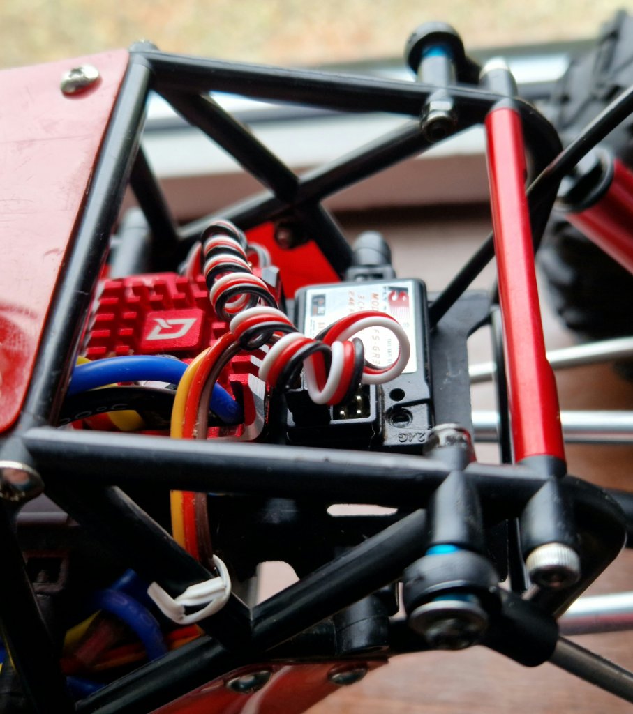

Electronics relocated to the rear

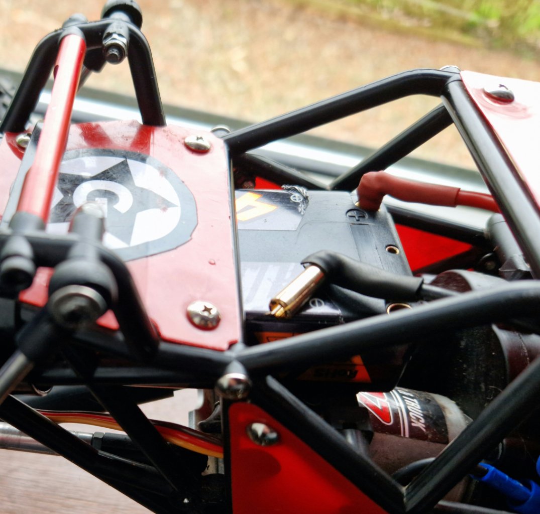

Battery mounted to the front

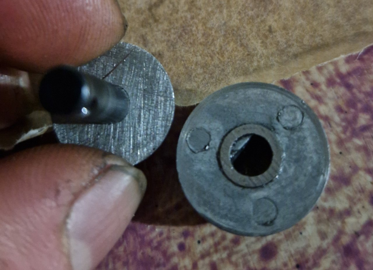

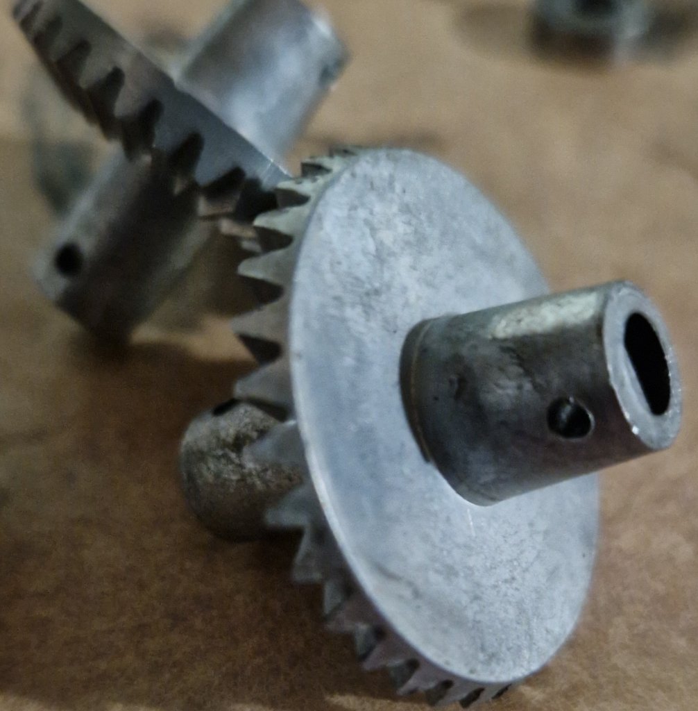

drilled and tapped the diff gears to lock the shafts inplace
Underdrive mod to rear diff

Yea, was going to do that as well but prefered the look of the battery still in the body / cage but still as far Forward as possible.
What I did was mount the receiver and esc at the rear and then flip the front Electronics mount upside down as it gave more clearance for the pack.
To insert the pack I slide it in through the front window towards the rear and then slide it forward to the front.
I use the CNHL 2S Packs (4900mah I think)
