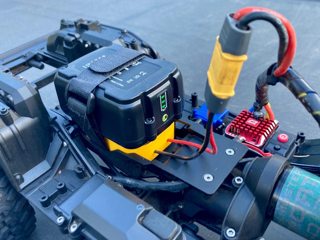

Drill battery 3S TRX4!
Shergar
Voltage is voltage regardless of chemistry it’s just the current you need to be careful about really.
As long as they aren’t getting hot then happy days.
Lithium based power tool batteries should have their own cutoff circuitry built in so as your knock off died and recharged then all good in theory.
Cool idea for some carefree crawling 👍🏻👍🏻
Im pretty sure the drill pack just has a number of 18650 cells and these cells can be very useful in a crawler, i have made a couple of packs from 16650 cells for crawlers and they do work really well, rated at 4200mah but i do use a low volts alarm with them
But job well done looks a good option
