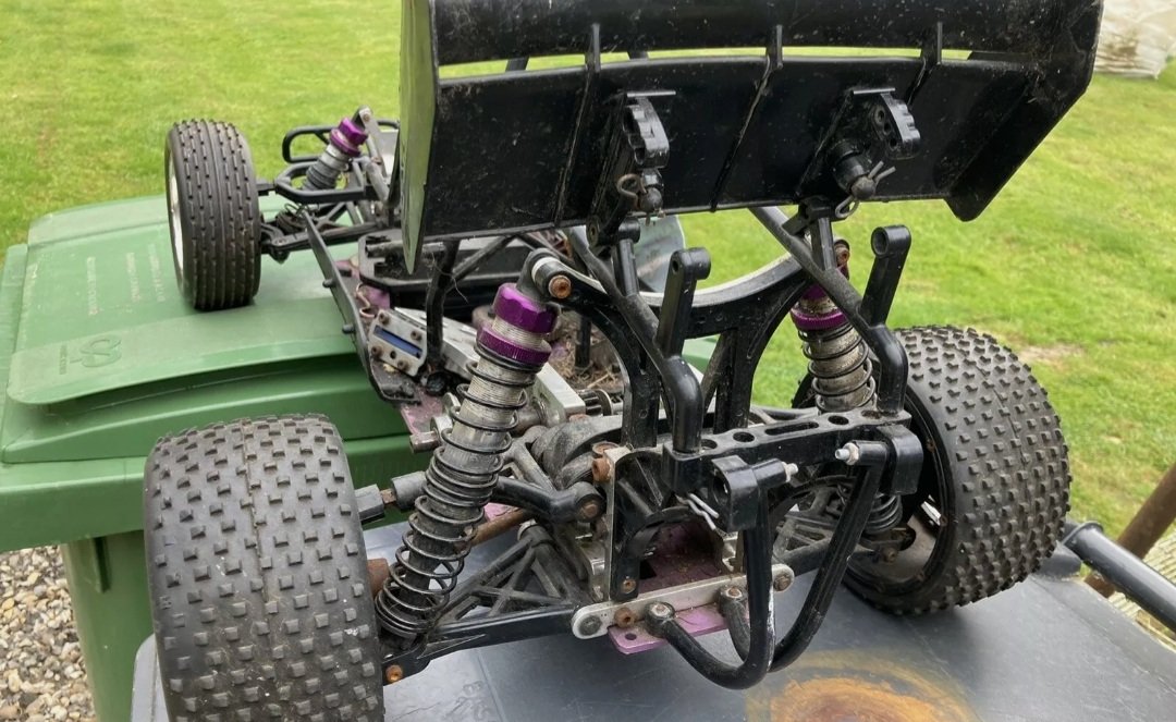

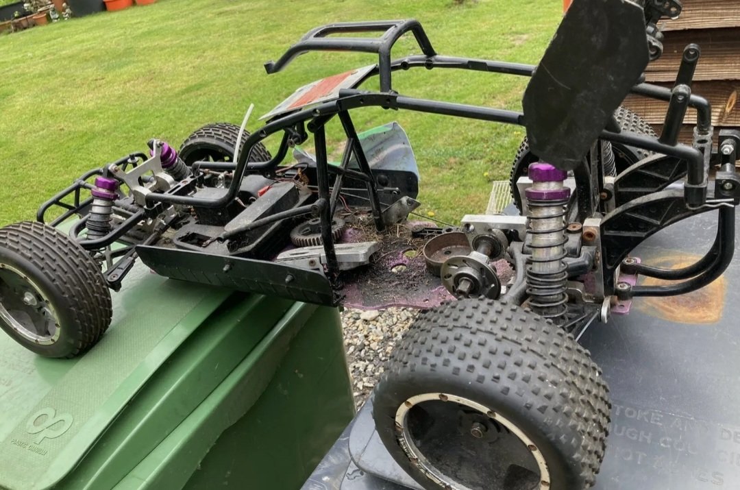

It is indeed what is left of an Aowei Yama buggy. Engine and clutch are missing, as is the shell. Whats left is pretty corroded and neglected.
I think the rest of the transmission is sitting on the chassis plate in amongst the dirt.

To be brutally honest.... this will probably cost more than it;s worth to get going.
Your shopping list will require:
Engine / carb and exhaust and airfilter.
Engine and carb is easy...any CY, Zenoah or copy will fit. The exhaust won;t be quite as easy as it will probably be possible to fit a beantin square pipe....but not a tuned one. I cannot see if you have all the engine mounts present, but I suspect you don;t.
Clutch / transmission/brake

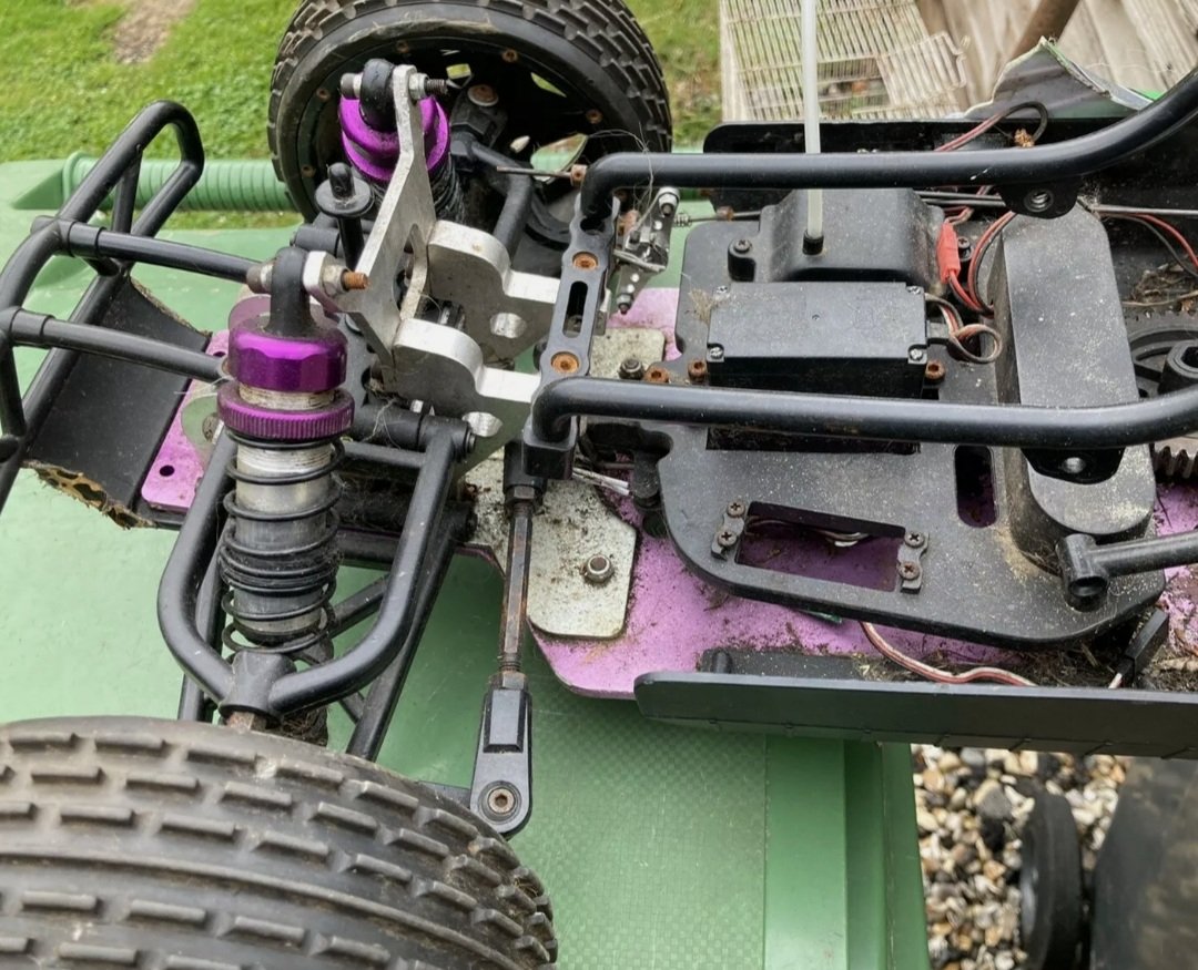

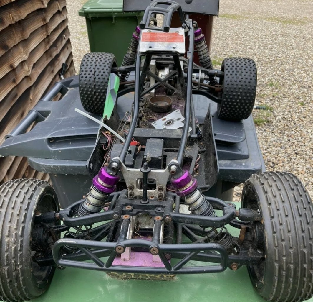

The clutch bell is there, but it;s broken. You have one of the gears to connect the engine and diff ...but the clutch bell shaft would have the other, and it's not there. Also missing is the brake assembly ( you have the disc) and the clutch support main part is there, but not all of it.
You have no fuel tank or pipes, and no throttle/brake servo. The control rods are there, but the servo has been smashed. Rear drive is heavily corroded, but should clean up. No idea if the diff is functional unless you open it up.
So....say £100 to get a decent used motor with carb, exhaust and clutch. Another £50 to get the clutch assmebly parts and gears. servo  and radio gear...another £50. Add in fuel tank and system plus whatever bearings, fixings and sundries and top it off with the £67 the project started with and you should be able to complete the project for around £300 total. Assuming you don;t need to spend much on the bits that look OK and you clean up and re-use the rusty driveshafts and shocks etc.
A brand new entry level KMN Baja clone can be had for £399
