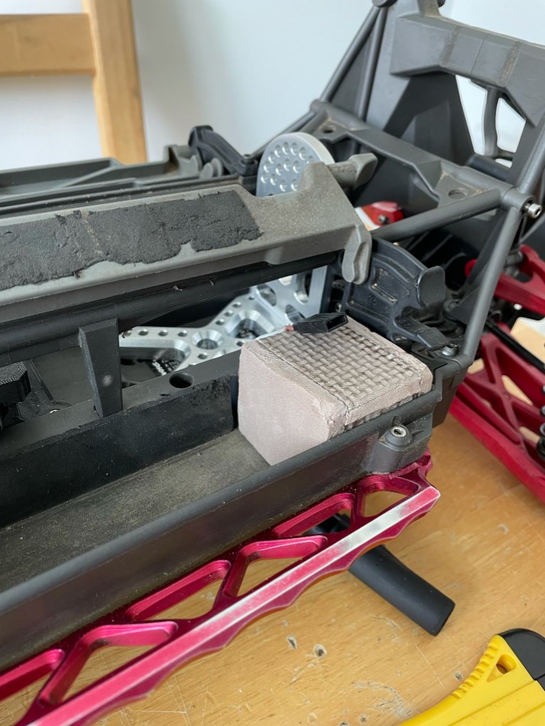

 I ran a B&M ESC Mount and B&M reciever box. The ESC mounts to the stock RX box cover and you get a mini 3D Printed RX box that fits underneath the ESC
