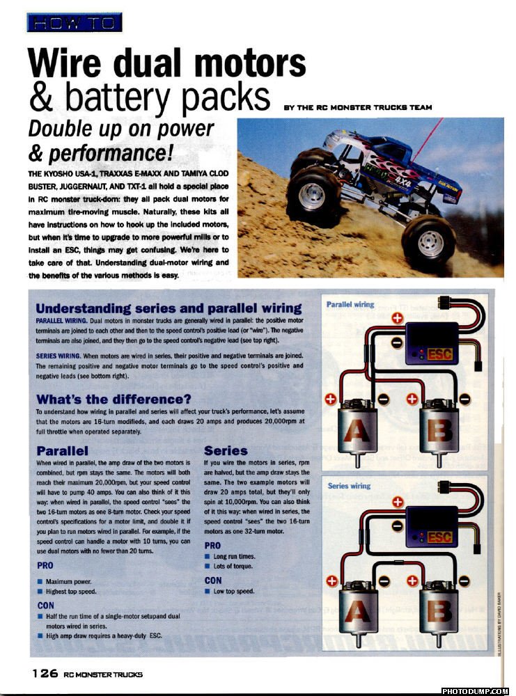

Dual motors dual ESC’s can I piggyback the battery power leads from one ESC to the other, or should I make a Y lead to the battery?
Should I reduce the ECS switches to one shared, or just use the two?

What ESC's are you using?
Not sure if you know, but you need to pull a red power wire from one of the receiver plugs of one the ESC's.
You can piggyback the battery leads. Just solder the battery wires from one esc to the battery wires to the other.
