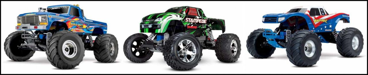

Unless you're sold on the hard body and the whole retro thing, I'd spend my money on something modern - For £179 you could get a Traxxas Rustler or a Stampede for another £20

Great reply, this is the kind of thing i wanted, if its bad its bad, maybe i will go for the traxxas bigfoot instead
