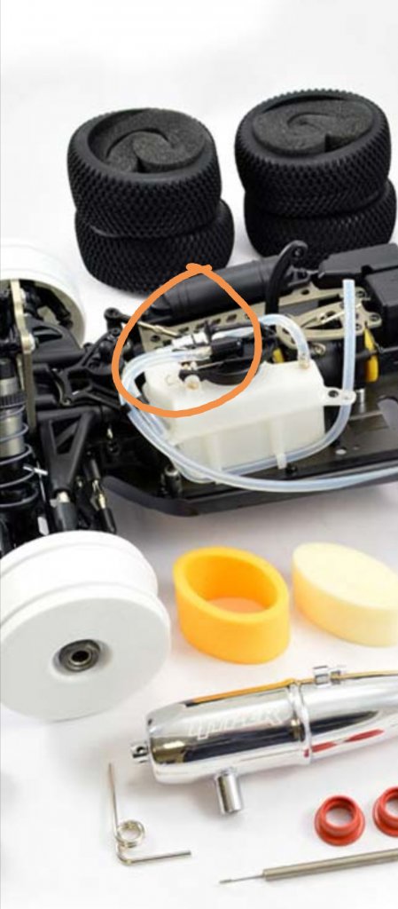

samp97 Posted April 18, 2020 Share Posted April 18, 2020 3 minutes ago, 1111 said: You should have a fuel filter from the tank to the engine. A line from the exhaust to the tank (pressure line) All the smoke indicates is that your burning the fuel right. Looks to have a fuel filter in the image, I've circled it, it seems to match the online images too. I thought the nitro burnt clean, the oil additive is what creates the smoke? I'm not challenging your answer it just seems conflicting to everything else you read online, what's the best way to tell if its getting enough lube or not? Quote Link to comment Share on other sites More sharing options...

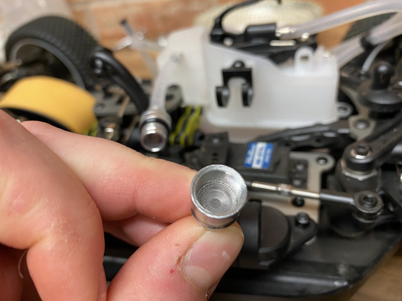

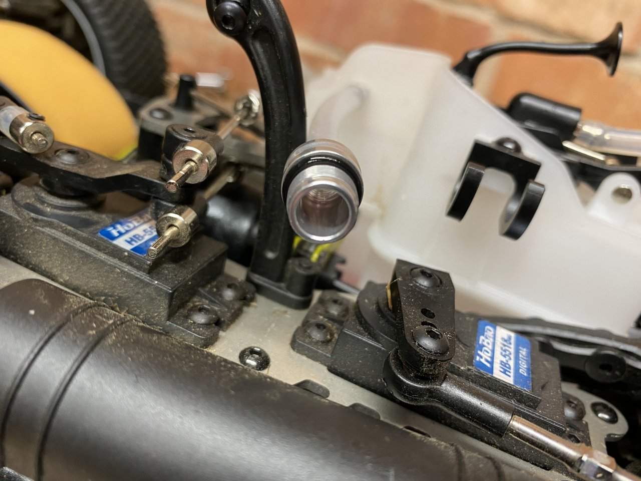

samp97 Posted April 18, 2020 Share Posted April 18, 2020 7 minutes ago, 1111 said: Get a close up? I don't see it. If you have one then check it and make sure it's clean. check the carb too. The broken rod is from not enough oil lube. I don't know what kind of oil you put in the engine too start? Only use after run oil. Circled again Quote Link to comment Share on other sites More sharing options...
Joshua223 Posted April 18, 2020 Author Share Posted April 18, 2020 Hope this helps. I checked and there were no bubbles before or after the fuel filter either. Quote Link to comment Share on other sites More sharing options...

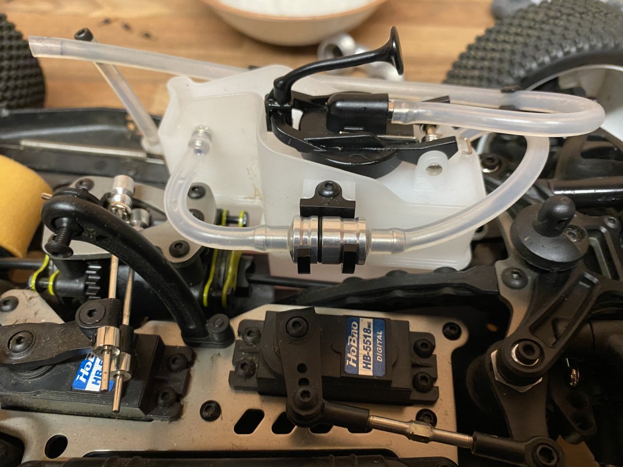

Joshua223 Posted April 18, 2020 Author Share Posted April 18, 2020 If, by chance, the fuel line between the carb and the fuel tank ran a little too close to the exhaust, could that theoretically affect anything? All fuel lines were replaced and done one at a time to ensure that they all went in the same place, same length and same routing but I could swap the exhaust line and the fuel line routing over so that the fuel line isn’t running alongside the exhaust. Quote Link to comment Share on other sites More sharing options...
samp97 Posted April 19, 2020 Share Posted April 19, 2020 2 hours ago, 1111 said: As long as there is no leak you're fine. The length of the lines are not that critical. I prefer the fuel line a little long in case you flip over you have some time to flip it back upright again. If you swap the lines you won't get the engine to start. I think what he means is swap the routing of the lines to move them away from the exhaust. I'm pretty sure the issue is just a manufacturing defect 🤔 Quote Link to comment Share on other sites More sharing options...
