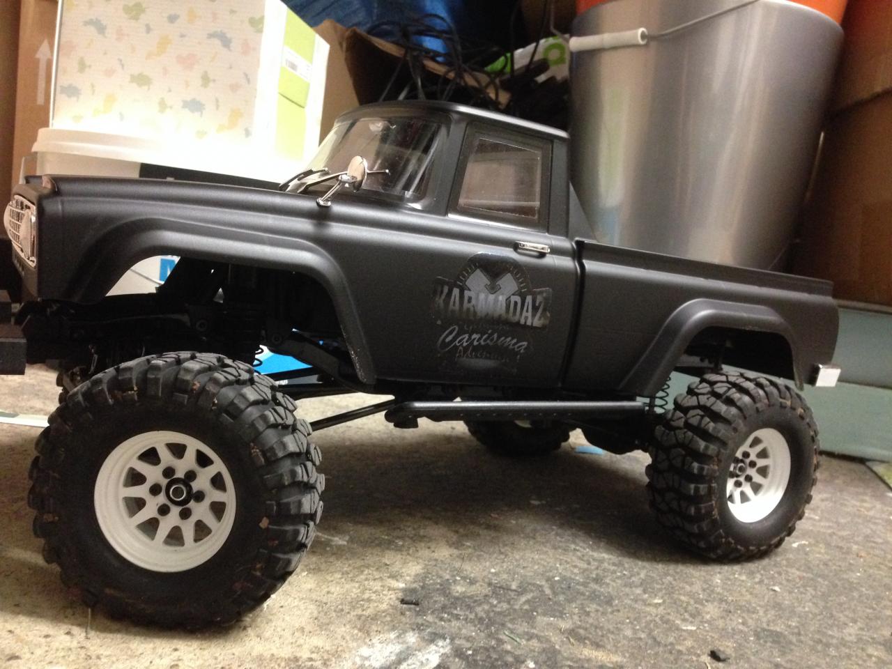

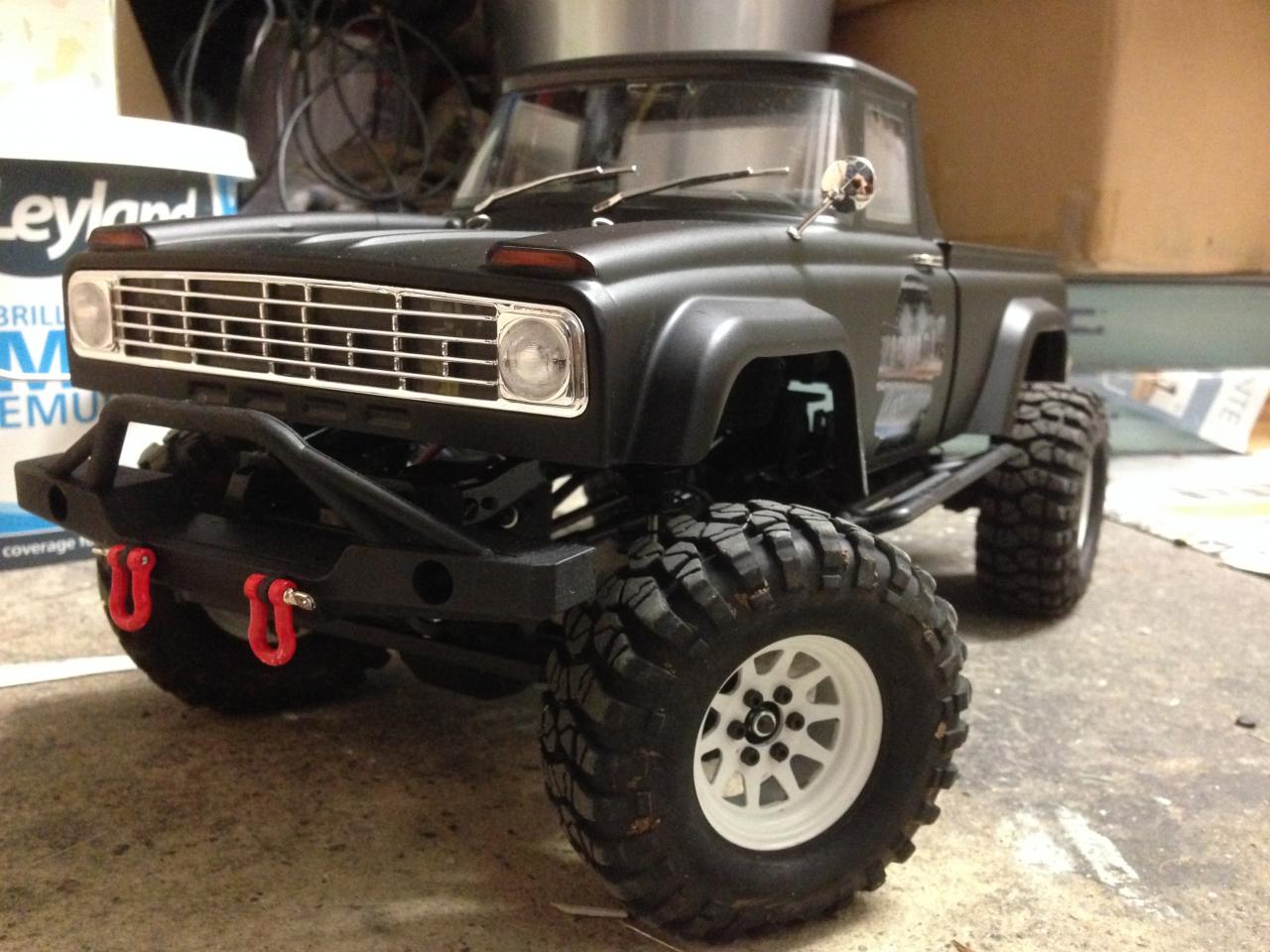

Already started fiddling with mine! Fitted my own radio gear and borrowed the metal wheels from another truck (not too keen on the white) and fitted some shackles.
Roll on the weekend to hit the trails!!IMG_6752.thumb.JPG.8ce92a038a415e2230adcff8ba60b01d.JPGIMG_6753.thumb.JPG.a5ac4a1afdd2248ce709e00c03519670.JPG

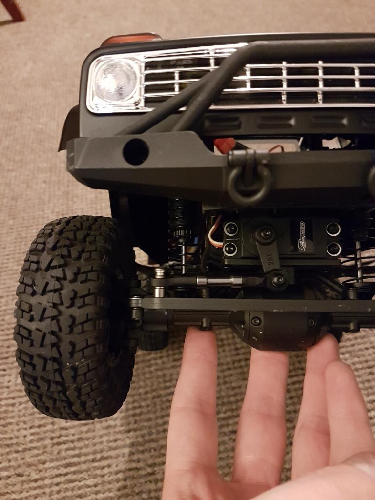

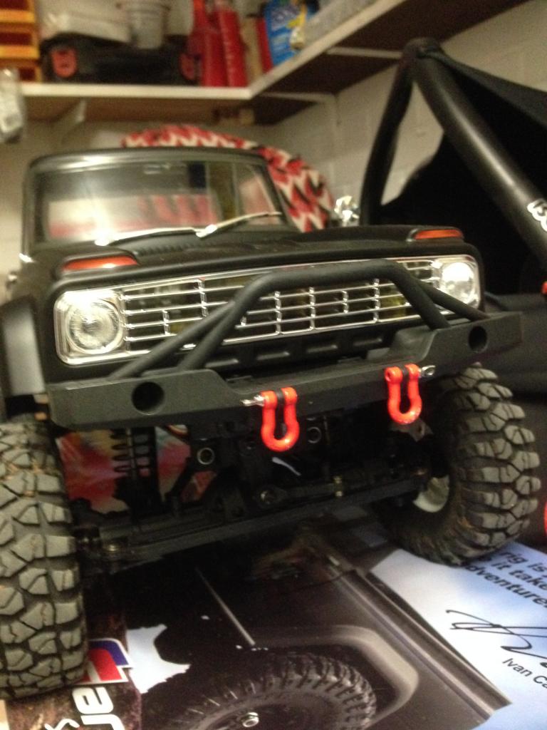

Had a fiddle with the front bumper on mine last night.
I felt there was too much of a gap between the top of the bumper and the section below the chrome grille. So flipped the bumper mount to raise it up a touch.
I also popped off the front and rear diff covers and found very little grease in there, so popped in some marine grease. IMG_6765.thumb.JPG.e7228a19e7eab40721621f69367003ce.JPG

Looking good. The red shackles look awesome. What i did with my bumer is to just remove the lowering bracket and pop it straight in the cross brace

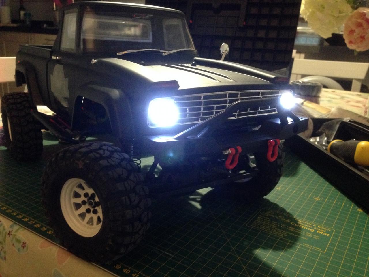

A little blob of black paint, or black Plastidip on the back of the light housings will get rid of all the glare underneath the shell and will focus more light outwards for you chaps using the light kits :good:
Thanks for the info mate. Will give that a try :good:
1 hour ago, Wabom1981 said:

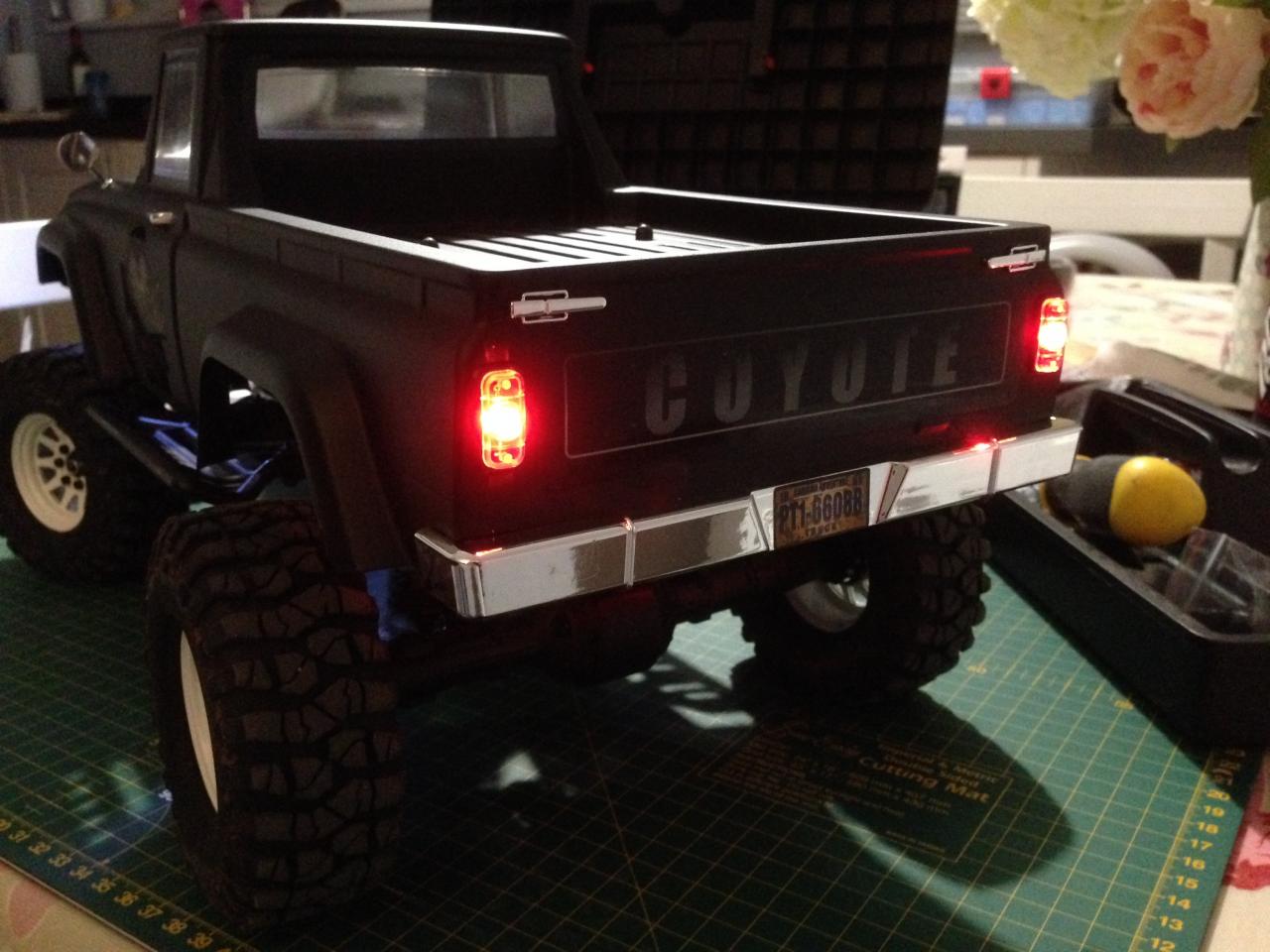

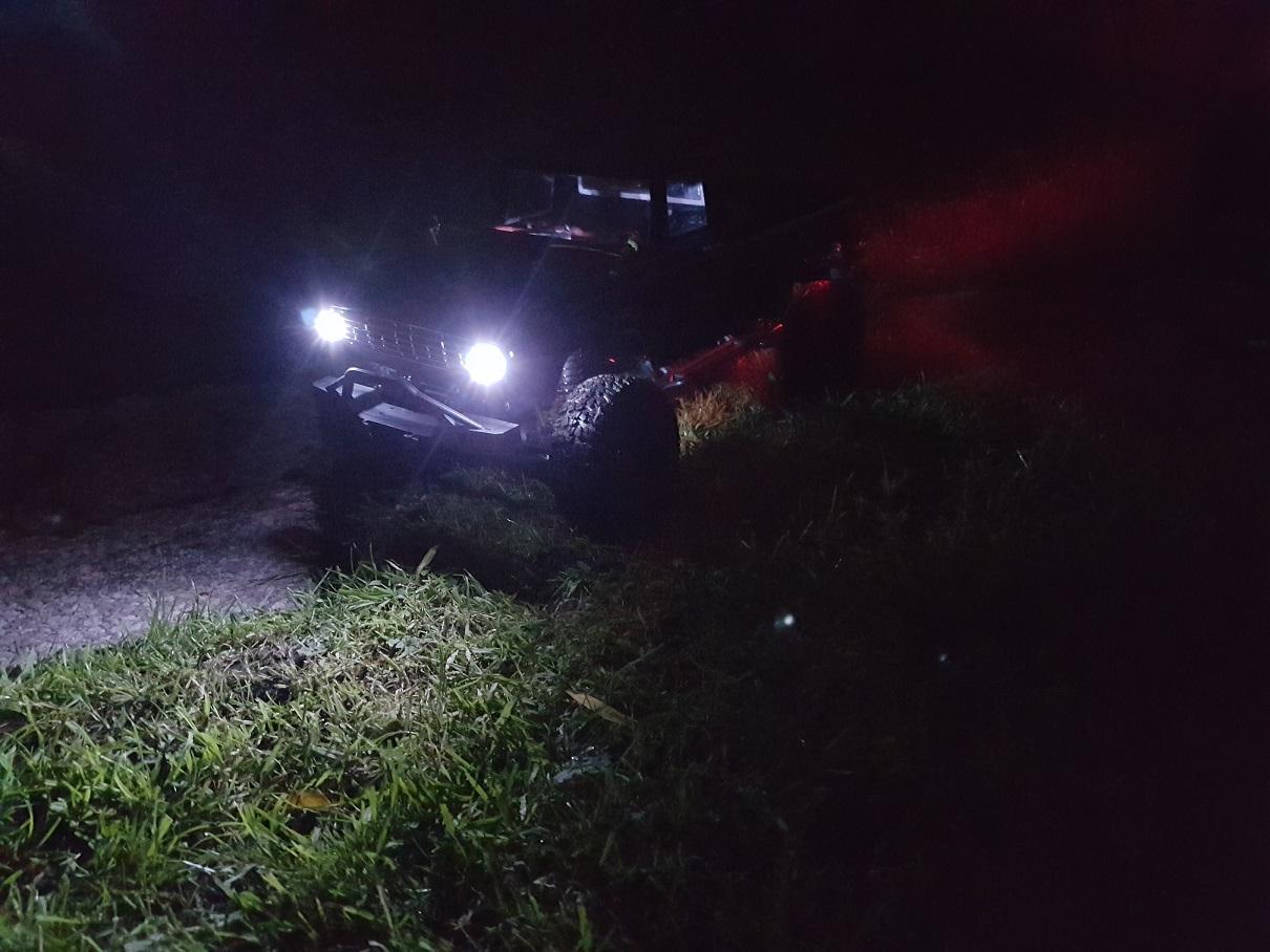

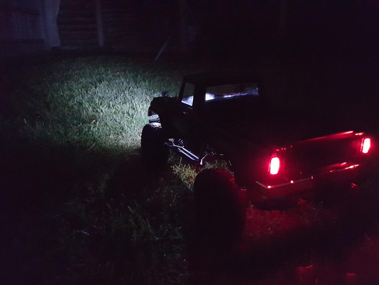

So I followed suit and got myself some lights fitted!!
Also applied some black paint over the back of the LEDs and the light buckets! Thanks for the tip @Oh How OriginalIMG_6771.thumb.JPG.b3ed77ea32a836db3377ffccd3a7cbe5.JPGIMG_6772.thumb.JPG.ba0a73c2705e31cac2f9e72fd17542b6.JPGIMG_6776.thumb.JPG.9e5f5e8a77135d673e7b6aa32a3cfe4f.JPG
Little tips and tricks you pick up along the way, it made a world of difference on my Trailfinder 2 :)
You're never likely to block it out completely, but every little helps.
