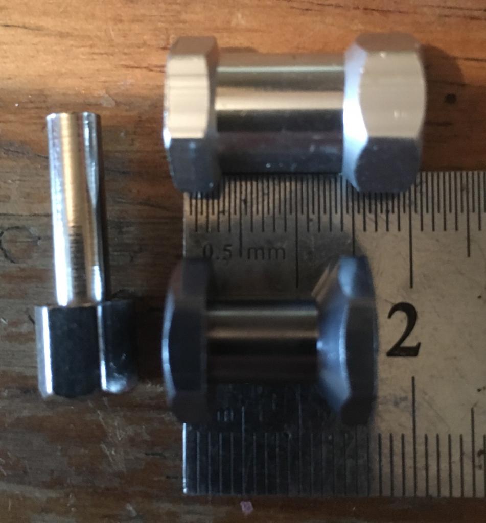

For those looking to extend the track of their Outback, rather than having to spend more money on wider driveshafts to go along with the FTX wide axle extenders, all you'll need is these above.. they screw directly to the existing stub axles.
surprise surprise the link doesn't work again... I'm using the eBay ap on my phone so that's possibly why?!
Search for "12mm Extension Hub Hex Wheels Alloy Adapter" and you should see them. They're £4.99 for a set.

Umm. I have a set of those bought for a different application.
But on checking they are actually narrower than the extenders fitted originally to the FTX, so will actually make the track narrower as you have to remove the original items to fit them.
Or am I missing something?? Perhaps I'm finding the wrong item on Ebay?

I was wondering this....?! I'm away working so can't measure the stock stub hex's. These are 20mm, as you say they could be less than stock. I bought the FTX wider hex's for mine some time ago, forgotten what size they are now but it gave an extra 5mm track either side. Wondering if these are somewhere in that region?!
Just had another look and there are 25 and 30mm kits available too!
edit: just picked a set of black 25mm extension pieces, should go well with the deeper dish wheels I'll be fitting to his Tundra.
Edited by t2boats
Been sorting out my sons Tundra this morning, discovered the original set of extension pieces I bought, then thinking they were the same size so possibly a pointless purchase, infact are 5mm longer than the stock extensions. So it's worked out well in the end. Still waiting for the 25mm pieces to arrive but will stick with these for his Tundra now as it's also having deep dish steel wheels same as mine. Will post up a pic later on when finished.

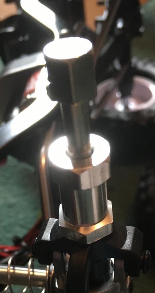

Quick update - just noticed the extension pieces can't be fitted on the model, unless I modify the following. Shame it involves a bit of work..
The centre hole in the wheels need to be drilled out to suit the diameter of the new wheel bolt. (5mm)
I can fit the new extension piece on but the new wheel bolt only goes down so far as it runs out of thread on the stock stub axle. The only way around it is to cut down the bolt making it shorter. I'll have to see if it's thread goes all the up it's inside first..
Edit - yep, the thread goes all the way down inside, so it can be trimmed.
