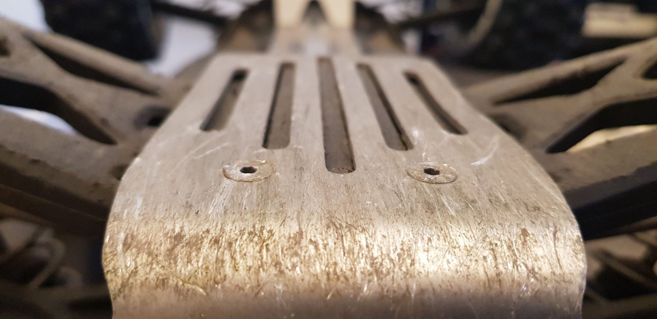

Not sure how SS can look cheap 😄 You can see the state of mine in the pic - would have shredded quite a few plastic plates, but this still holds - some times have to remove it and hammer it back to shape, but its strong and is not heavy. I didnt use side covers and i think (looking at the damage on the SS) can also remove the center piece.

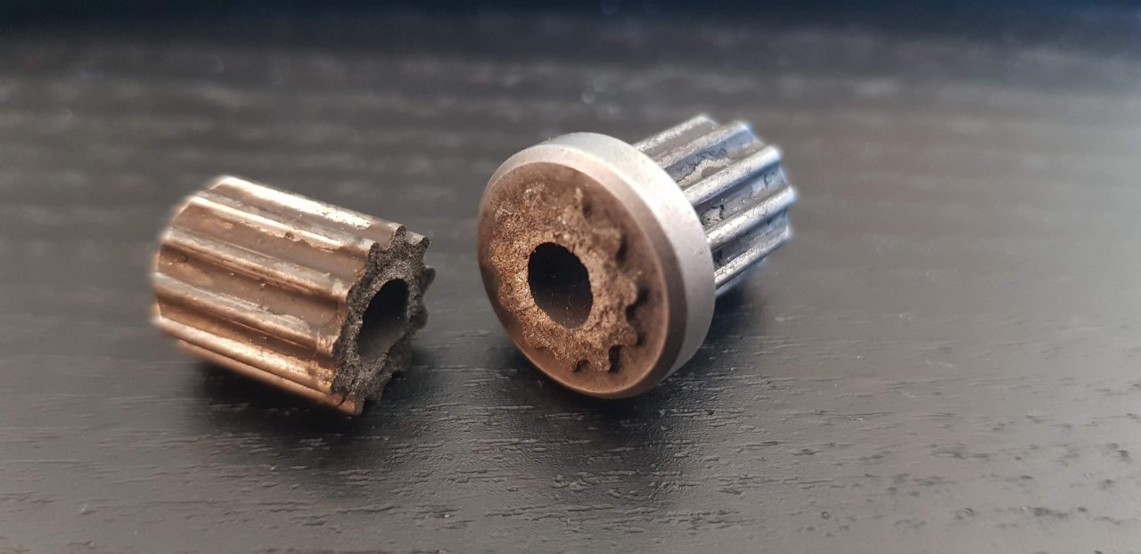

During light bashing today i noticed that my front wheels do not have any power. Upon some (a lot) disassembly i have found the problem:20220415_121944.thumb.jpg.30f2415ae9b9e9781c23fd84862fd948.jpg
Not sure why would this break.... Front wheels don't get abused as much as rear ones.... Anyway - now I have a question - can I buy this part separately? Part number for this in traxxas manuals are for driveshaft... Maybe there are some non traxxas upgrades that would be better?
