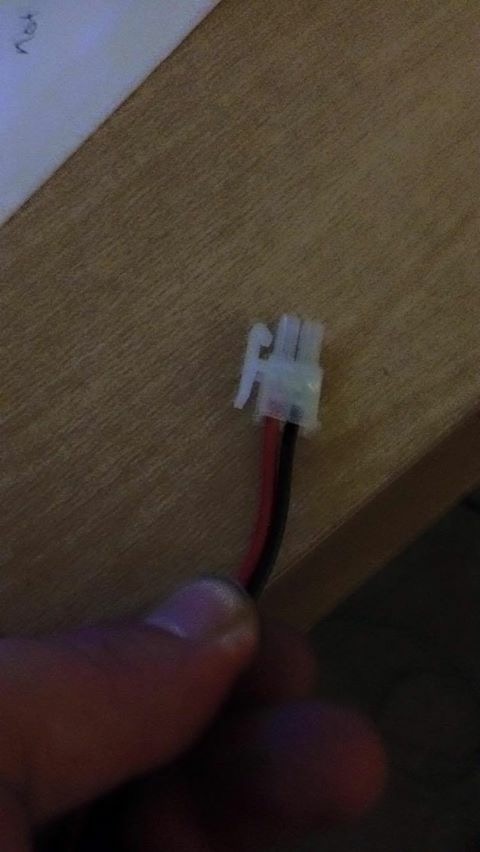

8 minutes ago, ashleysmith said:
Can someone tell me what this connectors called please
A detailed pic of the end would help, as the plugs can be weird shapes, but at a guess it looks like part of a PCI-E power cable, or even part of an ATX cable.
Check this out.
http://www.playtool.com/pages/psuconnectors/connectors.html
[Edit] Or is it a Tamiya power cable...... ? But the clip looks like its on the wrong edge.
Check this out.
