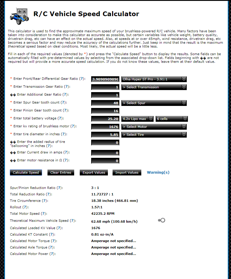

Ran it on the 1700KV again for a while. managed to get a 58mph speed run broke wing mount and rear arm at the skate park

Yes its actually quite stupid the amount of power it has.  I was running my sct410.3 after this which i had just changed the pinion up 4 teeth from 14t to 18t and it felt slow and weak after driving this. Its a shame all the older pictures on the thread aren't loading any more.
