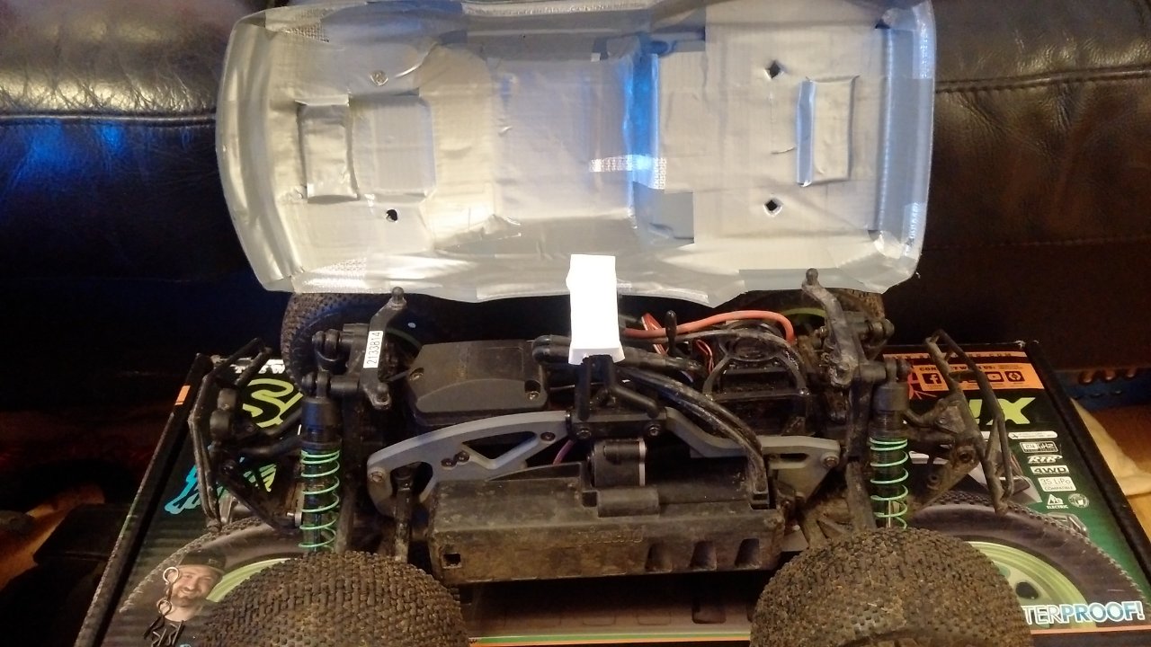

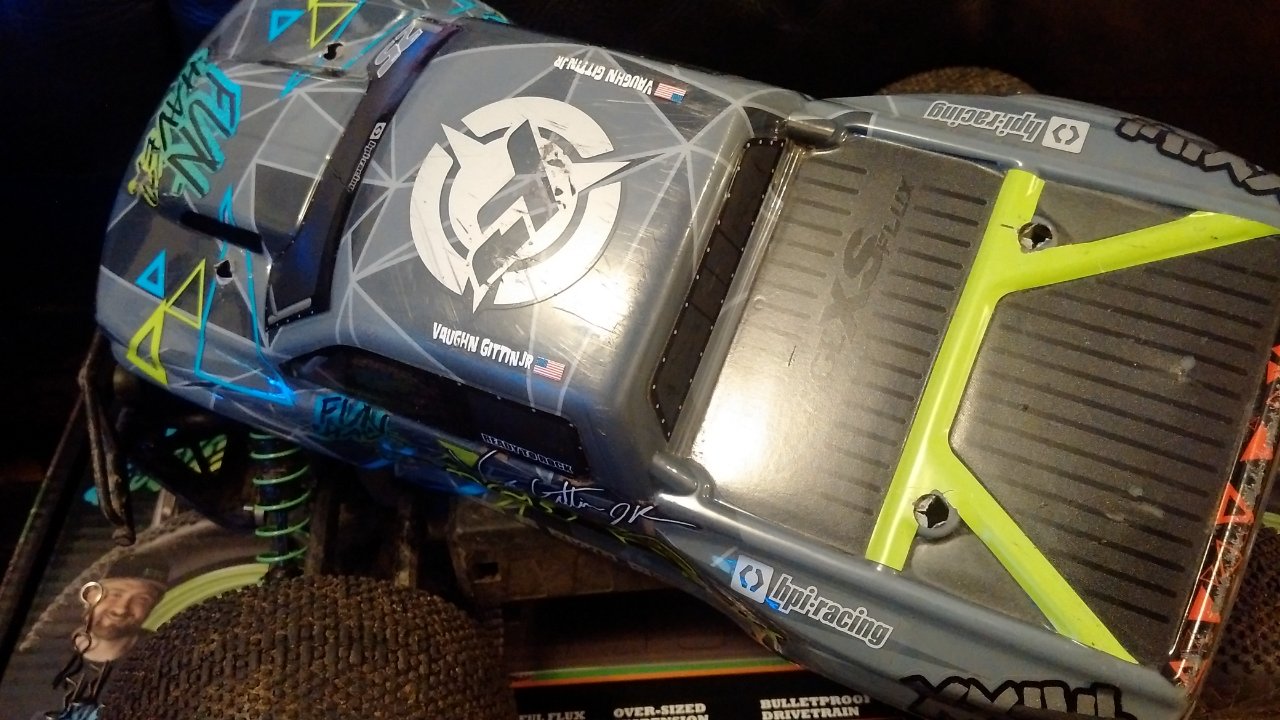

Got this mostly for the lad to save the outlaw spares but really having too much fun with it myself on 3s really wrecked the body, so backed it with tape and added some foam to stop the shock towers pushing through.
Body is very tough anyway one of the best shells ive come across. Doesnt crack but will bend and buckle.
