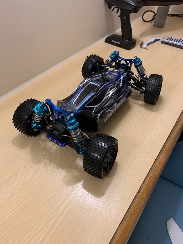

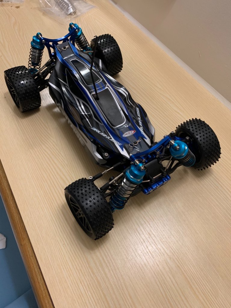

Those wheels were a little Extreem for my little buggy! Although have gone a bit mad this week on buying shiny aluminium parts, I also got some big bore shocks as I have continued to be underwhelmed by the stock shocks, slight tweaks needed to get them to fit and the buggy is now sitting higher which might effect its cornering but I am hoping it will handle landing jumps much better, will see how it goes if the weather is ok tomorrow 2DFFAD05-95B0-4791-A806-F5A18F944136.thumb.jpeg.23c6b97958eb3222b6d9b7df19edf02f.jpeg90A51DDA-B627-4ED1-BF76-7436B7C2831C.thumb.jpeg.3fe495cca1c64d2c823fc715600cc19b.jpeg
18 hours ago, Vanden Plas said:
Hmmm, big bore shocks didn’t work out so well, the constricted the turning so it was pretty undrivable! Never mind was worth a try
Isn’t there another mounting hole on the swing arm?
Maybe if you mounted them slightly more vertically they’d clear the steering?
