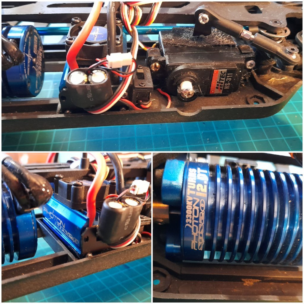

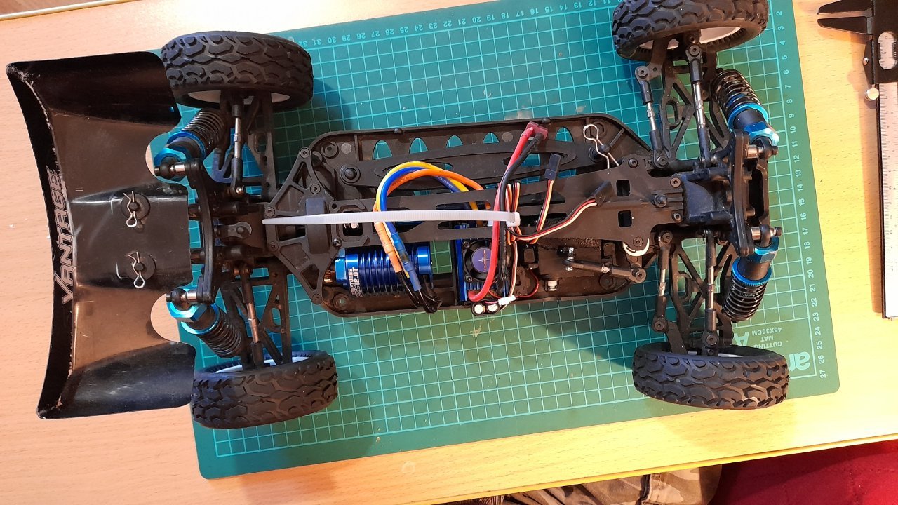

Recently bought a brushless Vantage on ebay (£63 Inc postage, with no transmitter, receiver, battery or charger) and have not had a chance to look it over until now. I was hoping to double check the motor, esc and servo are correct as they look different to the images I've seen on line. The esc I couldn't find much info on at all.
It seems to have Schumacher wheels (rear branded but not front) with proline dirt hawg tyres all round, which I assume are better than
the originals?? (Apologies for the inadvertent middle finger 😂)
 I don't have a part list as I don't have the manual if anyone could point me to a cheap copy of that it would also be appreciated
Obviously I bought the car as a project so have realistic expectations but just making a list of things I might need to double check as this is my first Brushless RC and will be my first experience with lipos (once I buy some lol)
Ordered the dumborc x6 from banggood which I guess should be compatible.
Any general advice on what to check would definitely be welcome.
Servo don't look standard buddy, also the motor and ESC look like the older version, would try and Google it and make sure it's lipo safe, as for manuals I'm sure on the ftx website u can find one on there, looks a cracking little buy tho especially for peanuts, and those tires should grip a bit better than the standard too, I'm running the Dumbo x6 transmitter and X6FG receiver on my carnage and it's excellent although I would advise to order a foam ring off eBay for the wheel as the plastic feels a bit naff lol and if it is lipo safe should be an animal on 3s
Cheers mate,  will do some more Google digging. I thought the servo may have been changed as normally the FTX servos seem to be Etronix to match the motor and esc.
The esc is confusing as the twin resistors/capacitors(?) sticking out the side actually overhang the chassis slighty and stick up high enough to stop the body from sitting properly.

@Ratty McRaticusOh, and if that’s a non standard servo, check it isn’t fouling the drive shaft. Stock servo is slightly shorter than some, I replaced mine and the new one was 1.5mm bigger. It barely brushed the drive shaft but I guess at high speed, these forces are magnified.
Took me ages to figure out why everything was overheating and going slow. Packed the servo mount with washers and it’s been fine ever since.
Its most definately a non standard servo, unless FTX were giving out Hitec servos at some point... Hitec make really nice servos, the one you have is one of the more humble offerings, but one that will likely be able to meet its specs rather than offering you specs plucked out of thin air and stamping it with 25kg...
https://www.robotshop.com/uk/hitec-hs-311-servo-motor.html
Speaking generally, some ESCs won't list lipo support and its usually due to them not having the right LVC for Lipos, e.g. some Tamiya's have a LVC of approx 4.9v which for a 2S lipo is a huge no no. There's an easy work around, which is a 50p volt meter, or probably the better option, one of those converters that have a lipo alarm/buzzer built in.
