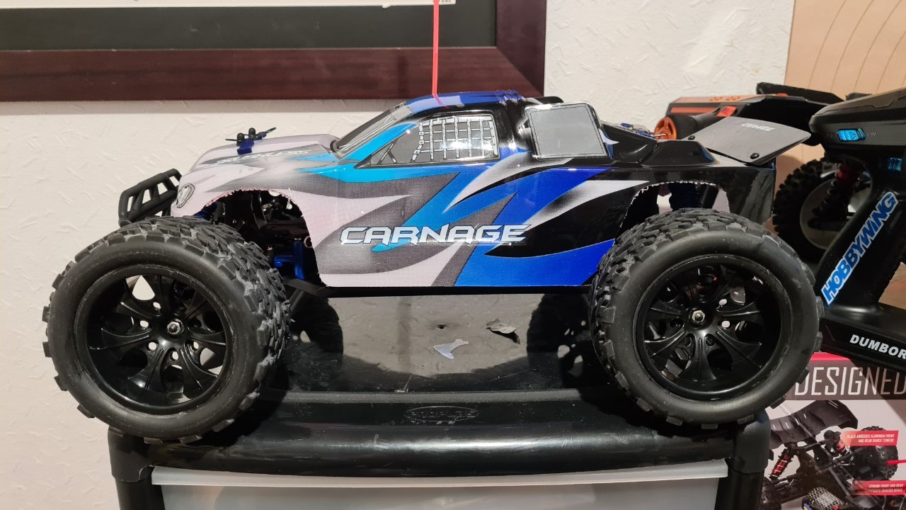

Hi guys,
Anyone help with my daughters converted Carnage? (Was a Vantage) full Carnage conversion.
Slipper keeps slipping.
Replaced spur, slipper pads, tightened slipper fully tight and still slipping.
Running standard tooth spur, 17t pinion, 2s, 10.5t speed passion brushless motor and a hobbywing 10bl120.
Any ideas guys?
It doesn't even seem particularly fast either. Full speed seems to vary too. Full chat seems slow one minute then seems st speed up and vice versa.
ESC is calibrated as it should be as far as I'm aware. Batteries are allegedly 80c 5200mah Goldbatt off Amazon. Maybe they are a bit crap. But obviously that won't cause the slipper issue.
As for as I can see its pretty much as FTX intended apart from a slightly more powerful motor.
There must be something wrong somewhere for brand new slippers to slip immediately.
Please help.
Thanks guys.

Are u still running standard nylon spur gear? Gona sound stupid but u have fitted the slipper pads correctly? I get slip on my 3s battery running standard etronix motor an ESC, but iv got round that by jus doin the slipper nut up as much as possible, did do the 1/4 turn off but still slipped so jus done it up as tight as possible an not had a problem since
Yep, did have the acetal one but first time it started slipping it seemed to wear the spur so much that it would go tight no matter how tight I did up the nut I could still turn it by hand.
So I put the standard spur back in.
Are the pads handed? Is there a right and a wrong way to put them in?
Thanks.

So long as they sit in the spur gear properly u shouldn't be havin that problem, I upgraded to the RW hardened steel spur an pinion as I stripped the nylon one on second run out lol havnt had any problems with it since, the gears are meshed correctly?

Yeah, gears are meshed beautifully.  Runs quiet.
I did put a little grease on the teeth (nowhere near the slipper).
The wheels & tyres are a bit heavy especially as I lined the tyres with duct tape to help stop ballooning. Could that cause the problem? They maybe a bit bigger than standard? Do they look the same size?

It could be the bigger wheels with he tape inside, but could also be the greese on the gears, even a tiny amount on the pads will cause slip, nice wheels tho 👍 what ones are they? Wouldn't mind some for mine
