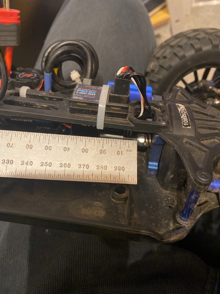

I took a measurement before dismantling the first time. The distance between the m4 nut and slipper drive cup was approx 8mm as factory fitted.
I did measure mine at 13mm before i took it apart and set it back to that but didn't run it with the standard spur on it so didn't know if it would be any different. I have adjusted it to 7mm now though and seems to be catching better so i'll try it out tomorrow 👍

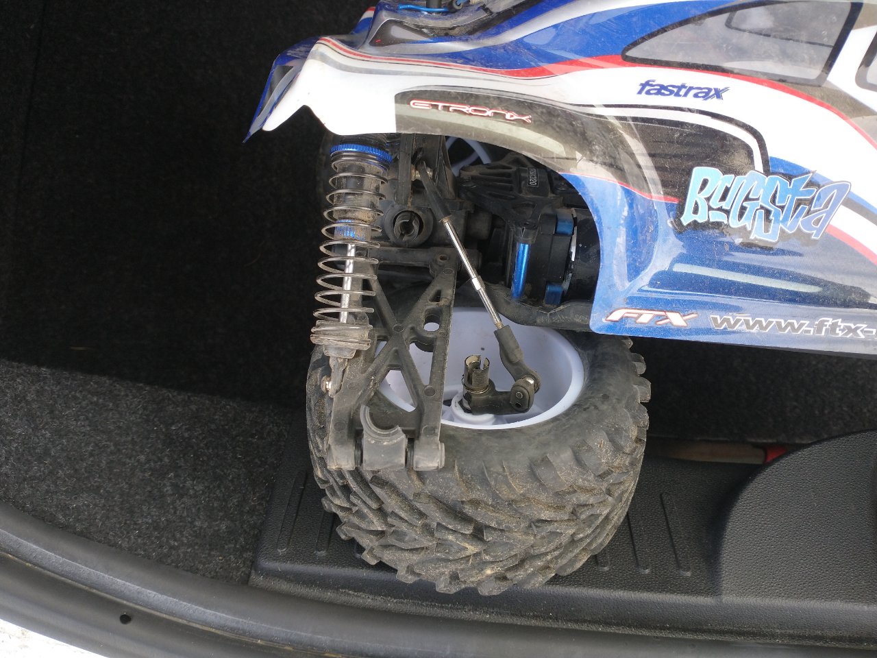

Well we lasted all of 5 minutes today
Ouch. Did you lose the dogbone? If you need to replace, get a set of the front CVD,s to stop it happening again
6 minutes ago, Scottyb said:
Do the cvd's fit the rear then? i just ordered some alloy hubs off rcgeeks, luckliy the dogbone popped out and wedged itself in the chassis
That’s exactly what I did. Since replacing a few bits with alloy, the cars great!
yeah, they fit both ends. Makes me wonder why they don’t just use the CVD as standard each end 🤷🏼‍♂️
Yea it's a bit stupid they didn't, i think i'll just replace anything that breaks with ally, it's relatively cheap bar the front hub parts.
Bit peeved though about the crap quality of the plastic, it only jumped about a foot in the air and it landed flat with no slap and it just snapped 🤬
A bit of superglue and no jumps til the postie arrives 🤣
